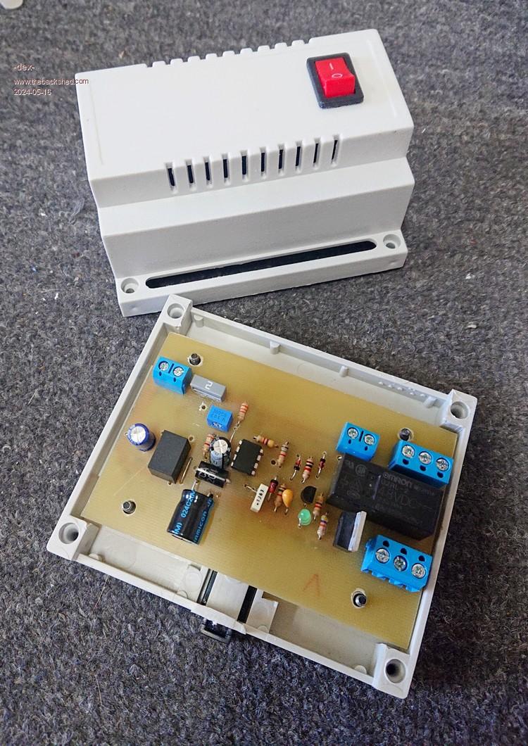

I tested another MPPT again, with the same diodes as before (I had nothing to do, waiting for new ones   ) and with set of small batteries. Up to about 1.5 kW everything was fine, then my wife turned on the dishwasher and the total consumption was about 2.5 kW. Then MPPT went BANG BANG - it got damaged, but unlike before, it made it even worse - only the mosfet is shorted. This means full voltage from the  pv panels on the bus bars - ~100V. Good thing I was nearby and managed to disconnect the batteries, because they were already starting to bubble.

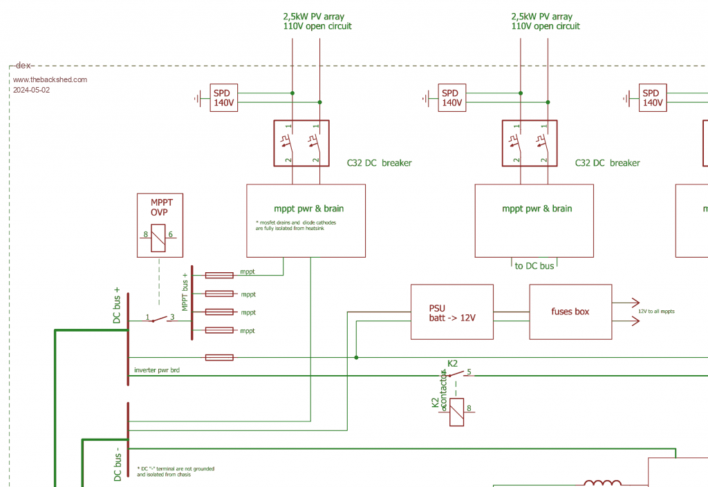

I see a pressing need for another layer of protection - against too high voltage from a shorted MPPT. Need to protect it when LifePo4 nominally ~51V receives 100V and is charged with an uncontrolled current and the voltage increases. There would have to be a circuit that measures the voltage on the bus bar and, for example, above 65V it disconnects additional the serial relay
The lifepo4 battery has a BMS from JK model 200A, but it will not survive when it sees 100V DC at the input, the inverter may also be damaged. It would be best to disconnect the PV inputs, but a good gas-sheathed DC relays (4 pcs for mine) are expensive. So perhaps a good solution would be to disconnect the entire MPPT group. I just don't know what in situation where one MPPT fails, and send high voltage to rest MPPTs outputs  Maybe we should also disconnect 12V from them, when one mppt fails.

Posts: 3421
Posted: 08:52am 02 May 2024
If this is going to be a rare event perhaps simple crowbar protection will do.
A suitably rated fuse at each MMPT output gets blown by a SCR triggered by over voltage at the output. To protect the SCR from the peak battery current a series resistor** that limits the current to 2 or 3 times the fuse rating should be in series with it.
** A suitable length of iron wire could be wound around a ceramic bar radiator element. After the fuse has blown it will be absorbing the current from the panels so it will get hot.
Eg if the resistor is 0.3Ω and the panels can produce 50A it will dissipate 750W.
The ceramic radiator elements are usually 1kW.

Wonder if the Kilovac Automotive Relay 12-900V High Voltage DC Contactor 500+ A carry, might work, one on each mppt output.
I've been using them on the inverter for a long time, have had no trouble breaking 600 A @52v many times, I know your voltage is higher, but might be worth a try as the cost had come way down from what they used to be.
That with Phil's suggestion of a beefy SCR and load as worst case scenario backup.
Just a thought.

I somehow missed your post of the circuit layout Posted: 06:18pm 02 May 2024.
The Kilovac or equivalent you show between the DC bus and MPPT bus is the way I think it should be done, everything I/we do is aimed at protecting the LiFePO4 banks, IMHO the MPPT regulators can look after themselves.
You have fuses on the MPPT outputs but I have breakers, some of my MPPT controllers are Auto voltage sensing, which is a pain, they need to be isolated from the Arrays to setup correctly, and supposedly need to be powered off after updating settings - I'm guessing as a precaution to ensure the installer actually set and saved the settings correctly. You look to have everything set up correctly and in a similar fashion to mine.

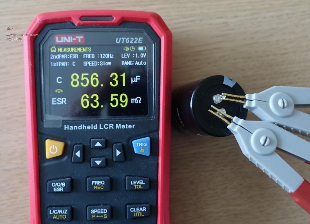

As for the inductor, I personally checked it in several calculators, which suggested a certain minimum inductance value.
For the capacitance value of the capacitors, I was not able to calculate it. I did what was advised here - "any reasonable capacity value will do" or use what you have on hand. My capacitors are several-year-old storage units, measured parameters in the photo.
Can anyone calculate what capacity value will be safe?

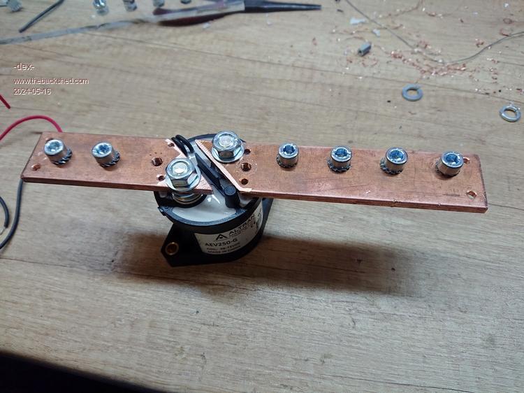

Lesson learned and implemented a contactor between solar and regulators. I recently ruined one with rewiring so I want to build some MOSFET switches. Allthoug contactors are more robust but use more energy. There will be some back emk when disconnecting the panels, this will probably less when disconnecting the mppt outputs, but then you need to use output caps rated for the input voltage.
In my mpppts all PV side & output side capacitors are 300V rated.
So if one mppt has a shorted mosfet, it sends ~100V to the outputs of the other mppts. While other mpts runs, get 100V at ther outputs, they are safe or not?
I also saw in your built that you used diodes in series to connect the MPPTs, in this situation should block the high voltage from reaching the other MPPTs.
Back to protector & kilovac
I used this kilovac in my inverter. I will use the same model in OVP protect circuit on the MPPT bus. The G version is available in digikey, 48V coil with economizer.

I made a circuit intended to protect everything in the event of MPPT failure and full voltage from the panels.
Circuit measures the voltage on the main bus, and if the voltage exceeds a set threshold for a moment, the circuit turns off the kilovac and remains in this state until it is reset.
I placed an additional relay on the PCB through which I supply 12V voltage to the MPPT systems. So when the kilovac is disconnected, all MPPT circuits are turned off.
I will use the second relay's pole for signaling - optical, sound, sending a notification or anything else.
Circuit consumes approximately 17mA thus ~1W + kilovac consumption.
I tested it and it works and latching perfectly. Treshold is in the range of ~52-65V setting by pottentiometr.
The last issue is to check whether there will be no random shutdowns caused by transients and voltage changes during system operation. Now, treshold time is approximately 0.5s. Adding a larger delay of several seconds to the system is a bit troublesome
ovp_mppt.pdf
Edited 2024-05-16 23:17 by -dex-
