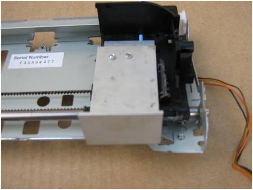

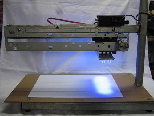

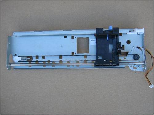

To follow on from a topic started in another thread, This is what i have used to make a uv led scanner for making printed circuit boards.
I know there is a few other ways shown on the forum here that used a converted flatbed scanner etc.

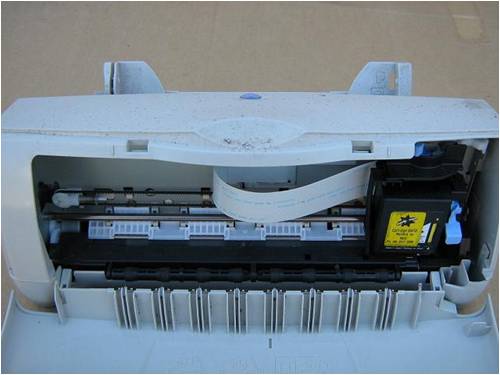

When i came to build mine the junk pile yeilded a old epson c61 bubblejet printer that was used as it was there.
I have since built several more from various other printers.( Mainly Canon )

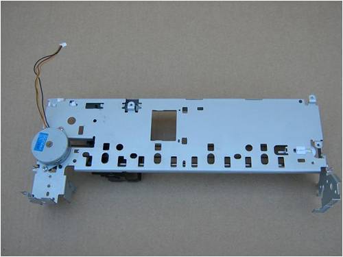

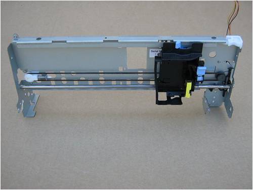

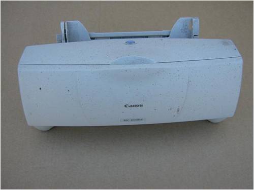

A discarded Canon BJC 1000SP was gutted below in the photos to show the basic bits required to construct a scanner from.

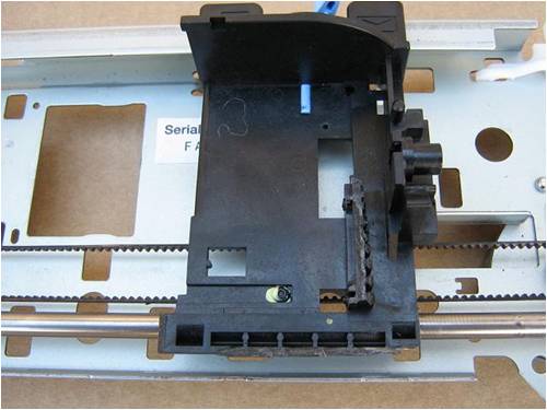

There is about 6 screws to remove the disassemble a printer to the bare bones carriage mechanisim needed.

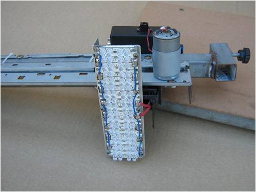

The epson is a better choice as the carriage is slightly longer and it uses a dc motor compared to a stepper motor as used in most printers.
Any will work but setting up the driver circuit for a stepper is a little harder than the dc motor.

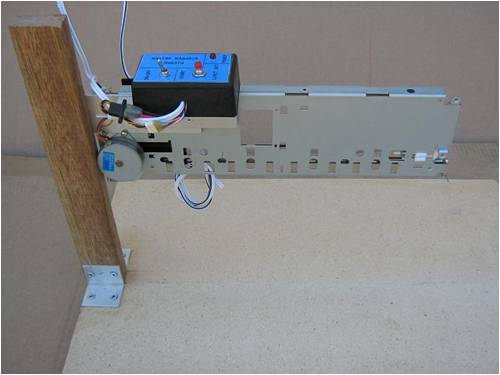

The one i built is nothing to pretty but works well and has given consistant results and trouble free operation.
When time permits i will tidy the circuit board artwork up for the dc motor and the stepper motor as well and post that to should anyone else wish to copy it.
Pete.

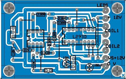

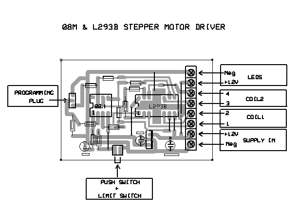

I now need to put a schematic together and redo the circuit board artwork to use a 08m instead of a 18x.

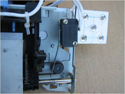

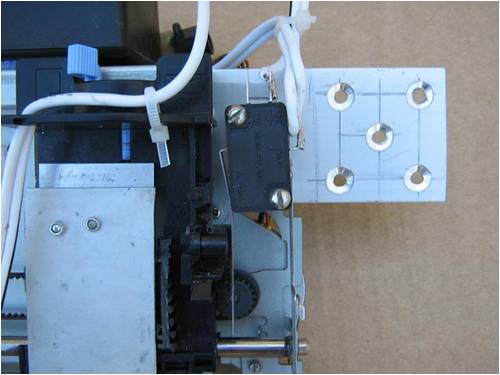

I used a reed switch attached to the moving carriage for a travel limit so i could slide a bar magnet along the support frame and set the max distance travelled, as when doing a small board it takes a lot of time to scan a distance where there is no pcb to expose.
Its just a matter of time to complete the scanning process. As you start the process then walk away and come back when its finished, no need to sit and watch.

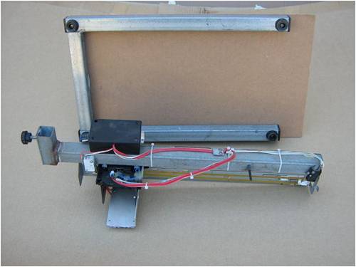

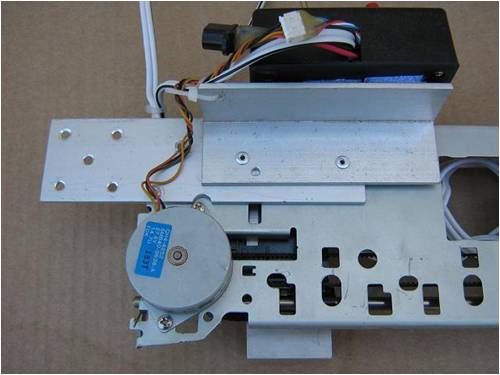

I will take some photos tomorrow of setting up the travelling carriage (old printer head) to mount the uv leds from.
Im halfway through the pcb artwork for the 08m and L293 motor driver board.
Guess i better make one to check if its all correct before posting the circuit.

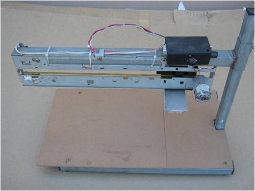

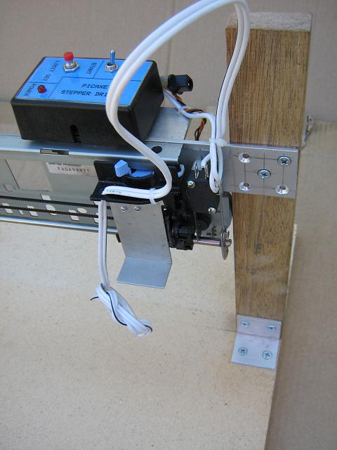

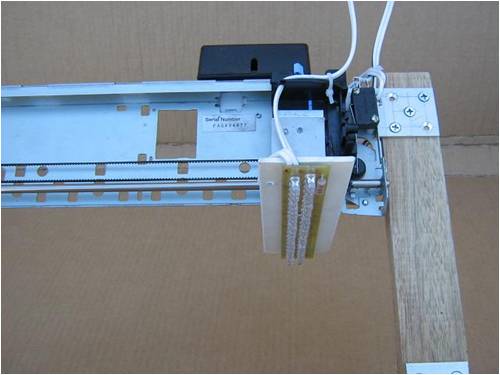

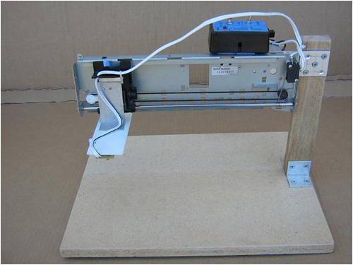

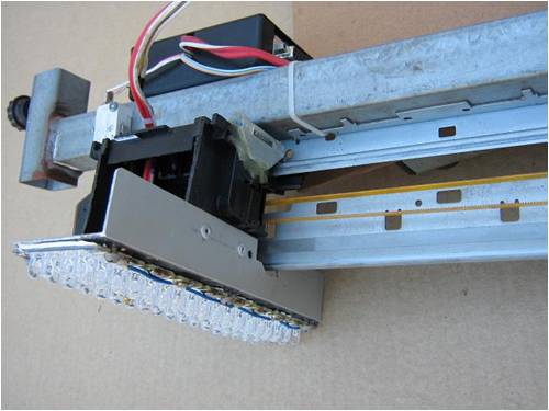

You will need to construct some sort of mount to support the whole carriage arm above the pcb being exposed.
It is best if the height of the leds to pcb can be adjusted up and down to get a uniform coverage of light without huge overlaps or low coverage areas of uv light.
Once position is found it wont need to be adjusted again.
I made the whole carriage arm moveable up and down.
Its a matter of what you have to work with, to how you go about it. Wood or steel.

Looking at your photos the height id about 5" above the platten is this height critical? I am thinking about using wood as I have plenty if, at afixed height I could use spacers to raise the board being exposed, this way I could make a top for a dust cover as that is a bit of a problem here.
All the best
Foolin Around
Posted: 11:59am 15 Jan 2010

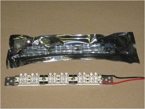

5" is somewhere around the mark but will depend on the lens in the led used and the height will need to be adjusted to suit them.
Can you pop rivet a light section of angle onto the end of the carriage arm so you can screw it to the vertical mount later when the correct height is found.
Then a square of chipboard for a base with a vertical block screwed to it for a mount to fix the carriage arm to, would about do it.
Best not to use spacers under the pcb as this allows for problems if spacers are forgotten.
Get it right once and no need to adjust again.
Its just a matter of having the leds switched on and lift the arm up and down, to a even light patten is found and fix the arm at that height. The end.
There is only the weight of the arm and the leds to support not a lot.
As for dust its not a huge problem as long as you wipe the dust off the cover glass and keep it off the pcb the rest wont matter much.

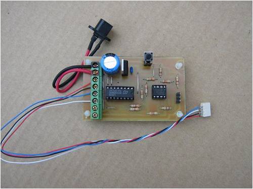

The good news is the driver board is built and tested and works well
The program is done and working.

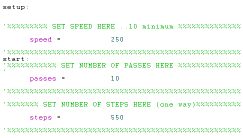

This program is to operate a bipolar stepper motor used in a bubblejet printer for driving the carriage up and back.
The function of the program is to travel a set number of steps and then return the same amount of steps. This is equal to 2 passes, one forward and one back.
The number of steps is set in the program under …. Steps……
The number of passes is set in the program under …Symbol Passes…
The speed of travel is set in program under … Symbol Speed………
The minimum speed value that can be set is 10 being the fastest speed and the higher the value above 10 the slower the travel. Ie :- 1000 is real slow.
At the start of a cycle the carriage will step forward 10 steps, then start the step count from there.
This is to move the carriage off the limit switch to turn the UV Led’s on.
At the end of the cycle the carriage will step back 10 steps to hit the limit switch and turn the Led’s off.
With the carriage travelling in the forward direction a push switch connected to pin3 can be pressed at a selected travelled distance and the limit of travel will be set to this point and the carriage will reverse.
A reed switch and magnet can also be used for this purpose.
Once the cycle has completed and the carriage has parked all driver inputs are switched to low.
If the push switch connected to pin3 is then pressed the cycle will repeat.
At the start of each cycle the number of steps or travel distance will be reset back to full distance.
The program frequency is set to 8 Megs as this gives a smoother stepping.
It can be run a 4 Megs if preferred .
If the stepper motor runs in the wrong direction at start up, reverse the wires to 1 coil.

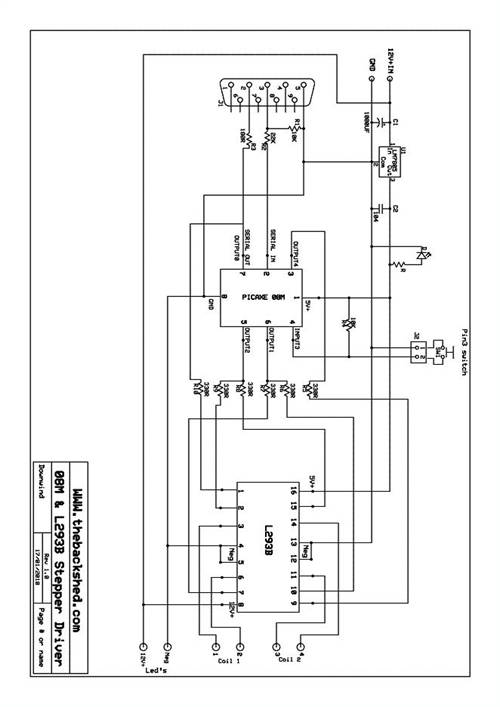

Here is all the files for the PCB artwork (in Expresspcb) circuit schematic as well as a zip file of the program code.
2010-01-17_145235_08M_&_L293B_stepper_driver_schematic.pdf
2010-01-17_145359_PCB_artwork_STEPPER_08M_with-293d_chip.zip
2010-01-26_202158_08m_Picaxe_Stepper_Driver_Code.zip
2010-01-17_152848_08M_and_L293_Stepper_Driver_Parts_List.pdf
The programming socket allowed on the circuit board is 3 header pins to save on space and easy mounting into an enclosure.
A adaptor cable will need to be made from a 9 pin D female socket with 3 wires to a 3 pin header socket to program chip on board or the chip removed and programmed in a different board and reinserted into the driver board afterwards.
Pete.

In the next few days i will be making some PCB's of the above stepper motor driver board if anyone is interested in a board then let me know....Soon.
A extra board or two i dont mind but will not be an ongoing offer.
The board will run any small bipolar (4 wire) stepper motor and the driver chip is rated to 1 amp max per channel.
Although the L293B chip would run rather hot at 1 amp i would think.
Pete.

UV LED SCANNER OPERATION
The push switch / limit switch header pin connection can preform several functions.
1. A push switch attached to 2 pins is mounted in the top of the box, this is used to start the travel/scan cycle.
2. If pressed again when the carriage is moving in a forward direction it will set the position of distance travelled as the limit position and the carriage will return.
3. If a reed switch or micro switch is connected to the remaining set of header pins, this than can be used as a limit switch to set a maximum travel distance.
This is not necessarily required as the maximum amount of steps to travel full distance of the rail is set in program.
4. If the push switch is held down when switching the toggle switch on, the program will enter a test mode where the carriage will move at a fast rate for the next cycle of passes. (then return to program set speed next cycle)
A bipolar motor normally has 4 wires, which is connected to 2 sets of coils.
A multimeter is needed to test the ohms resistance between the 4 wires to determine the matching pairs of wires for each coil.
A ohms reading will only be achieved with the 2 wires to a particular coil.
It don’t matter which pair of coil wires is connected to terminals 1 & 2 with the other pair of coil wires connected to terminals 3 & 4.
If the motor goes in the wrong direction at start up, then reverse 1 set of coil wires only.
Now the carriage should advance down the rail at start up when button is pressed.
The SPEED of travel is set in program and presently set to 250.
The higher the number used the slower the travel speed.
250 gives about 200mm of travel per minute on the carriage I used.
I find this is a good speed for 8-10 passes over the board for exposure.
Number of PASSES is set in program and presently set to 10.
The passes should always be set in even numbers so the carriage always returns to the rest position to switch the leds off.
The number of STEPS for full travel distance of the rail is set in program and presently set to 550.
The supply voltage can be 12-24 volts but the supply voltage is not regulated to the UV Leds and must be kept within the led setup operating voltage.
A 12volt DC, 1 amp, Plug pac should be adequate.
The height of the UV leds off the board must be set so the spot of light from each led slightly overlaps the other, so to ensure even exposure across the circuit board.
Mine is set to around 120mm from base board to the leds.
At the start of each cycle the carriage will step 7 steps forward and start from there.
This is to switch the leds on.
At the end of the cycle the carriage will step back 7 steps and switch the leds off, then rest in that position until the start switch is pressed again.
If the UV leds are on when power is switched on at the toggle switch, than push the carriage back until uv leds are off, before starting the cycle.
The carriage with unused metal bits trimmed off with tin snips
Carriage with printer head removed and excess plastic bits cut off.
A 3mm flat spacer was placed on the carriage and a piece of aluminium
Angle was cut and pop riveted onto the carriage as a mount for the UV leds to attach to.
A piece of aluminium flat 3mm x 40mm x 150mm was attached to the chassis for a mounting point to be screwed to a vertical support.
A section of 30mm x 300mm x 100mm of aluminium angle was also attached as a mount for the controller box.
The control box was stuck on with some double sided adhesive Velcro.
A micro switch was fitted to the end of the chassis so the carriage would activate the switch.
The UV leds are wired through the micro switch to enable them to be switched on when the carriage moves away
and switched off again when the carriage comes to rest at the end of the cycle
Showing the micro switch activated by the carriage and the mounting point for the chassis
2 metal brackets were used to secure the vertical piece of timber to the base board.
The chassis assembly was then attached to the vertical support.
A view of the rear when all is attached
Enough slack needs to be left in the UV led cable to allow full travel.
A length of twin conductor cable was used that was flexible enough to handle the bending movement of the cable
as the carriage travelled forwards and backwards.
2 rows of UV leds attached to the carriage and wired in.
Pete.

Hi Pete
That is a realy top job now I have to get my head around the code to run it.
I will send a picture of mine when I put it together.
The led array in the picture, is that the one based on your own board or one of the clusters?
All the best
Foolin Around
Posted: 02:48pm 26 Jan 2010
The leds are on a board i had made some time ago and have been trying to give it away ever since, as it was configured wrong and need 20 volts to run it.
So i cut the tracks and jumper wired it for 12 volt operation and mounted it on this scanner.
The led clusters are used in the other one i made that is on the first page of this thread.
Pete.
