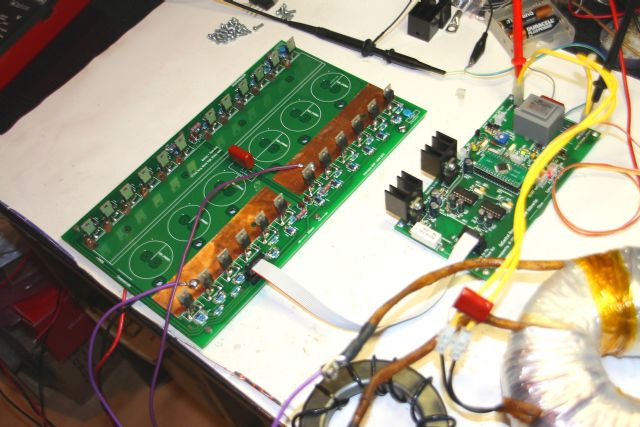

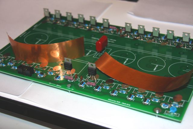

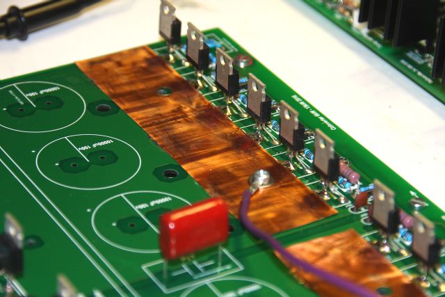

Clockman, solder mask (paint) on your boards is of good quality and hard to scrape off. Was surprised that board is not galvanized completely but only where the solder mask is missing.
Because solder mask is hard to get off I took another move and scratched only some additional joints in the middle of PCB for copper sheets. Then solder it with hot air station behind each FET and on those joints. These sheets shall provide useful contacts to both heat sinks. Board is populated with all FET's and for now operates well.
I have feeling that signal on CRO is kind of modulated. It's clearly visible on analog CRO if I shorten (remove) my choke. Lower part of sinus perhaps bit more than upper part. Have not connected output filters jet, but hope they will smooth it a bit.
Edited by brac321 2017-10-11

Brac321,
Honestly the boards are good to go as they are.
Modifying the Primary heatsinks mounting may cause other issues, and boy those bits of shim are very close to the Battery cable - connections, a wandering insect and ZAP!!!!.
We are dealing with serious amps here, and the board was laid out so that moisture, insects, dust, etc issues would be limited.
I also note some of your caps and de-coupling caps are physically small in size, we deliberately overrated the voltages a bit.
If you are sure that you know what you are doing,? then that's great! but be warned these power boards are deliberately designed as they are.
Nothing with these PCB's and the OzInverter are industry standards, but if you stick to what we know that works then all should be fine.

Hi Brac,
I wonder why you bother with that copper foil. It does not help unless for some reason you put insulating washers under the mosfets. The metal surface on the mosfet conducts the high current to the heat sink, it is at the same potential as the middle pin (drain). So, the aluminium heat sink is the big current conductor with this design, three of the 4 power wires terminate on the heat sinks.
Only the common (ground) high power wire is connected on the PCB. That should be rather wide and have very big tracks to each source leg. I am not familiar with the way this is done on the OZ board design.
And, unless you tin that copper foil the shiny red surface will over time cover with high resistance oxide.
If you want to see how I did it differently check the latest pictures in my post 'building an inverter from scratch'.
If compactness is not a problem then I suggest you look at the way I located the large capacitors. For some strange reason many copied the original Chinese board layout which puts the caps in a heat tunnel between the heatsink fins. About the worst place for them to be from a long life perspective. And, putting them on the other side of the PCB, you can leave all heatsink fins large, no need to trim some short. The cooler you can run this inverter the better.
Of course, that is if you plan to design your own PCB. With your bought OZinverter boards it may be best to put it together as it was designed. I see little reason to 'improve' it, it works fine.
Then, when you got it working satisfactory, and the inverter building bug has you still in its grasp, you could start designing your own boards and let the fun begin...
BTW, PCB's have the tracks 'tinned' (with solder), not galvanised, which is used on steel to prevent it rusting .

Posted: 02:30am 11 Oct 2017
Klaus, thanks for explanation and sorry for my English. I have real problems to express my self properly. Of course I mean tinned... and they are not. It would be better if they were, but I know not every PCB manufacturer do it that way.
About small heat sinks I see situation a bit differently. Yes they are good current conductor regardless Aluminium for the 6 FETs mounted on them, but the middle pin (Drain) goes to the other side of the board on to Source pins of other 6 FETs. That current will in case of insulation on PCB flow only trough tiny middle pins. On the other hand, the large heat sink is on its copper (bottom) plane with few screws that helps sharing current. I see here asymmetrical operation inside the bridge under high loads. Therefor my experiment with copper foil.
I'm real sorry if I "upset" some on the forum, it was only my thinking how to balance current flow ... I din't mean anything bad.

Posted: 01:56am 12 Oct 2017
Hi brac, you are doing very well with your English. I was in your shoes many years ago, well before the internet, and found it hard to learn the technical words required in my job as an electronic technician.
Anyway, about your board. It seems that it was not optimally laid out. But be assured it works for many inverter builders.
I see what you mean by the high current having to traverse the small Mosfet pins at each side of the board. On my own PCB the drain current travels via the heat sink and 6 x 4mm screws (one for each Mosfet) to a very large 2oz copper PCB plane and thence to the other side of the PCB. From there it obviously has to go via the source pin to the relevant Mosfet but I made the tracks there very large. They easily coped with a 6KW load, spread over 24 Mosfets.
I'm not sure if your foil addition is practical in the long run, remember that dissimilar metals in contact, like copper and alu, act like a tiny battery with the alu being eaten away. I would be wary using bare copper.
