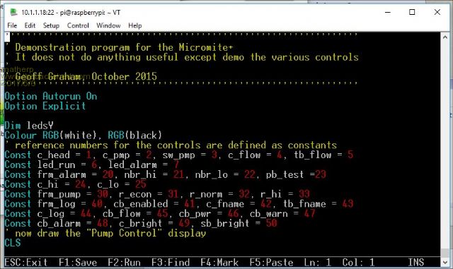

Posted: 10:14pm 05 May 2017
Please find attached 5.3.a19
2017-05-06_092413_mmbasic.zip
This fixes the bug in delete from a18
AND it includes the Micromite full screen editor
Use OPTION COLOURCODE ON to enable colour editing
and then use the EDIT command as in the Micromite
If required you can still use nano using the command NANO
NB: the editing works well using putty over SSH. There is a problem with Delete /backspace in Teraterm. This can be fixed using OPTION TERATERM ON.
I haven't tested using a console window on a directly connected monitor/keyboard. Feedback appreciated.
Edited by matherp 2017-05-07

Posted: 02:11am 06 May 2017
If the console is a Linux one, Fn keys are often set to do things already and would not reach a typical program.
Posted: 02:20am 06 May 2017
  Quote  Fn keys are often set to do things already and would not reach a typical program.
I'm using the ncurses library in raw mode so it intercepts everything before LINUX. That was the only way I could find to get rid of buffering of stdin so that functions like inkey$ and the editor could be implemented.
Posted: 02:42am 06 May 2017
Many thanks to sc05027 for doing some testing for me
Attached 5.3.a20
2017-05-06_124037_mmbasic.zip
The editor now runs properly on a local LINUX console process running on a directly connected HDMI monitor with normal support for the editor function keys
