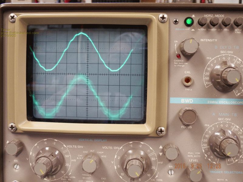

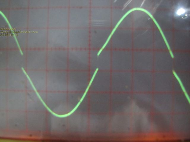

So I connected my inverter to the battery bank and switched it on today.
Well, it soft started and settled on a steady output voltage (235V).
I had an oscilloscope probe connected to the transformer secondary and another probe to the output of the inverter.
The upper trace is the output while the lower is the input to my filter circuit, for which I posted a picture of earlier.
So, despite oztules misgivings, my filter idea seems to work.
That was with no load connected.

Something was very wrong in there, that wave is staggered, should be perfectly smooth, and the secondary trace is very messy, should have been near perfect there too.
There is some wicked noisy silicon or feedback into the wrong places ( noise... floating gate in there somewhere?).... will post traces at various places later today, but none of the traces I have posted previously had any filters... and they don't show any fluffy waveforms on the secondary like that.... check you signal lines waves, and at the gates.
Wondering if your filter is causing this ( extremely unlikely... but... ).... so when you fix the fet/s, try without the filter connected, and look at the waveform, should be very good anyway. It may be masking a problem, that will be easier to see without it connected.
The raw wave with the 2uf shaping caps will look very good on that definition, and will only show a fine sawtooth imposed on the sine wave..... that bottom one is just plain wild.
There is some serious instability there to find.
Do you have the shaping caps/s there installed? ( the 2-4 uf across the secondary ).

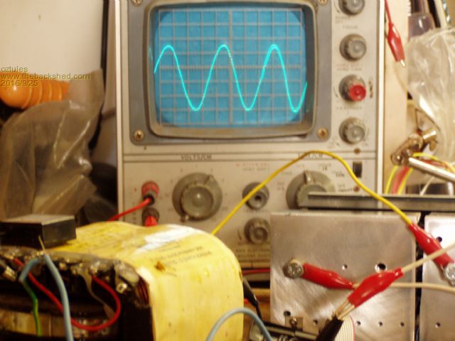

Here is a pic from the one I am playing with for current shut off... single fet/bank
The fluffy appearance is not there in reality, but at this frequency, the scan is flickering in my old girl... it is actually a clean scan... but you will get the idea.
This is the direct output of the transformer with a 2uf cap shaper only, no other stuff connected.. compare this to your secondary scan.... something is very wrong there.
When the batteries in the camera recharge, will do a few more from different places in the circuit if I get a chance.
If you got flash, and no fet has opened up or exploded, then there is a chance it is foreign material causing the bang, but the wave concerns me.
.....oztulesEdited by oztules 2016-09-26

Thanks oztules, makes perfectly sense what you say.
Perhaps the "2uF shaping capacitor" is too far away from the secondary, its connected actually after that filter....
It may be a few days before I get time to unsolder the copper busbars to see the mosfets close up.
I already have plans to make that access a little easier.
And I have a 2uF cap spare so I'll locate that one right at the secondary terminals.
I did not expect that experimental version to work perfectly right first try and it did not let me down there .

Tinker.... I suspect thats the problem, the VFB was getting 20khz noise as a first harmonic... and this would have confused the cycle spwm control for voltage.... your measured 240v or whatever, was controlled by noise, and when you connected the load, it probably damped it, so the control circuit took off trying to make up for the lost spikes.... full spwm into the stiff transformer may be the answer here.
The spwm would have driven those multiple noise lines because of the wild VFB signal perhaps... only conjecture, but seems to fit the wave form in theory.... maybe...possibly....
Can't see how else you would have such strong hash, it was as strong as the primary wave in amplitude.
.......oztules
Edit IMPORTANT!!
Yes the feedback ( VFB ) MUST come directly from the secondary wire terminals themselves... or it WILL blow up when load is applied.
By putting the feedback take off after the filter, you have introduced damaging hysteresis, causing extreme over shooting in both directions... seen as the fluffy wave forms before the filter.
Edited by oztules 2016-10-01

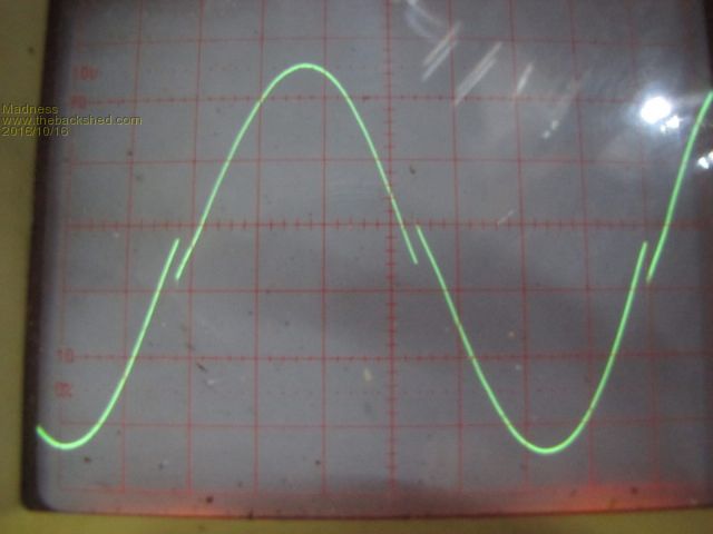

Your not the only one to hit a brick wall, I have blown up quite a few MOSFETs.

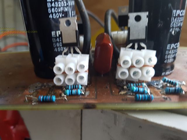

First off my CRO was not working and I had picked up somewhere the wrong values for the snubbers(103 3KV cap and 2W 47r is correct), had a few spectacular failures from that. Flying blind made it even worse, I even made up an easy way to swap MOSFETs without soldering.
Since doing this I have only had to change the MOSFETs once and that was due to over heating with no heat sinks. I know it looks like crap, that board was actually in the bin at one point, my PCB making skills have improved a 1000% since)

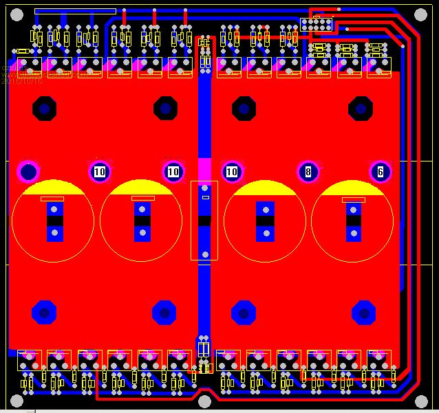

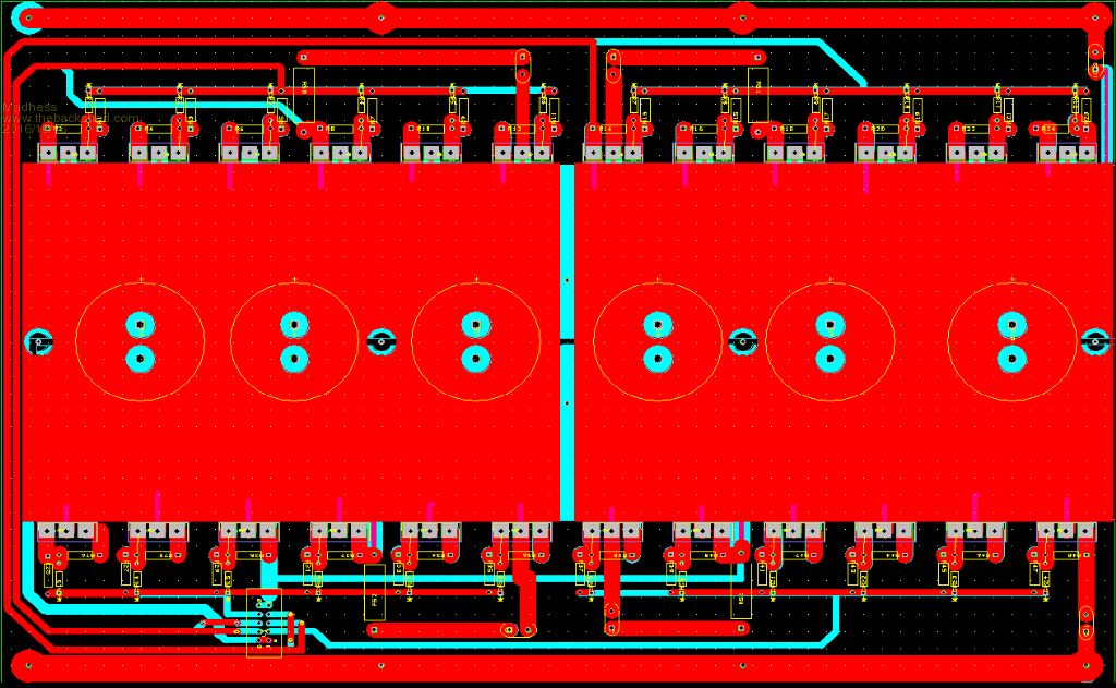

I think I am on to what the issue is, if you look on the design made by Clockman based on the Chinese boards there are 4 tracks that run around the left-hand side of the PCB and 2 drive the MOSFETs, the other 2 are connected to the left and right bridge. When I first saw that and was redesigning for my own reasons I thought why would they run those tracks to the left & right bridge when they are so close to the connector on the PCB. Now believe there is a reason, here is what I am getting from the board shown above where the tracks just take the shortest path.
One is from L output and the other is from N output, another board with a different layout similar to the Chinese boards but not with all those 4 tracks up the side is working. However, it has a similar wave-form to above but also has a bit of squiggle in the sinewave on the slope up from zero crossing. This resulted in fairly loud buzzing in the Toroid and choke, with the little test board and the wave-form shown above it has a very slight hum.
It has come to a standstill at the moment as I am waiting for more MOSFETs and blank PCB to arrive so I can test my theory, here is the design I will trying next.
I was waiting to try it again and post the results then.

I used the power jack power boards with the resistor and diode mods for my first power experiments, and all went swimmingly..... didn't know how lucky that decision was to be.
Had I had the problems you boys have experienced I don't know how far I would have gone, thinking it just might not work... and gave up on it.
As it is there are plenty of running version around the place now...... one that has been running for months now on a remote island.. very glad that one works flawlessly,as it runs the whole shebang down there.
It is looking like the power board may be the key... just hard to believe with the run of success I have had.... Even the two or three experiments with the flat heat sink designs worked fine up to at least 7kw surges, and 4kw continuous.... tests finished as I decided to go with the PJ style.
Sometimes it pays to be lucky
The new boards I got made ( basically the same as the pj 8000w units) work fine too..... so we know that design works perfectly well also.
Thats this one:

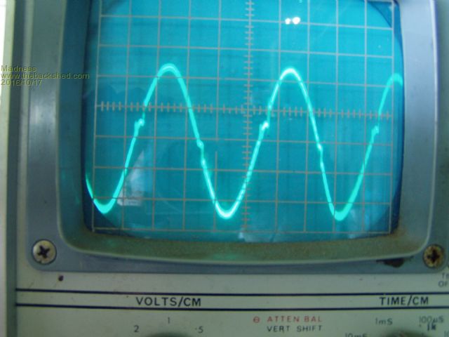

Well, I know the circuit works for you but find it difficult to believe that running the tracks differently should upset it.
I do have all my gate drive signals running the same physical length (mostly shielded cable)and the power tracks as short and beefy as possible.
I also know that the latest failure was most likely caused by myself by not noticing the tiny craters in the top of the driver & controller IC's and plugging in the same EGS002 board that was used on failure #1.

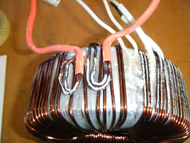

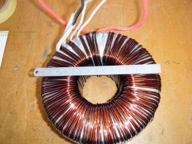

As mentioned above, I'm building a 4 Mosfet inverter for testing purposes. It will closely resemble the layout of the big one and use the same auxiliary boards to drive it.
I removed the wrapping from my little 1200VA - 48V toroid and did some testing to see if it is suitable for that.
This thing has 65 turns (2 in hand of 2.3mm dia wire) for the primary.
Powering it from the 240V winding I see 35V AC on that 65 turn winding.
This is a lot higher than the 26V AC my double stack big toroid generates.
So, do I just unwind 16 turns to reduce the primary voltage to 26V?
I'm almost certain the answer is yes but its always good to have that confirmed by the forum's expert on this matter.

I think remove 13 turns and go to 28v for testing, slightly less stress on the fets, but more drive on the driver chips. The chinese with the 002 units like 26v, I still think 28v is acceptable too for most battery voltage in the 48v band.... my heavy power is during the day, and b+ will be 55v or more as a rule.

[Quote=Tinker]I know the circuit works for you but find it difficult to believe that running the tracks differently should upset it.[/Quote]
So do I. The actual resistance difference between a short and long track would be negligible I would think, when you are talking about the tiny currents being used for the gate control lines - does not make sense to me either.

As yet I have not tested my theory, it will be a week or 2 before I get the parts needed. I have tried as much as I can to eliminate all other possibilities by doing the following.
I have tried 3 different transformers
My big double stacked toroid
A single toroid wound with 22 turns on the primary
A EI transformer from a dead 2KW square wave inverter (also much more forgiving than a Toroid for testing)
All of these give much the same wave form, so can all 3 have the same problem?
Same thing with 2 different chokes, one which the coil was made by Tinker, the other using insulated cable, the one with the cable did give a fuzzy wave-form if the cable was not kept secure.
Also, I have tried 3 different control boards, all give the exactly the same result. So can all 3 have the same problem? One of which came from Oztules.
(BTW I have learnt the hard way, any sort of issue or first use, connect the control board to 48V ONLY and turn on, you have 3 seconds to check wave-forms on the IR2110's before it shuts down due to under volts.)
That leaves the power board, the results of the of the rough test board are shown above. It is fairly good apart from something wrong in the timing or level at the time it crosses 0 volts. That board is a design I have long since abandoned. Another board very similar to the design in red and blue above. It gave a slightly worse result than this one from http://www.anotherpower.com/board/index.php/topic,1116.105.html shown here
In my case, the distorted part at 0 is followed by a by a squiggly distortion of the wave that disappears just before the peak. when running it causes all 3 transformers and chokes to buzz quite loudly. This PCB is exactly the same circuit as the boards Clockman is making, biggest difference is the track for right bridge is connect by the shortest route, the one connecting to the left side goes up to the top left and connects.
I have tried different cables, transformers, control boards, chokes and so on the only common factor is my battery bank.
If it is not something to do with the power board I must be completely insane. It does not make sense to run those tracks up the left side of the PCB to connect to the bridge, it is the long way around, it is much easier to connect to them on the same side as the 10 pin connector. There must be a reason why!Edited by Madness 2016-10-18
