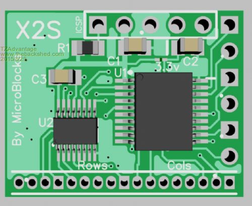

Yes, i like small. It is 23x18mm.
All the pins are still on a 0.1" grid. I considered 0.05" to allow flat cable, but then it gets really fiddly. Maybe i just try it to see how it pans out.
Edited by TZAdvantage 2015-08-30

Posted: 12:23am 29 Aug 2015
Greg,
I changed the 0.1" grid to 0.05" for the column and row pins. Now all connections to a keypad/keyboard are on a single edge and are easy to connect with standard flat cable. Flat cable should be spaced 0.05" so it will line up.
3d:
There is even space for a micro usb connector on the left.
That would allow making a custom usb keypad. Just what i need!
Getting better al the time. Thanks for the feedback.

Posted: 01:08am 29 Aug 2015
That will be good for ribbon cable but the FPC on Grogs' 'blue' keyboard has 1mm spacing, not 0.05" i.e. 1.25 mm. If a keyboard has FPC it will probably be 1mm (not expert on this at all) so making it easy to attach to that would be good. If it's better to come direct from the keys without the FPC, or if ribbon at 0.05" is the cable used in the keyboard, then ribbon at 0.05" spacing would be good.
Ideally both is best - how about 1mm pads to match Grogs' connector (see p3 of thread) and 0.05" header as you've done for ribbon - just have to fit it.
If a micro USB will fit that's a plus but it will still need header access to the USB lines and ideally some way (a couple of close holes for a cable tie?) to securely attach a hard wired external cable.
Greg

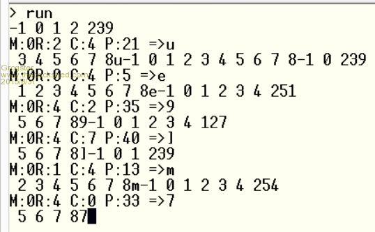

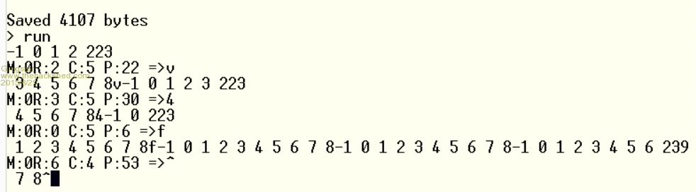

Posted: 05:56am 29 Aug 2015
Grogster,
Can you do the same kind of screen copy of the following keys for me?
Tab, CapsLock, LeftShift, Fn, Control, Option, Command,
LeftArrow, DownArrow, RightArrow, UpArrow,
RightShift, Enter and Delete.
I can then have a go to write some code to handle the special keys and figure out the rest of the Lookup table.
Posted: 08:52am 30 Aug 2015
I ran into some trouble with the code.
Should have thought about it a bit more. I was handling it as a keypad not a real keyboard. For that it needs to work as a replacement for a PS/2 keyboard and send VT100 codes through the serial port.
Also the shift,caps,control etc keys need to be handled better.
So a rewrite of the scan and lookup is necessary. Otherwise it will never work with the editor.
Stay tuned, i think i have figured it out but i need some time to test it.

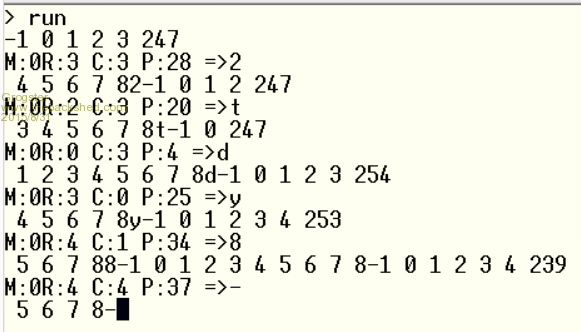

Posts: 10109
Posted: 02:08pm 30 Aug 2015
So, do you still want those screenshots?
Posted: 03:17pm 30 Aug 2015
Yes, please.
Posts: 10109
Posted: 12:06am 31 Aug 2015
UPDATE:
TAB,CAPS,L-SHIFT,Fn,CONTROL,OPTION,COMMAND:
LEFT,DOWN,RIGHT,UP,R-SHIFT,ENTER,DELETE(backspace):
Looks like gobble-de-gook to me, but I guess you can make sense of it?
Posted: 12:17am 31 Aug 2015
Yes the R:, C: give the row and column. And P: gives the location in the lookup string.
Helps me to check critical points (modifier keys) in the matrix.
Thanks!

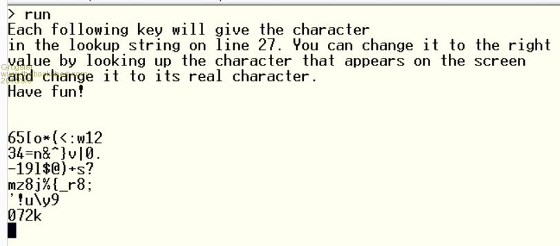

Posted: 11:37am 01 Sep 2015
Grogster,
Here is a totally rewritten matrix scanner.
It works with a timer interrupt and has a better structure to allow for all the special keys.
Code for the special keys have to be added, but i need from you the complete translation of all the keys.
When the program starts it asks for the ENTER key. Press that and you are instructed to change the code.
After you change the code run it again and then press all the keys
in order from left to right, top to bottom. After each row press an enter.
This will allow for an easier screendump with all the key values on it.
At the end use the arrows left, up, down, right in that order.

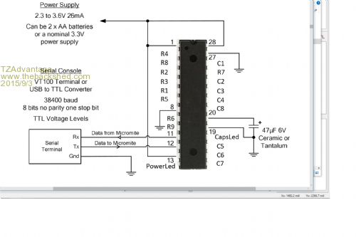

Would it be possible to not use either the pins for COM2: (9,10) or the pins for COM1: (21,22)
This would allow you to keep the console connected to the computer while a COM port is used to output the keyboard data.
You would then be able to configure/program the keyboard through the console normally and even show debug messages while 'in-circuit'.
Their should be just enough pins (if i count right) to do that.
Edited by TZAdvantage 2015-09-03
Posts: 10109
Posted: 03:54pm 02 Sep 2015
Yes, can be done like that, but then no pins for either of the LED's.
It's an interesting(and good!) idea though, but how to handle the LED's?
We could just drop the LED's altogether(then the problem is solved), but I think they are nice to have.
We could go to the 44-pin chip, then there would be no problems with pins, but not checked if the QFP would fit.
Any reason you can't use the console for BOTH?
Have a DEBUG routine you can call from the console, and run that if you need to debug, then the console would output both debug information, and the normal keypresses much along the same lines as all of the testing done thus far does.
With autorun set on, the KB would start in KB mode as normal, but if you connect the KB to TT or the like, issue a CTRL-C, then direct the code to the debug routine, you have your testing mode.
I might well be not seeing something here, in the way you want to do it, but.....
I will do that testing you want tonight - sorry, I did not get to it last night.
Posts: 10109
Posted: 07:46pm 02 Sep 2015
UPDATE:
Here are the results of running your code TZA:
Each row of characters are the keyboard rows, left to right, top to bottom - as requested. Last line are arrows in left,up,down,right order as requested.Edited by Grogster 2015-09-04
Posted: 01:37am 03 Sep 2015
Thanks Grog. That makes it a lot easier to get that lookup table right.
Edit: The number of characters on your screendump are not all of the keys.
I guess the scan routine drops some keys. The top row should have 13 keys and i see only 11. All other rows are missing 1-3 keys also. Did you use TeraTerm because MMEdit VT100 sometimes misses a character.
I have made a pinout of what is used and no more pins available. Why does the chip have 3 GND connections. I guess because it is long and skinny.
However it will still be possible to have a separate output if that is the wish.
We could use a single pin and bitbang a serial out by using a CFunction made by Geoff.
If the two LEDS are charlieplexed they would need only one pin. That will free up a pin to use as a TX output.
Edited by TZAdvantage 2015-09-04

Posted: 02:44am 03 Sep 2015
Hey TZA.
I will run the test again - perhaps I was pressing the keys too fast.

I will do another run of that test now, and post the screen grab shortly.
