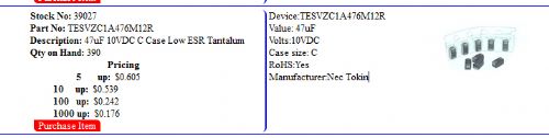

I know what you mean about price, I bought mine from element14 (not arrived yet) because I was ordering a couple of PIC32MX150's and their price was were $2.16 + GST each (for the Caps NOT the Pic32)... but free post..
You can get a 10V Low ESR 47uF from Rockby.com.au for 60c ea..
I assume the 10V shouldnt be an issue (6Volt is quoted)..
See this image
EDIT** Hard to read the JPG (due to the back shed's) compression ...
The Stock code is 39027

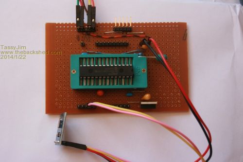

I only received the parts for my uMite Monday.
I have started playing and planning the changes needed to MMedit.
I used Jaycar 47uF tantalum and a LM1117T regulator with a couple of 10uF on input and output. I added a couple of 0.01 uF caps just in case...
In the photo, it's happily running a BMP085 I2C pressure module.
I have been editing in MMEdit2 (not the version I released) and transferring to the uMite OK.
I tried 2 different USB to TTL modules and one of them had the Tx and Rx lines back to front. That was the first one I tried of course.
MMEdit 2 will have the choice of 2 different serial ports and an option to look for unsupported commands/functions so you can check the code before uploading.
I think there will also be a 'click and set' panel for things like CPU speed and AUTORUN.
I think I can make a couple of changes to the original MMEdit to make it useable with the uMite and that should be fairly soon.
