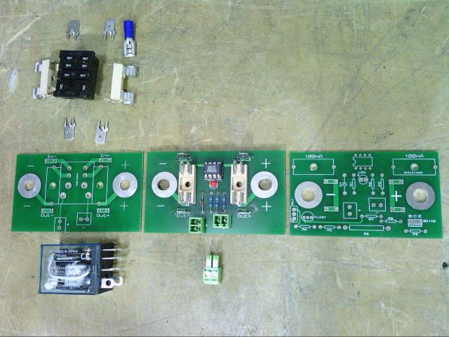

I just did a 16 relay board with warpspeeds way of connecting the contacts and it works very well indeed.
There is just one suitable relay I found at my local electronics shop (Altronics) that fitted my size, specs, pin arrangement and price category. The latter is quite important when 16 relays are involved.
A bonus was that I could fit these relays on sockets (cheap SIL) so exchanging a faulty one takes only seconds.
If anybody is interested I might write up this latest modification here.

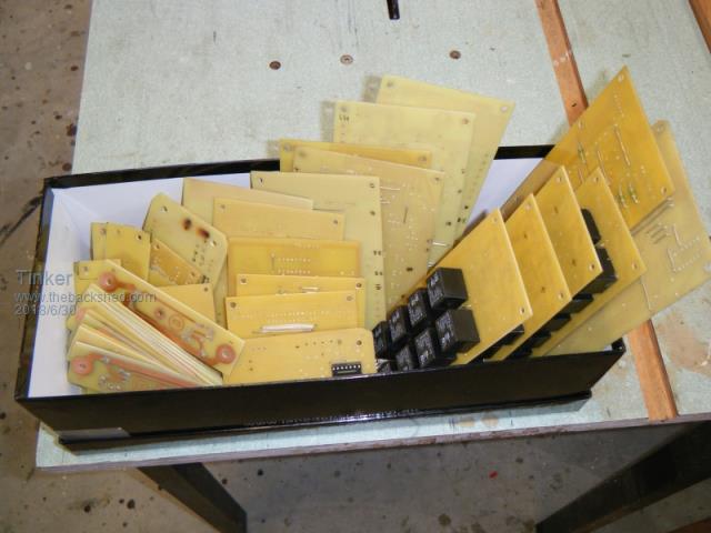

There were also problems with relay contacts, I turned off the balancing overnight to save contact wear but this allowed the supercap to discharge and its inrush current is capable to weld relay contacts when the balancing cycle restarted with battery charge coming in from the solar panels.
Anyway, lots of tinkering with different relays and even with driving them by a program that was seeking the cell with the highest charge and then that with the lowest charge, followed by several 'charge dumping' cycles since one can only 'dump' a small amount at a time due the small (mV) difference in cell potential.
Here is a pic of a box full of discharged experimental home etched boards:

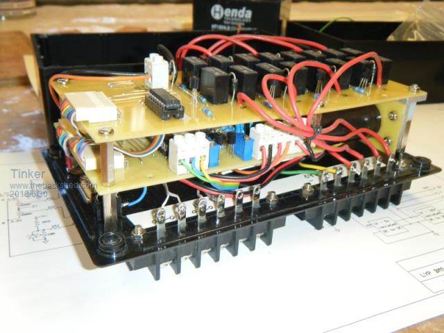

After 3 years I upgraded to a 48V battery bank which required a new approach to cell balancing.
Here is a pic of an early version of my balancer:
Instead of an exponential decaying charge from the supercap transfer I replaced that cap with a fixed voltage isolated power supply.
This, set to just below maximum allowable cell voltage, transfers charge which is tailored, depending on the connected cell, automatically and for the full connect time of each cell.
Quite a lot more charge transfer can happen now even though I had gone back to the sequential stepping through the cells method.
The hi/lo seeking method takes way too long with 16 cells...

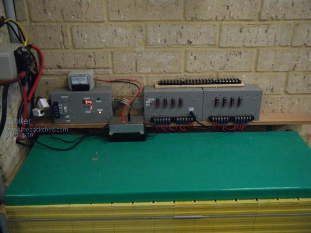

So, this is what balanced my battery bank for the last 3 years:
It worked fine but has half a dozen PCB's spread over 3 enclosures. Time to find a simpler way .

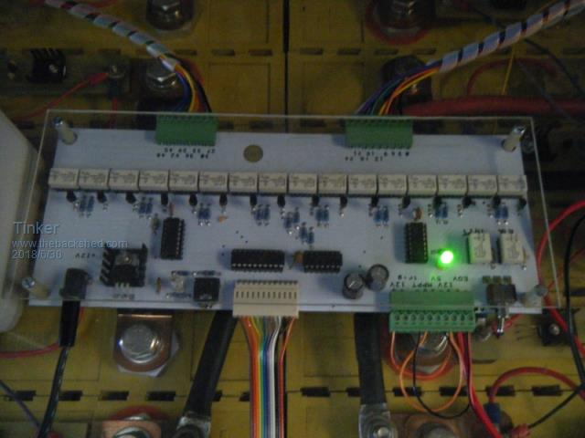

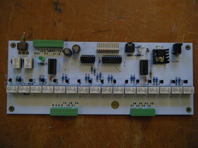

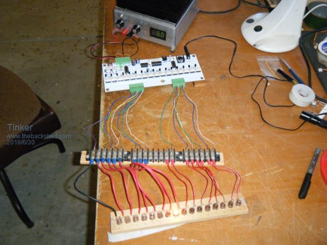

Using a made in China double sided board I could squeeze all 16 relays on it. Those relays were a good find, passing my size, price and contact/pin arrangement criteria.
Here is what it looks like:
Its driven by the same simple picaxe micro I used for my earlier versions, the relay on/off times etc being easily changed to suit.
I made a test rig which passes a few milli Amps via incandescent bulbs through the contacts, far less disastrous if something were wrong than when the relays are connected across 200Ah cells. The bulbs light up as the sequence closes each relay in turn and can be observed for sufficient 'dead' time between steps.
Here it is in operation:

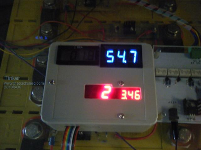

There is a LED display that shows each cell Voltage and cell number as the program steps on. Battery voltage and current is also displayed here.

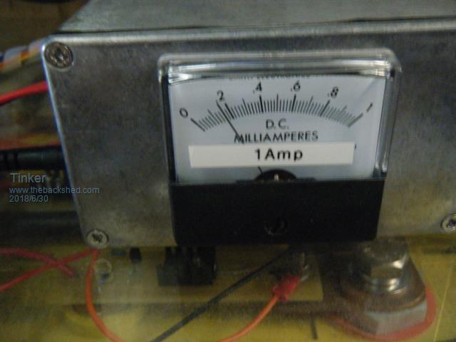

Another enclosure with a series analog Ammeter shows the particular charge rate for that cell.
Observing this I can easily see if all is well. That output could be logged but Its not done yet.

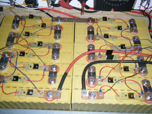

Lastly, this type of balancing does not prevent overcharging the cells so another kind of cell balance (shunt regulator) is employed for that.
From my observations for new cells, a shunt regulator across each cells might have very little work to do if the charging voltages are set right.
However, I have found my 6 year old cells definitely require this, they go out of balance very quickly otherwise as I found out when removing them while re arranging some connections and leaving the shunt regulator off for a few days.
This is what they look like, one across each cell:
Close inspection may notice one cell shunt reg. has a bigger heat sink, this cell had drifted way too high during the absorption cycle and required severe charge dumping for a while. Its now back in line with the others.

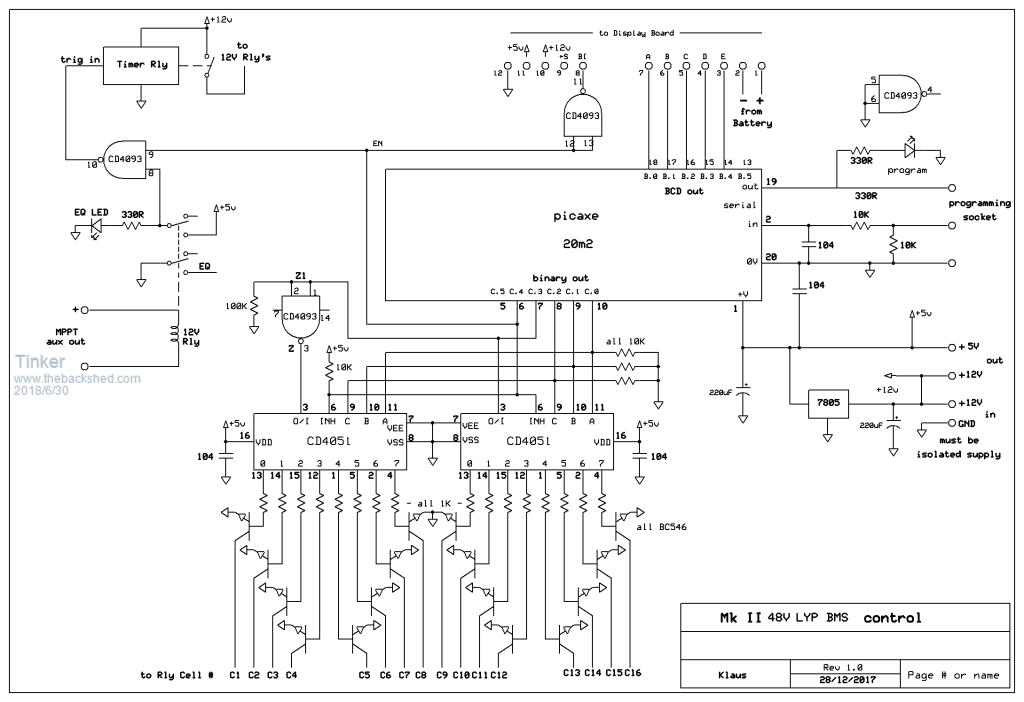

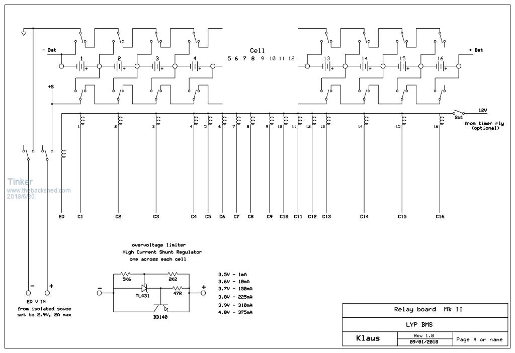

So, how does it all work? Below are the schematics for the relay and control board, there is another for the display which I can post if anybody is interested.
My thanks go to warpspeed for suggesting the relay contact arrangement, it works a treat .

Posted: 12:51am 01 Jul 2018
Welcome to the Forum ESPcatman.
Klaus had a system very similar to yours at one stage. I called it a "capacitor hopper". And it does work, but the amount of charge transferred is not very high.
If your cells are either very large, or very old it may struggle, but for a very small system it should work.
My first system used a relay mounted on top of each cell with the contacts connected the same way Klaus has connected his. The relay contacts are daisy chained with short links between the cell circuit boards using spade connectors, so at the end of the chain I had a pair of connections that could be connected to either a cell charger, a cell discharger, or for direct cell voltage measurement, all under software control.
These relay contacts switched power perfectly well, but were a total disaster when trying to accurately measure individual cell voltage at high impedance.
It may have worked with much higher quality relays such as mercury wetted relays, or vacuum relays, but the cost of the relays made the whole relay idea impractical for what I really wished to do.
Ordinary electromechanical relays will work perfectly well for switching power. But I wanted to use this for accurate reliable long term control and monitoring, so had to think of a better way to consistently monitor cell voltages. Cell voltage monitoring is my very first priority, cell balancing comes a distant second.

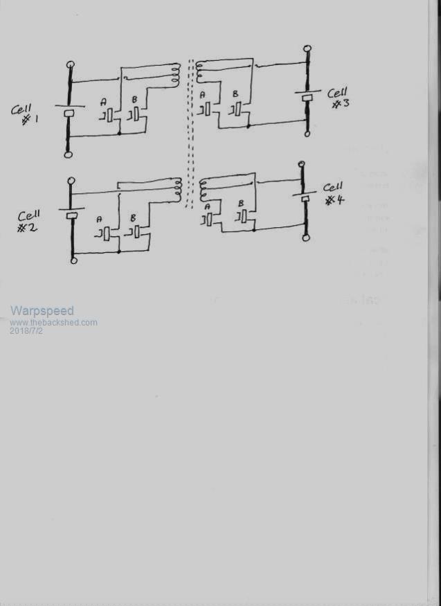

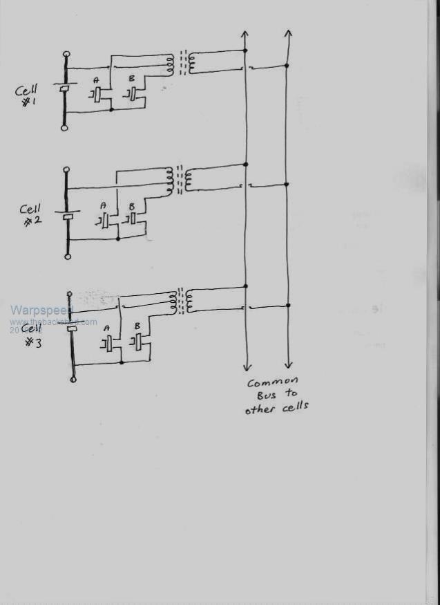

To those out there still scratching their heads...
This is not pie in the sky stuff, its a definite proven technique.
The idea is to have a single transformer with each cell having a push pull driver with its own winding on a common core.
If the "A" and "B" mosfets are all driven together alternately with identical drive waveforms, power will flow between the higher voltage cells to the lower voltage cells.
The cells remain individually fully dc isolated, but the cell voltages equalize just as if they were hard wired in parallel with a very low ohmic resistance.
This is the general idea:
This shows four fully isolated cells coupled together with a single transformer that has four windings. Very neat and efficient where there are few cells.
An arguably better way, especially where there are a very large number of cells, is to give each cell its own small transformer, and couple all these individual transformers together onto a common bus.
The operating principle is identical, its just a physically different way of going about the same thing.

The individual transformer\cell way is going to reduce he amount of RFI by a huge amount as the cables are shorter. Its already bad enough around here at night with the cheap Chinese led light bulbs filling the spectrum up with hash and affecting the radio.
How do the car manufactures do this, they have spent millions on research and surely would have the best solution.

I forgot about pencil and paper....I was in the process of doing such a sketch on cad - thanks Warp
See - you developed an AC bus which would work and has way fewer parts than a DC Bus.
If we use a double ended ETD39 core bobbin we could have 32 pins, so with 1 flying lead we have 11 CT windings. Thus we can balance 10 Cells and could have an extra DC Rectified Bus that we can couple likewise to the next Board of 10 Cells. Two transformers & 20 cells being balanced.
Transporting DC would mean we can use common mode chokes, ferrite tubes etc to keep Solar Mikes happy - (transporting AC squarewaves that have harmonics that stretch from Dc to Light (well nearly) on long wires) is environmentally unfriendly for emi.
I am not trying to drive a particular solution just putting stuff out there to consider.

Considering that any measurable voltage differences between cells are only apparent during the cell discharge or top of charge end points, and the time duration of each may be less than an hour, a 420 ohm resistor seems insufficient. They must use individual cell coulomb counters to work out how long to leave any individual cell discharging.
This means a complex cpu solution is required, don't want to go that way either...

Before too much time is devoted to heading in a particular direction for this discussion I think we need a spec of some sort. In a small or large LiPo string set up, what is the maximum/minimum balance currents that are needed ? That will help shape the right solution.
Perhaps individual small transformers and SMD devices and a DC bus is still the way to go for low power (sub 100mA ?) we just bus the opto drives and Dc between boards. However this is leaning to a commercial solution as soldering SMDs with ailing eyesight (and patience) is not my idea of a fun evening..... rewinding a big toroid is almost in the same league.

Posted: 02:07am 02 Jul 2018
Mike,
Don't know how the software works Mike, but it probably works out what needs to be done during charge/discharge as you suggest. Then nibbles away at the problem very long term and very slowly.
There are several separate battery modules, and each has its own microprocessor and BMS, all linked to the other modules and to the whole overall vehicle management system by serial data links.
A real dog's breakfast, and hackers dream.
Wiseguy,
Many possible ways to go about it.
Might even be possible to pass a cable bundle through multiple high permeability toroids so that only one turn is required to couple everything together, current transformer style.
EMI could be eased by slowing the whole mess right down. Just because its a switching power supply it does not have to operate at 500+Khz. Only half joking, but why not switch at 500 Hz ?
I still like the idea of pulse transformers driving the gates, and individual power transformers for each cell on identical circuit boards. That is a lot of transformers, but apart from the actual mosfets, there would not be much else required.
