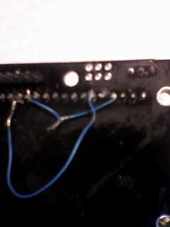

  sparkey said   whilyst on this topic of the "lcd & keypad sheild i do really think that there are some other connections that you have not come accross...regards sparkey...///...///
Sparkey, it doesn't matter how many times you ring me, or how many times you ask on the forum, unless you do the two changes to the basic code correctly, and the two track cuts correctly, and the two jumpers correctly, then it simply won't work.
After doing this correctly, it should also work on a standard Maximite. I am about to try it now.
It has nothing to do with firmware versions.
BTW Happy birthday.
Cheers Don...
EDIT: After doing the correct mods, it also works on the standard Maximite.
Read through the information again, if you can't get it working, please ring tomorrow afternoon.Edited by donmck 2011-11-19

sparkey
Joined: 15/06/2011
Posts: 819
Posted: 03:09pm 17 Nov 2011
well ok then is this correct...
donmck
Joined: 09/06/2011
Posts: 1314
Posted: 03:17pm 17 Nov 2011
  sparkey said   well ok then is this correct...
Sorry, not even close sparkey.
I have re-written the details to hopefully make it clearer.
Jumper DuimoMite PIN (13) to PIN 4 (RS) of the LCD header.
Jumper DuimoMite PIN (14) to PIN 6 (E) of the LCD header.
The DuinoMite (or Maximite) PIN is referenced to the software pin, and is shown on the picture below:
Cheers Don...

sparkey
Joined: 15/06/2011
Posts: 819
Posted: 03:56pm 17 Nov 2011
ok a picture tells a thousand words but i`m sorry i cant figure this one out ..no disrespect but with what you have added im sorry if i rattled your chain to much today it was not my intent ..shure its good to be the first of the block i live for it when i came into this forum i had great expectations of what was or could be done with this machine and i guess i did gloat a little but i`m shure that i was not the first to have a "dynamite -mega" thats for shore really i have given what i could only trying to set some easy steps for others to follow and yes well if you want to go over the "rtc" issue because i made it work with what i had available then so be it ...seriously i dont need the "greif"... and today i was very exited about just having one of these boards i could of just as easily let it sit on the bench admireing its conceptability... i dont want to come to bad stuff between us ...
