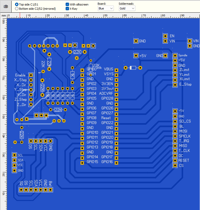

I had a bit of a tinker with it:
pico 2 board.zip
Please check:
Track widths
Hole diameters (a bit inconsistent)
Continuity (in case I messed up)

Morning Guy's, Well still on my morning caffine intake   Now Phenix that board is looking way much better   and I'm looking forward to having a good look at it.
Now with the limits Lyle that new circuit does look the goods mate   and what I'm thinking the first job I will be doing once I setup the 2350A on the breadboard is set up the I2C on the zero so the zero can take of of the limits then when a limit is reached a I2C interrupt can send the control(val) number to the pico so action can be taken.
This way your circuit can go on a new a new board with the zero for each axis while taking care of the battery management.

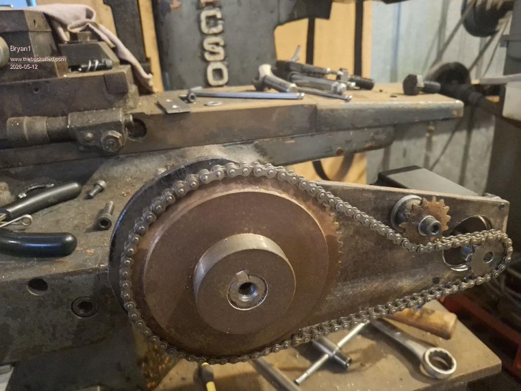

Well just on lunchtime   and got the chain drive setup good enough for the trial runs as I do still need to finish off the idler sprocket so it's adjustable.
Regards Bryan

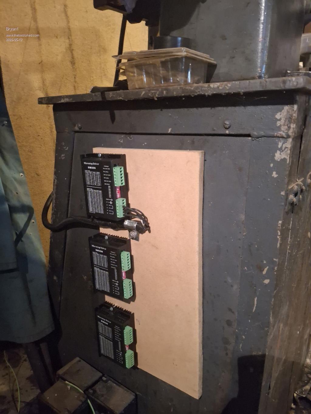

This afternoon mounted the DM556's on some MDF and attached it to the side of the work table. Got the Z axis all wired up so in the morning the X and Y axis will get done then time to redo my breadboard so the testing can start. Now for that clamp for the Z axis wire I just made it from a Nescafe 43 coffee tin where it was folded in half then each side got a some love tapping to stiffen it up. A short length of 1/2" copper pipe soon got the radius done and tek screw soon got it clamped.
Now with the X axis mount I had to give it a love tap to correct the misalignment on the stepper. Also I made a 4mm spacer to move the mount out for alignment and it worked out a tee.
Also this morning got into Sprint Layout where I changed all the drill holes that were still 0.6mm and found the top left 2 transistors didn't respond to the GND test so connected the emitters on C1 to get them working.

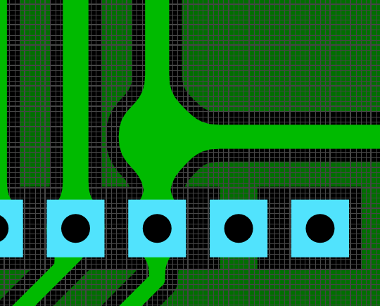

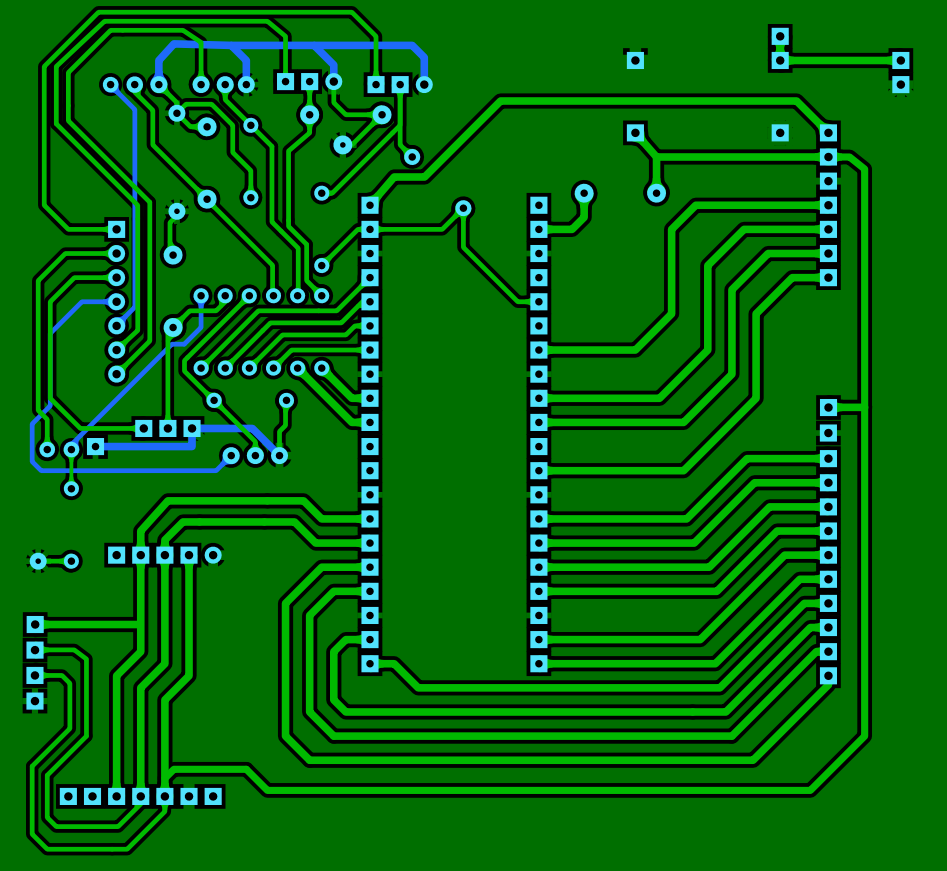

That was messing with my 45-degree-diagonals-only OCD   so I had to change them. The bottom VCC track was also bugging me
Two pads were not through-hole so I changed them:
pico 2 board.zip
Edited 2026-05-13 01:39 by PhenixRising

Ideally, when two traces meet, they should only ever meet at right angles. When sharp points of copper are left between traces there is a tendency to get over-etching, which can cause the board to fail optical testing even if it is fine electrically. It also produces a weak point in the copper.
If the two traces differ a lot in width it is good practice for then to meet at a pad, even if it isn't drilled. This re-enforces the junction, once again protecting from over-etching or possible copper lifting with temperature changes.

How about this. I put a temporary pad there, generated a "teardrop" and then removed the pad.
Posts: 9328
Posted: 04:57pm 12 May 2026
The "teardrops" and smooth curves are pretty but a) of limited real value and b) a complete pain if you come to edit a board later as they are made from little triangles - they are not part of the trace itself and can be exploded off it.
Just don't put bends tighter than 45 degrees in traces, they'll almost certainly be strong enough then, even without curves. They will be easier to guide through narrow spaces too.

I dub this "Funky Junction"

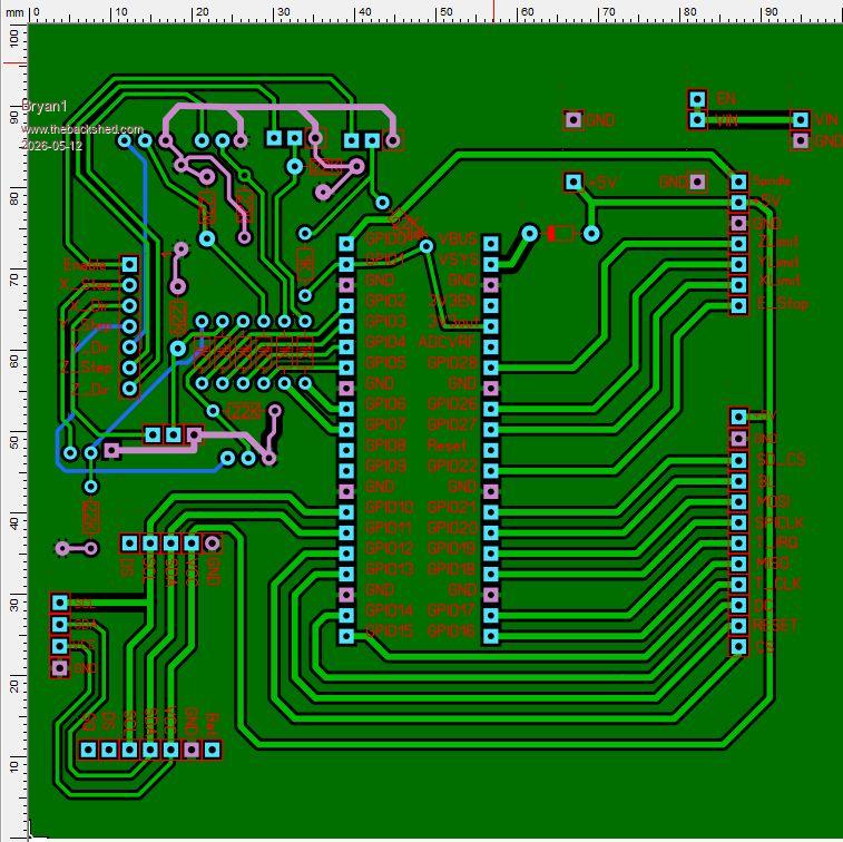

Morning Guy's, Well it does look like this current pcb design does pass the muster with you guy's so I may aswell after a few years have a go with JLCPCB and get the boards made
First gotta head into town for more cow juice as I can see quite a few caffines downed today as I play with the code, had a good look this morning and read of the stepper pdf and some of Peter's examples so got a good headwind into the tasks today.
Now with the Z axis I still have to set the thrust bearing for the backlash and honestly I can see that shock absorber being fitted as when we need to raise the grinding wheel in a E_Stop condition taking up the backlash isn't an option period, by going this way the grinding wheel doing 2,500 rpm may just survive.
On thinking one thing I didn't put on the pcb is the console breakout so that will be the first job to do, then I can use that micro-bridge as the link to teraterm etc.
