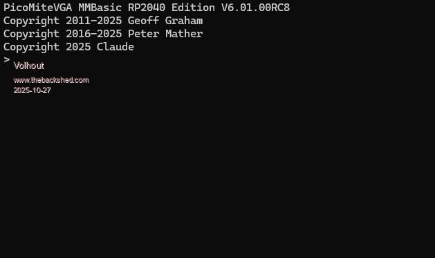

  Quote  About JPG dithering. Something has changed when JPG size is larger than screen.
With RC7 you would just show top left part of the JPG that fit's the screen resolution.
You just can't trust claude to think things through properly
Try this version for RP2040 VGA
PicoMite.zip
This now has the same format as load dithered

Posts: 6253
Posted: 10:07am 27 Oct 2025
Hi Peter,
Claude simply needs your supervision to get to great results....
JPG dithering works fine now.
The speed degradation also seems gone (to the same level as RC7).
P.S. the "LOAD DITHERED" is already compatible with "LOAD IMAGE", so it could be removed as a separate command. Just add the extra parameters to LOAD IMAGE.
Edited 2025-10-27 20:26 by Volhout
