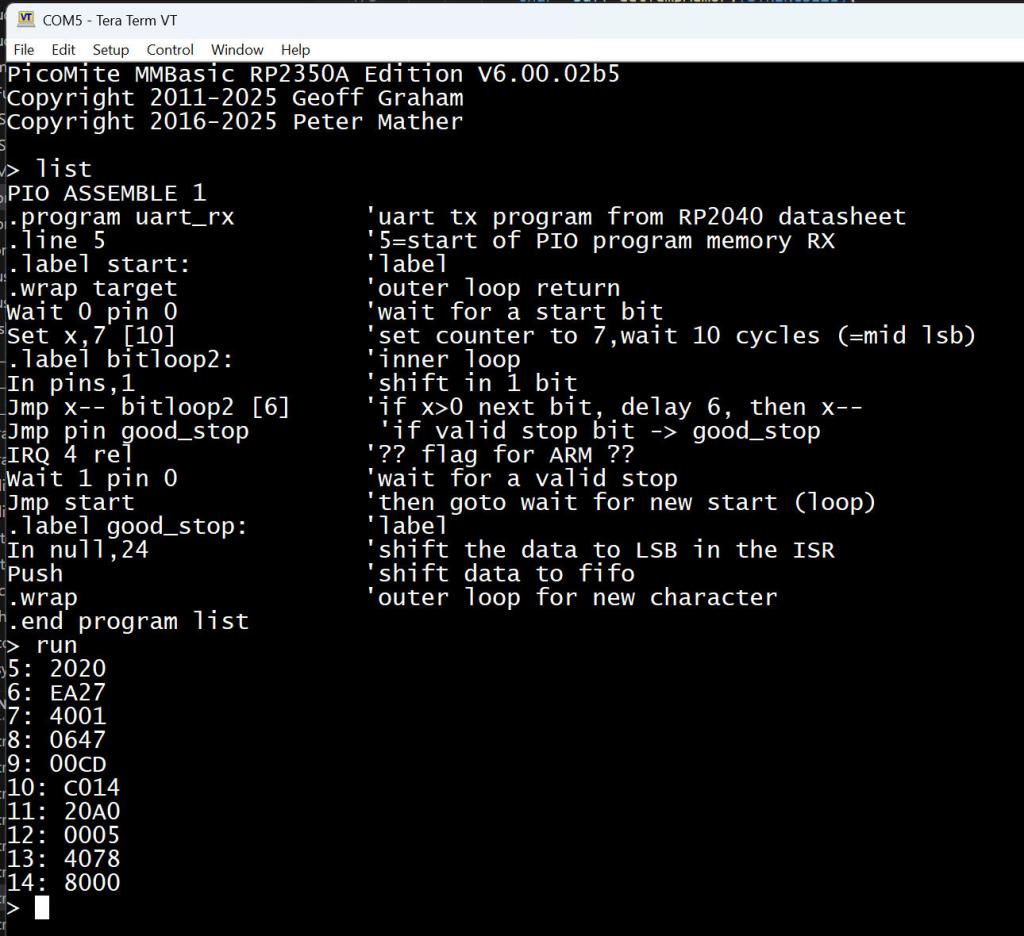

Another whackier approach with possible greater applications would be to develop a mechanism to initialise LONGSTRINGs from multiple lines:
DIM asm%(256) = """
 .program toggle
 .line 0
 set pindirs,1
 .wrap target
 set pins,0
 set pins,1
 .wrap
 .end program list
PIO ASSEMBLE 1, asm%()
But good luck getting Peter and Geoff to go down that rabbit hole.

I've thought of a way of doing this. There is one wrinkle that I can't see away round - labels - the syntax is the same as an MMbasic label.
My thought is to have a new directive
.label labelname:
If you are OK with this I can post a test version for you to play with

This is how it works. The PIO commands and directives are now actual commands in MMBasic but can only be used after the single "PIO ASSEMBLE n" and up until the ".end program" command. There is then a frig to allow commands starting with a ".". Internally they start with "_" which is allowed and the tokenizer converts them on input and the list command converts them back on output. Another frig de-tokenizes the symbols "-" and "=" which can appear in the JMP command. Then the code is trivial. For each PIO command a single function generates the associated PIO ASSEMBLE command

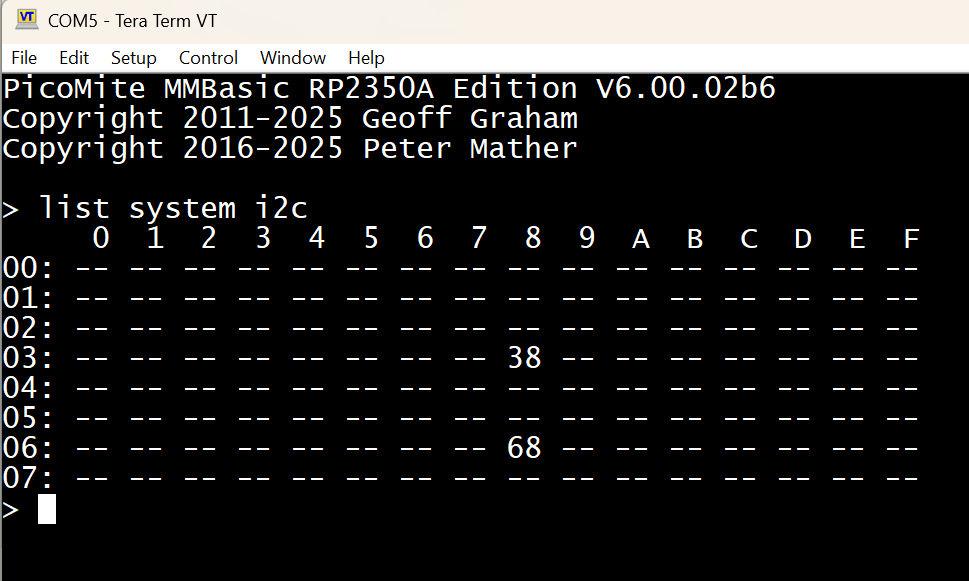

Includes support for FT6336 capacitive touch chip
OPTION TOUCH FT6336 IRQpin, RESETpin [,BEEPpin] [,sensitivity]
sensitivity is a number between 0 and 255 - defaults to 50, lower is more sensitive.
SDA and SCK should be connected to valid I2C pins and set up with OPTION SYSTEM I2C
TOUCH function works as before + TOUCH(X2) and TOUCH(Y2) returns the position of a second touch location or -1 if no second location is touched.
New commands
Support for all PIO commands as per post above. Note that labels required must be identified with the directive ".LABEL" in order to differentiate them from MMBasic labels
LIST SYSTEM I2C
Produces a display showing the addresses of all I2C device connected to the STSTEM I2C pins (another sneaky bit of embedded Basic)

  matherp said  V6.00.02b6 now available
LIST SYSTEM I2C
But there might be different slave`s SCL speeds...
My MMBasic 'sand box'
Posts: 12176
Posted: 03:35pm 01 Feb 2025
SYSTEM I2C can be set to 400 or 100. It's up to the user - see manual. Obviously set it to the speed of the slowest device. Nothing to do with this command
