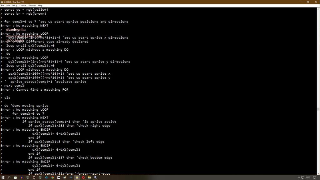

stanleyella
Joined: 25/06/2022
Posts: 2807
Posted: 09:14pm 08 Aug 2022
If I got 100 lines of code. please how to copy paste it,select all copy. then paste to teraterm and save run assuming teraterm is same com port as rpipico ie com 13.
copying to teraterm gives image
Posted: 09:23pm 08 Aug 2022
You probably didn't start by entering AUTOSAVE
You can either enter AUTOSAVE by the keyboard or as the first line of the code you are pasting
