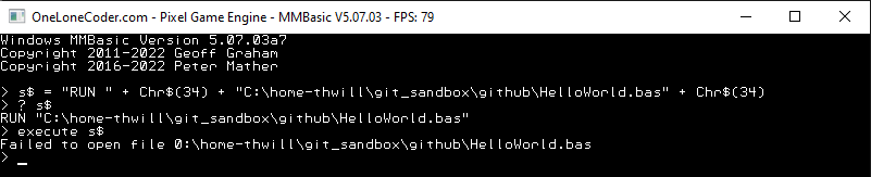

3. Weird EXECUTE sh*t, note the mysterious "0" at the start of the path it tried to open:

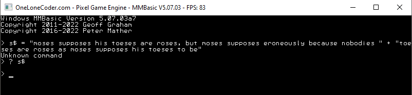

4. You should actively prevent the user typing a command at the prompt longer than the window (ideally sound the bell) instead of:
... or even better support commands at the prompt that extend over multiple lines (up to the usual 255 character limit).

Thanks for the reports - all trivial except 4. This is the same on all versions (certainly my ones) and is very difficult to trap - I'll think about it but can't see a sensible way at the moment.
On 2 it will return to the default font if in the default mode. If in another mode it will return to a defined sensible default for that mode. This is because after an error you need to know the error message will display which if, for example, you were using the font with only large numbers, it couldn't

This version will give a beep when entering a command at the command line as you type the second last character that fits on the screen or if you insert characters that cause the last character to be the second last one that fits on the screen. If you go past this the command will be corrupt but the firmware won't actually stop you.

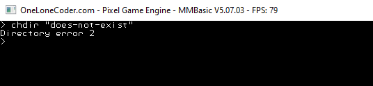

1. Setting OPTION DEFAULT PATH immediately changes the current working directory to the new default path. Is this intended? I was suprised.
2. CHDIR into a non-existing directory produces a "rubbish" error message:

  Quote  CHDIR into a non-existing directory produces a "rubbish" error message:
Fixed
