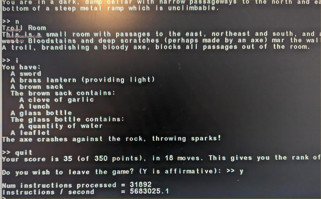

Posted: 07:15pm 01 Feb 2022
pa12
Last update for a few days
MMBasic.zip
lots of good file stuff
FILES command and DIR$ as per the PicoMite manual
mm.info(default path)
mm.info(filesize fname$)
mkdir
rmdir
tested with ZMIM with minor tweaks. zmim directory must be in default path
dim ss$(5) 'omit the length
Sub main()
Local i. old_dir$, state, s$
ss$(0)=mm.info(default path)+"zmim"
Edited 2022-02-02 05:19 by matherp

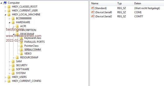

Now I use the registry.
   count = Registry::CountSubValues(#HKEY_LOCAL_MACHINE, "HARDWARE\DEVICEMAP\SERIALCOMM")
   For n = 0 To count - 1
     pName = Registry::ListSubValue(#HKEY_LOCAL_MACHINE, "HARDWARE\DEVICEMAP\SERIALCOMM", n)
     Port =Registry::ReadValue(#HKEY_LOCAL_MACHINE, "HARDWARE\DEVICEMAP\SERIALCOMM", pName)
     ;Debug pName+" ,  "+Port
     AddElement(myPorts())
     myPorts() = Port
     found = found + 1
   Next n
I can provide the registry details in more detail (in PureBasic) if required.

twofingers
Joined: 02/06/2014
Posts: 1785
Posted: 10:38pm 01 Feb 2022
  Chopperp said  ... Yes please Peter. That should be enough
Why?

Posted: 11:09pm 01 Feb 2022
Brian
As Twofingers has shown, the com port number can grow (especially when you have devices with serial numbers).
I started with checking a maximum of 32 to save time but users complained.
The registry method has no such limitations, but it can get antivirus crapware to get alarmed.

Posted: 10:35am 02 Feb 2022
  TassyJim said
Brian
I do realise that the port numbers can grow. I check them every time I connect stuff particularly when using MMEdit to see what magical number comes up. (Device Manager and/or Serial Port Monitor Prog)
What I wasn't sure of is if all the ports that Windows recognises will be active & usable under MMB4W or if there will be some restriction. I now assume that if I have 4 or more USB to TTL converters attached, that MMB4W will be able to use them concurrently (or simultaneously).
I didn't know that there was a limit of 64 ports. I thought that there would have been a limit but I didn't think it was that high.
I did wonder on occasions, how you determined what ports were available for MMEdit to connect to.
Peter is doing a great job here along with all you helpers. Thanks.
