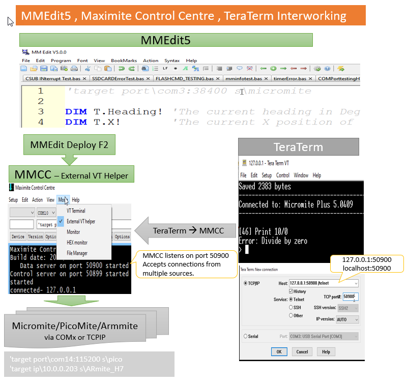

Here is a bit of a diagram I put together showing MMEdit, TeraTerm and MMCC interworking. I find it a very satisfactory setup, with MMEdit managing the code and using Teraterm as the terminal.
F4 H7FotSF4xGT
