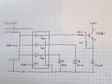

I can understand Bob's desire to use up the stock on hand but I am fashioned enough to reach for a TIP127 PNP Darlington.
Current price around $1AU and add 50c for the NPN driver transistor and a couple of resistors...
Posts: 9329
Posted: 08:08am 10 Aug 2021
Plenty of drive current (>50mA even with 3x 100mA leds lit) available from a UDN chip, Jim.
You only need a gain of 18 at most so a darlington is probably overkill. There may not even be 3 LEDs, only 2 (red/blue). A TIP32C should do it easily at less than half the cost. No driver transistor, just the UDN chip, 2 resistors and a TIP32C. That's all that's needed for a 900mA white and up to 3 100mA colours. All logic inputs into the UDN. All continuously rated. Will probably work with PWM too, if the frequency is kept down to something sensible.

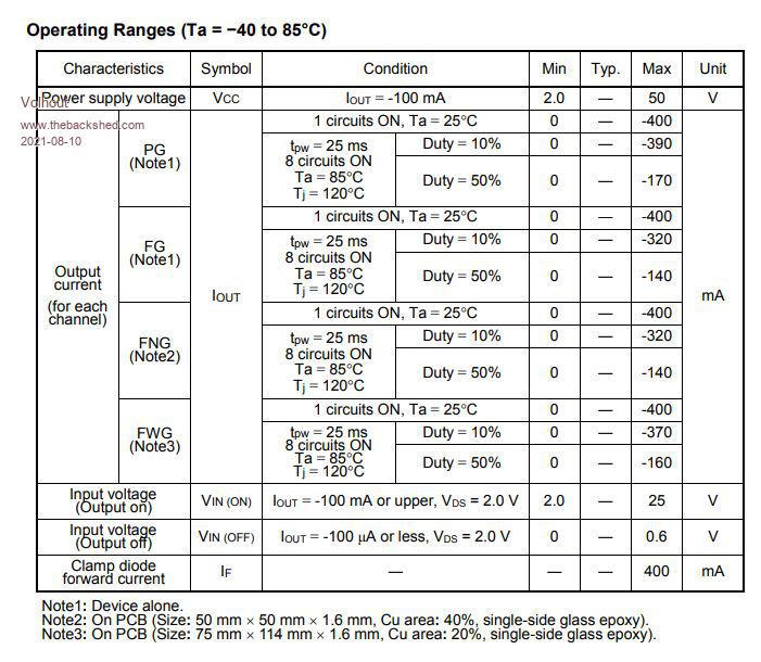

It appears that the UDN chip is no longer manufactured and is no longer listed by RS and Farnell. However, Toshiba have released the TBD62783A which is an excellent DMOS replacement with lower power dissipation. RS sell the through-hole DIP (PG) version for 8.65 UKP +vat for a pack of 10. You can get the TIP32C for 49p each. Ignoring postage, that's less than 2 quid +pcb for a complete driver package.
Edited 2021-08-10 18:31 by Mixtel90
Posts: 6254
Posted: 09:11am 10 Aug 2021
Nice chip:  TBD62783A
At 50% duty cycle it can handle 170mA per channel (PG package, through hole).
So a single chip solution seems possible.
Use 1 channel for each of the 100mA colors
Use the remaining channels parallel for the white channel (you can parallel mosfets).
Bob, this is it....
Posts: 9329
Posted: 09:31am 10 Aug 2021
OOPS! My idea of driving a PNP from that chip doesn't work as I'd originally intended, sorry. It should be an NPN as an emitter follower. I'd forgotten that it's a high-side driver. I failed...  :(
The turn-off resistor should be to the emitter of course (top end of load should be ok. Output leakage is very low and won't light the LED). Base resistor could be about 330R.  It just gives some protection to the chip output. Turn-off resistor, say, 10k. Luckily a TIP32C (NPN) is about the same price. :)
You still have  maximum total input current into the supply pin. You can't get 500mA from all 8 outputs at the same time, even if you could stay within the package power rating. They don't state that maximum current, but 500mA total would make sense for a single pin on a DIP package. Note that they show 400mA max output with one circuit ON.
I don't think you can get 900mA *continuous* through the pin under any circumstances (not without sub-zero chilling anyway :) ). You may be able to get 900mA *short pulses*, but that's not what's wanted.
Inputs are dead easy. Direct connection to the arduino pins. :)
