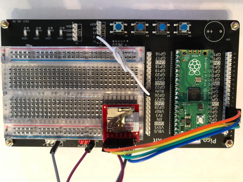

I've been testing my astronomy software using alpha version of PicoMite MMBASIC without any serious problems so far. Larger programs such as NPOE will not load and display "Error : The file/directory object is invalid".
Here is a picture of the PicoMite setup I'm using. Reset switch uses button K1. Includes a Sparkfun MicroSD breakout.
