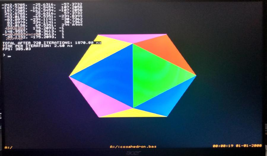

Very cool Vegipete
I copied your icosahedron data to my program. This is the result:
icosahedron.bas.zip

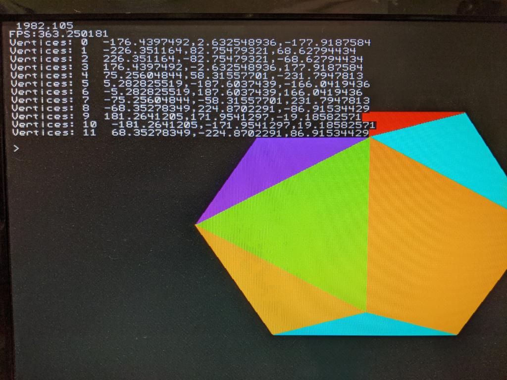

Joined: 13/08/2020
Posts: 669
Posted: 04:55pm 20 Nov 2020
Interesting. Although my program is slower than your guys, it does show that there might be some value in the face and vertex symmetry calcs that I put in.
I get 1982ms with the Icosahedron. However if I take out my symmetry calculations it goes up to 2302ms, showing that with primitives with higher vertex/face counts, it does produce a significant reduction in processing time.
Leo, I notice my 650 calcs are different than yours? Not sure why, but the end image looks identical.

I should have posted my vertex coords:
1517.073
Vertex coordinates at iteration 650:
-226.049588     -81.73546929    -70.80887545
-174.2594685     175.3899975    -40.80424503
174.2594685    -175.3899975     40.80424503
226.049588      81.73546929     70.80887545
-4.803232082    -200.1405105    -150.7106666
-78.76718797    -214.7664928     102.2941039
78.76718797     214.7664928    -102.2941039
4.803232082     200.1405105     150.7106666
-64.36396153     40.82022139    -238.7131961
183.7148904    -17.21920455    -169.5445017
-183.7148904     17.21920455     169.5445017
64.36396153    -40.82022139     238.7131961
My coords look similar to yours, PeteCotton, except maybe out by 1 iteration.
