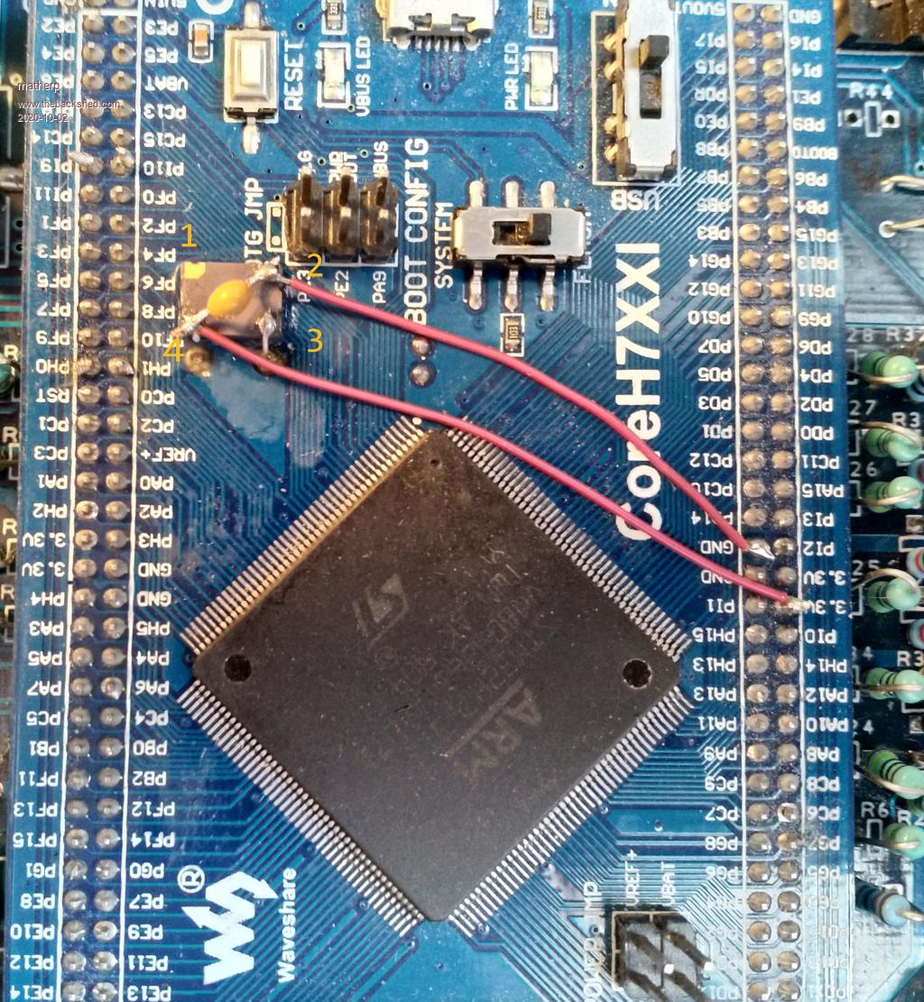

Posted: 03:44pm 01 Oct 2020
I am occasionally getting the dreaded "Error: System fault - check code" message when switching video modes.  MM.Info(Reset) is returning "Watchdog"
It seems to happen most often when switching between modes 10,8 or 9,8 to 1,8
I am running V5.05.06b14 on a 400MHz CMM2
-Carl
Posted: 05:40pm 01 Oct 2020
Thanks for the report. This suggest the PLL for the display is taking a long time to synch on your processor. I'll put in some more pings of the watchdog if I can find any obvious places that might need them.

Joined: 08/05/2020
Posts: 385
Posted: 06:15pm 01 Oct 2020
  matherp said  Thanks for the report. This suggest the PLL for the display is taking a long time to synch on your processor. I'll put in some more pings of the watchdog if I can find any obvious places that might need them.
I have the Waveshare boards with the factory crystal resonator installed.  I think their oscillator setup has too much "phase noise" or a slower rise time that leads to less certain timing on the inputs of the PLLs. I also get a lot of "Shimmer" in mode 9
I received my 8MHz oscillator modules, but I haven't had time to install them yet.  I was thinking to install the oscillators on the Waveshare modules to keep them "self contained"
Edited 2020-10-02 04:17 by Sasquatch

  Quote  I was thinking to install the oscillators on the Waveshare modules to keep them "self contained"
Edited 2020-10-02 19:08 by matherp
