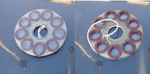

For the readers who like pictures, here is the stator so far.
The coil centre holes and the final encapsulant glass layer and mounting holes are still to be done.
The 12 magnet centres will be on a 220mm dia circular arangement.

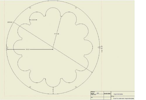

For those who are puzzled by what the magnet positioning template will look like.
Too hard to make by hand!
Gordon.

  GWatPE said   For those who are puzzled by what the magnet positioning template will look like.
-- here was the image --
Gordon.
Hi Gordon,
You are considering to keep that template for final product (fixed with screws)? I think it will be an insurance against centrifugal force ...
If the material is plastic, then can be made with a fretsaw?Edited by vasi 2009-03-29

Posted: 12:03pm 28 Mar 2009
Hi vasi,
the template will be used only to accurately position the magnets on both disks. The flux and some epoxy glue and maybe some carbon fibre will fix the magnets to the plates. The closed arrangement of the design will help with plate rigidity, so the magnets will stay put.
I am prepared to make parts by hand where necessary, but the acccuracy of the placement determines output wave shape quality and balancing of the rotor.
It would also cost more!
Gordon.

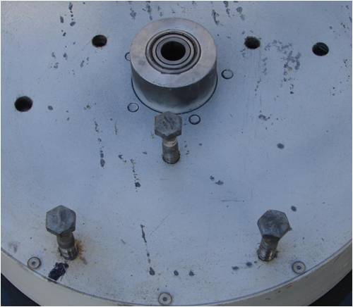

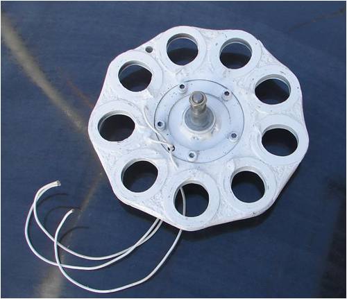

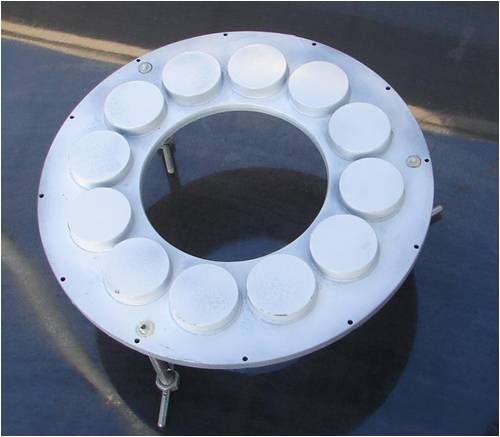

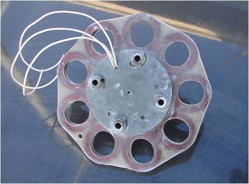

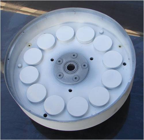

Just an update on my new AxFx alternator. The machining of the dual rotors and the bearing housing and stub axle and the ring has been finished. Zest engineering came up trumps again. Thanks windman.
I have now trimmed and fitted the stator and am finishing the tedious process of magnet placement and encapsulation and environmental sealing of all the metal.
The initial testing shows a very electrically stiff alternator. I will be checking the output voltage vs rpm in the next phase. The shorted winding test was like trying to stir peanut paste straight from the fridge.
I will be posting some more photos. The encapsulation process has ended up with fridge white as the colour, with a zinc undercoat. The waterproofing will be 2 layers of a 2pak epoxy finish on all interior surfaces.

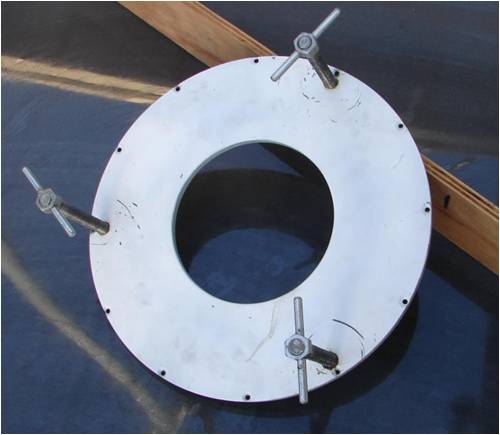

The jacking system allows relatively easy separation of the dual rotors with safety. Photos should help show things.
This machine has been wound for connection to a 24V and 48V loading, so I still have to work out the capacitor arrangements for optimum loadings. I want the low end power to charge my 24V battery, and the high end power will be diverted directly to the 48V battery and grid inverter.
Most of the average power is in the 24V area, but the high end power I still want to harvest. I do not want relays and switching systems on the windings. The present stator has no options in this way, as it is internally wired in star with 3 series coils per phase, with 3phases.
I do intend to log this mill, with possibly a suite of sensors and a radio transmission link from the mill head of stator temperature. Some benefit has to come of the work to date from the super piclog and battery logging systems I have made.
Gordon.
Posted: 11:12pm 16 Aug 2009
Some photos of the different sections. These are progress shots prior to final environmental sealing.
The finished items are not much different to the CAD piocs presented prior. The ring is a 12"nom pipe. The unit is 2 1/2" thick.
The pics are pretty self explanatory.
Gordon.

How far do your jacking bolts raise the rear rotor before the magnetic field is clear ?
Posted: 01:34am 18 Aug 2009
Hi fillm,
The jacking bolts are 100mm long.
Gordon.

I have to say that is a sexy looking stator. I'm pretty keen to build one of these, but it will have to wait until I have moved into my new place.
