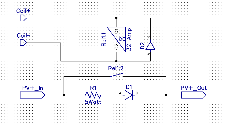

An external relay module would be the most reliable, something like this:
The contact rating being the determining factor, I have used these relays before and they seem reliable 80 amp , 60 amp .I would be a bit wary about the ratings of some relays on Aliexpress, but that manufacture seems to make quality stuff.
The resistor allows pre-charging of the electros to prevent the contacts burning up. CPU should turn off PWM so, so no current load prior to opening at night.
Mike your question about back feed current, not much... a 60 junction panel (24v) and 50v battery has say 3 series panels for mppt = approx 100v and 180 reverse PN junctions applied across the 50v battery, so their will be some 10's ma leakage, probably wont be noticeable on a large bank.
