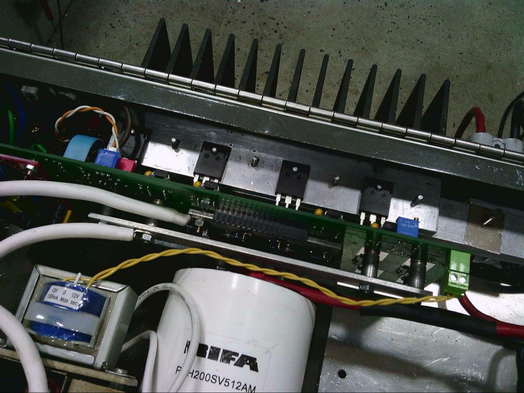

Like this, but with much thicker angle.
I like the layout of them better that way.
I broke a tap inside a heatsink once, jeezus you should have heard me go nuts, it was the last one on the big heatsink of a Madinverter, so 12th one.
I had to cut a bit off the bottom and start all over on another line of 12 tapped holes.
Screwing the fets to that angle could probably done with pan head self tappers with a spring washer too.
That would be even easier than bolting to the angle.

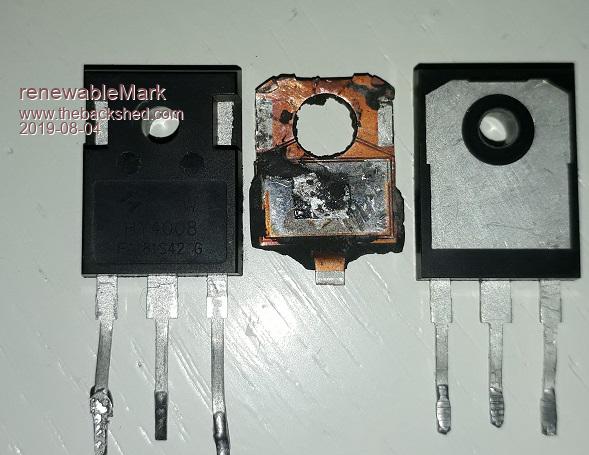

I just smashed apart a dead fet (4008).
So inside it is made of a fairly solid bit of aluminium which is connected to the drain, the front seems to have a layer of crap where the shiny bit is and the gate and drain connections sit on top of that.
So that black plastic layer at the top where the mounting hole is has no purpose?
It provides a very useful insulated sleeve between the drain and the screw when you wish to run the heat sink grounded.

the only different between the hy4008-B-P-W is the package case and heat dissipation. Just cracked open a hy4008B for fun.
Hy4008b - 345W max
HY4008P - 345W max
Hy4008W - 397W max

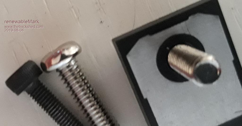

Got a 4.2mm drill bit from buggerings.
Silver bolt is a 4mm, black one for comparison is 3mm.
Fet has been drilled 4.2mm and shows plenty of the plastic insulation material is left.
Cheers Caveman Mark
Off grid eastern Melb
Posted: 02:11am 04 Aug 2019
4mm screw (just) fits through a mica insulator, so it all looks good.

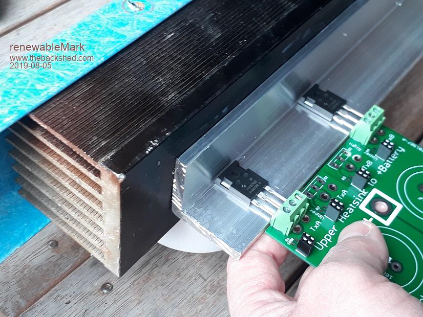

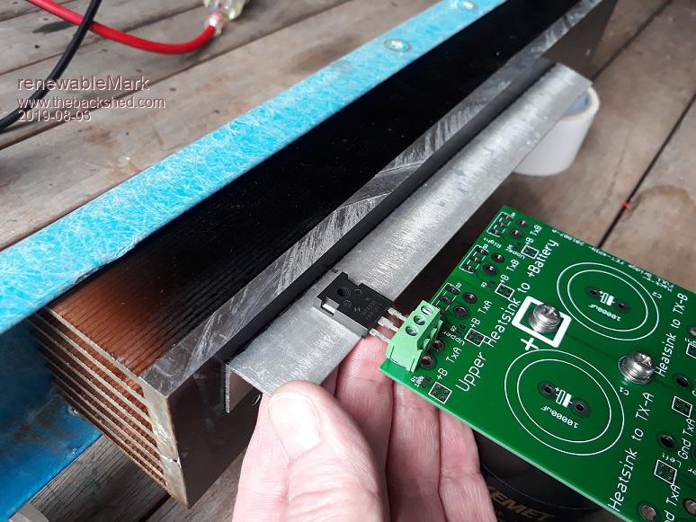

Got some 6mmx40mm.
will lay it like this, that will allow good access to the bolts and have the fets close to the main heatsink.

Posted: 02:55am 05 Aug 2019
Very nice Mark.

Posted: 03:28am 05 Aug 2019
That Aluminium angle has a cross sectional area of 444mm^2, equivalent approx to a 200mm^2 of Copper. Well and truly good enough for a buss bar without needing to take the heatsink into consideration, no need to strip the anodising off etc.

Funny you mentioned that Andrew, I was thinking about doing that.
I'll still put a copper bus bar underneath as it will be a level platform for the caps to sit on. I ended up buying a whole length as it was $20/metre or a 4m length was $40 odd. So there is plenty to use.

Hey Mark, those mosfets have a thermal copper contact surface area of approx 180mm^2, so a piece of alloy bar 6mm thick has to be 30mm long to have the same area pressing against your big finned HS. Allowing for thermal losses in the 2 junctions between the mosfet and the rt angle/HS you will need prob 40mm length of the Rt angle per mosfet. So provided your mosfets are >80mm apart its a good solution.
Mike
Posted: 02:19am 07 Aug 2019
That is true if you wish to push the whole thing to the absolute thermal max.
One solution is to bolt the mosfets down onto a copper bar (which Mark already has). Then bolt the copper bar on top of the aluminium angle. That will spread the heat a lot better into the aluminium.
I had this problem when I bolted mosfets down onto a large 3mm sheet of aluminium. The thermal gradient directly under the mosfet was rather higher than I would have liked. A slab of copper made a very worthwhile improvement.
