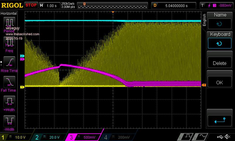

@Mike, can you measure the DC current the inverter uses during startup? and another again at restart? see if its different.
Typically the transformer will make a little more sound when loaded, obviously yours is not loaded at startup, this should show when the start up current is measured, should be the same when running.
Is there is a current rise when the grunt happens.

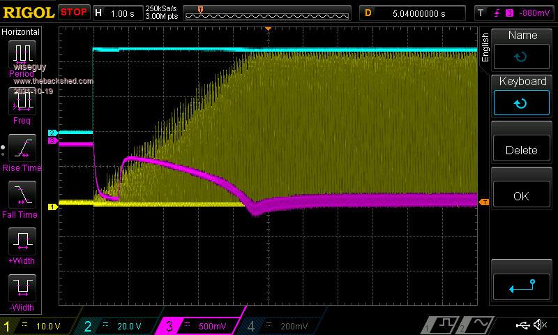

Hi Aaron, (late reply, busy day...) yes there is a bit of extra current. Because I have 40,000uF the actual current from the power supply is a bit filtered.
Blue is the 48V supply
Yellow is switching power envelope
Purple is supply current through 0R22 resistor in series with minus of 48V supply.
The above picture shows the extra current drawn at the end of ramp up when the grunt happens. The initial dip (increase) of current at the beginning of the trace was the capacitors charging after turn on, then an increase of current until overshoot & grunt.
Ramping down then Run switch set to on again before ramp down finish
You can see the current lessening (rising - its neg current, more = less lol)
Then the run switch is set on again and the new ramp up begins.
This time no overshoot (undershoot - sheesh) of current.
This happens 100% of the time when starting from stopped or restarted during soft stop. It is not an occasional grunt or no grunt it is 100% predictable.
Last point of interest the current is slightly higher after the grunt - no yellow trace visible, after the restart yellow trace is just visible - I will go measure actual current soon to see if it really is different.
Edited 2021-10-19 20:45 by wiseguy
Cheers Mike

Peter, I will answer your longish post by agreeing with essentially everything you said.
But we diverge slightly on one point. Why does a cold start always grunt and draw the extra current when an interrupted (truncated) soft stop occurs and is set to ramp up again from zero it never overshoots and grunts.
These two cases as stated to Aaron are 100% reliable & predictable.
I hear that you are running the same section of code (you didnt actually say those words I think) so it should not be any different - but it is & I am baffled at the moment. I havent given up - when I find something I dont understand it rattles me - everything happens for a reason sometimes the reason can be very elusive.
I don't change anything in my hardware except for the position of the stop/run switch which goes to the nano.....
Keep smiling
edit: re looking at the above pictures it appears the ramp up of current was a little faster ~ 3 to 3.5 sec compared to the ramp of the restart ~ 3.5 - 4 Secs from approx  the same starting level of current - is that a hint ? The yellow envelope also reflects a slightly faster ramp up on the grunt trace.
By the way when I restarted after one partial ramp down the inverter started a very scary ~ 400-600Hz very loud Buzz - I thought I had fried more FETs but a power down and not being able to measure any shorts it restarted fine again - another hint ?
Im not blaming your code at all, just trying to state objective facts as they appear/happen in case it might lead to an answer or subtle explanation.

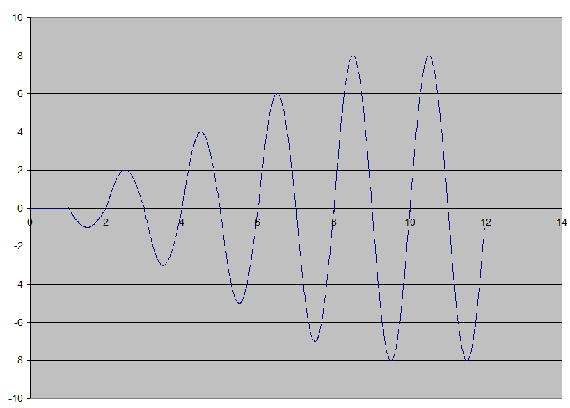

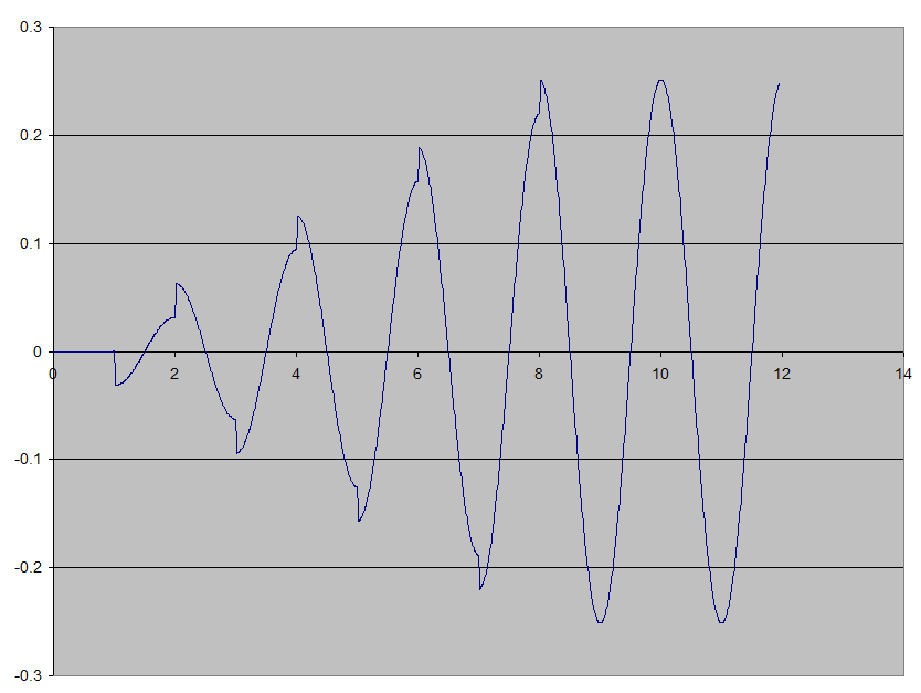

  poida said  Further to the hum during slow start:
There is no way to increase the flux during slow start without putting more + or - flux compared to the other. There has to be more of + or - at any time during the ramp up period. Otherwise there will be no ramp up.
My thinking on this differs a bit from yours - maybe I'm barking up the wrong tree - I sometimes wonder if I'm even in the wrong forest.......
I have always said that for a perfect balanced sinewave, each 90 degrees of a 360 degree waveform must be exactly equal.
The only reliable way I can see to do this is to only create a look up table of 90 degrees and then to fill in the other 3 quadrants with a copy of the first 90 degrees - obviously reflected/inverted as required to resemble the 360 degree sine wave.
Next if increasing or decreasing the sine level, would be to modify the whole 360 degrees with a fixed operator/modifier, again so the contents of the 4 quadrants have been changed exactly the same as each other.
In this manner each 180 degrees of 360 degrees adds and minuses exactly the same energy & flux leaving a net flux of zero in a perfect world for every 360 degree set. This is true regardless of constant amplitude, ramping up or ramping down if the same rules are applied.
It is easy for me to write this but creating the code that does this may be easy, difficult or next to impossible to implement it but its the only way I can see to avoid flux wandering, is to micro manage/control each set of 360 degrees.  If I could write code this is what I would try to create - maybe not exactly as written above but I needed to paint the picture of how it would work in practice.
When I said leaves a net flux of zero, I conveniently ignored hysteresis - there will I think always be some flux remaining until the next 180 degrees modifies it, but I don't think this changes the principle of its function, as it always starts and finishes each 360 degrees from a non zero flux.
Edited 2021-10-19 23:50 by wiseguy

That is why it doesn't look like an exponential capacitor charging curve. This little anomaly should help to emphasise that you need to question everything you are seeing in detail to ensure you really understand what is happening.  My focus was what happened from the beginning of the ramp, not before.
The last piece of the puzzle for extra clarification - why does the 48V suddenly jump on the blue trace from zero to 48V. Well mr clever decided to use what was the input 48V to the solenoid normally, as a convenient trigger and monitor point for the 48V as when the solenoid closed after setting the run switch to run when it went from open circuit (where the 48V supply is usually attached) to the 48V now applied to what is normally the 48V output side.  Clear as mud hey......
If this all looks like double dutch just tell me and I will re-attempt  to explain in better engrish.

I made a simplified graph of the ramp up voltage as commanded by
the code in the nanoverter.
7 half cycles from zero to full voltage, in this case 8 units.
It looks smooth doesn't it.
But it's not.
Each 1/2 cycle, the peak increases by one.
The increase is made when the curve is crossing zero,
just as in the nanoverter code.
It has to increase sometime, somewhere in the curve or else there will be no ramp up.
Below is the rate of change of voltage at any one time.
(the derivative)
I think the inverter output when unloaded is best modeled as a reactive load
and so there is some inductive component.
Inductors are sensitive to rate of change of voltage.
Look at the large changes of this curve at the peaks.
They coincide with zero crossing voltages of the first graph
This is when I apply the increase in amplitude or voltage.
I suspect these rapid changes in voltage change rates induce the growl.
I could modify the firmware to gradually increase the voltage over the 200 wpm
cycles of each half wave. This will remove nearly all of these sudden peaks in change rate. Maybe no more growl?
