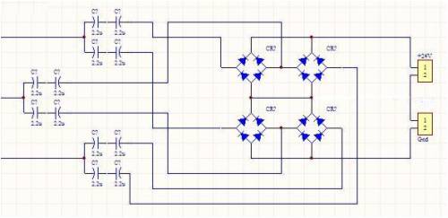

Posted: 06:09am 02 Dec 2008
Hi Jarbar and phill,
here is the basic low rpm/power cut in schematic with caps. This will halve the effective mill cutin rpm. The low end power of approx 5-30W will be gained, where none would normally be available. It is assumed that the usual 3phase rectifier would still be connected directly to the battery, so upper power levels would not be changed much. If the caps are too large, the impedance will be too low and the mill may stall. The formulae Z=1/2piFC can be used to check the cap loading.
I have used 2 x 2 bridge rectifiers. There are a total of 12 caps for a voltage doubling function with polarised caps.
This simple mod will allow the mill to be closer to ideal, where if it spins, it produces current to the battery. No switches/winding changes etc. This will even work on chinese windmills and axial flux mills. There will be some diode loss on a 12V system.
Gordon.
PS edit. As has been pointed out by Gill, in a subsequent post, there is no connection between the rectifiers and the centre connection of the battery.
Edited by GWatPE 2008-12-14

Posted: 09:49am 02 Dec 2008
So, lemme get this straight..... after years making dc/dc converters, pic programming, double sided circuit boards, ground planes and mosfets............. it comes down to a few skungy caps and some diodes.... how does it feel
Well done Gordon, It seems you have tied up the last loose ends, and have defined a simple eloquent solution to what has been very difficult problem.... matching the load.
Well done.
This should go along way to clearing up the benches there.
Some of us have too much wind (I blame the beans), too big a prop, and too small a battery bank to require this solution, (we'll see how much the new EV uses yet), but most will benefit from your research.... if they want to improve their systems.
Many a good mosfet has laid down it's life in search of the perfect load matching device, only to find that they have been beaten by a humble cap and diode array.... strange world really.
At one stage I had a great appetite for a high tech solution, but since building my mill, and seeing what potential it had to destroy all things silicon (except for the diodes), the high tech road has lost it's appeal.
Furling is never going to tame the mill all the time. Overcorrection will always pull many kilowatts for very brief moments, and will test any circuit to the limit.
This simple agglomeration of caps and diodes seems very able to handle the transients that I have worried about.
...........oztules

Posted: 11:45am 02 Dec 2008
  GWatPE said  This simple mod will allow the mill to be closer to ideal, where if it spins, it produces current to the battery. No switches/winding changes etc. This will even work on chinese windmills and axial flux mills.
Hi dinges,
The voltage cutin boost type arrangement as shown in the schematic above will work on low polecount alternators as the capacitor sizing will be relatively modest to still obtain useful benefits. The F&P can however benefit across the full output power spectrum. No 1 should miss out on some benefits.
Oztules has commented above, I could have saved myself a fair bit of effort with the boost maximiser, as the caps pretty well cover this function.
I have another similar concept that does the reverse function, that is take a series string of batteries and convert this to a voltage at the single battery voltage, without any transformer. This will have to wait another day as it is not directly related to this thread.
