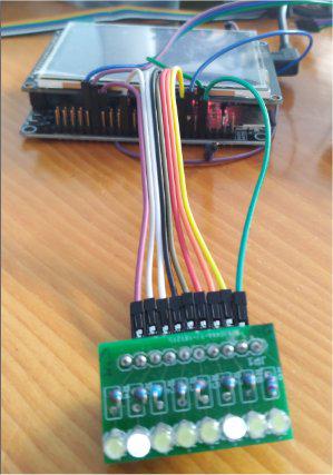

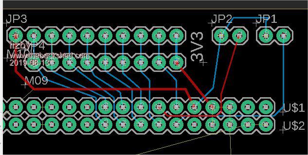

I'm baffled by a problem on a PCB I designed for the F4. Among other things it is set up to read 8 DS18B20s on pins 1,4,5,7,15,16,17,18.
I tested each of these pins successfully with a single DS18B20 3-pin module with built-in 4K7 resistor.
I soldered up my board with a bussed 4K7 resistor array. All the temperatures read fine, but I get "SD card not present" if I issue the FILES command. I tracked it down, and if I don't connect pin 7 (PC13), the other temperatures work and the SD card also works.
I went back and checked with the single DS18B20 module. Each TEMPR command works (pins 1,4,5,7,15,16,17,18), and FILES works after each one.
I wondered if it might be a power draw, but it sits between 65 and 69 mA.
I can find another pin to use besides 7, but I wonder what the reason is for this behavior? (I see that pin 7 has for "Function" "Digital, 3mA total for PC13-PC15", but I'm not sure how this would be related.)
Edited 2019-08-13 07:46 by lizby
Posted: 08:39am 13 Aug 2019
  Quote  but I wonder what the reason is for this behavior
I suspect some sort of crosstalk internal to the chip between PC13 and PC12 (SD-CLK). I had huge problems getting the SDcard to work reliably. Eventually I had to use 1-bit SDIO rather than the faster 4-bit and slow the SDIO clock as I was seeing this sort of problem. Could be an issue with the ST driver or, as I suspect, some sort of hardware crosstalk.

I can confirm lizbys problem with the 1-wire communication on PIN PC13. I use a DHT22 and sometimes I have no connection to the sd-card. If I disconnect the DHT22 the communcation to the sd-card directly works.
Greeting from Germany
Juergen
Posted: 04:26pm 13 Aug 2019
  SWA-Guy said  I can confirm lizby's problem with ... PIN PC13
  matherp said
  lizby said  but I wonder what the reason is for this behavior
Thanks for the confirmation (and welcome to the forum) and thanks for the explanation (even if the root remains a mystery). Mysteries do abound--I'm glad MMBasic has relatively few of them, thanks to the efforts of Peter and Geoff.

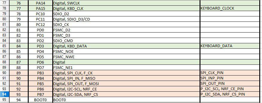

When I hook LEDs up to pins 92,93,89,91,87,84,77,67, two--89 and 77 (PB3 and PA15)-- are on weakly. They respond normally (with brightness corresponding to the other pins) to, e.g., PIN(89)=1 and PIN(89)=0.
What am I seeing here with these pins? After setting them low, "NEW" brings them back on weakly.
Are all of these pins OK to use digitally? Is there a way to have 89 and 77 not doing whatever they are doing upon power-up?
Edited 2019-08-25 01:05 by lizby
Posted: 10:07pm 24 Aug 2019
PB3 and PA15 have 10K pullups on the PCB. Remove R1 and R3 if you don't want them
Posted: 03:03pm 25 Aug 2019
  matherp said  PB3 and PA15 have 10K pullups on the PCB. Remove R1 and R3 if you don't want them
Thanks. That did the trick.
