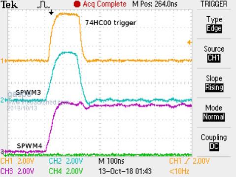

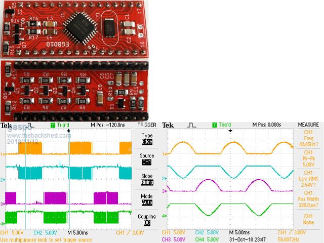

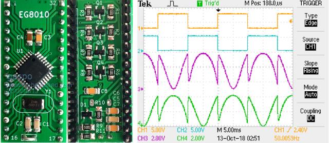

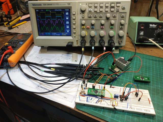

I have now received some adapter boards so I assembled one and tested it.
First I performed the same tests as Wiseguy and Poida did with unmodified adapter board and have observed the same ~200ns shoot through on SPWM pins when coming out of IFB or TFB error condition.
With the new adapter board the problem did not occur so it looks like the output transistor do their job.
The reference voltage with TL431 works fine as well producing 4.96V on the VREF pin.
