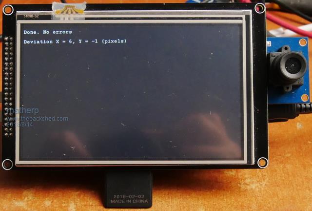

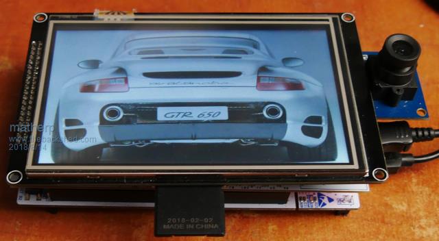

Posted: 11:47am 14 Aug 2018
Your card and display arrived safely and the news is good or bad depending on how you look at it
The display and SD card work perfectly on my Nucleo and daughter card. Suggest you look at things like power supply, common ground between supply and USB etc.
The touch implementation on the Sainsmart seems to be a problem. The issue is noise on T_IRQ which looks like a mechanical switch bouncing. What they have done I have no idea. However, I have put some software debouncing into the calibration code without impacting normal operation and this makes it just about workable
2018-08-14_214613_Armmite1.3.zip
Edited by matherp 2018-08-15

Posted: 04:11pm 14 Aug 2018
Press each calibration point for about a second and the point should then step on.
TrevorH

TrevorH
Joined: 06/04/2018
Posts: 145
Posted: 08:47pm 14 Aug 2018
I have found my Stupid mistake with the touch, I was setting touch to 114,115 instead of 56,123, which is why it was totally unresponsive,
Right back to business, pictures load on small and large screen as they should.
Touch now works but not 100%, I still get calibration error of x=49ish and y=98ish,
it varies on different runs but only by a few pixels, so it IS better.
I've also tried loading elfs with cube and hex with ST-Link with no noticeable difference.
I think we have moved forward.
