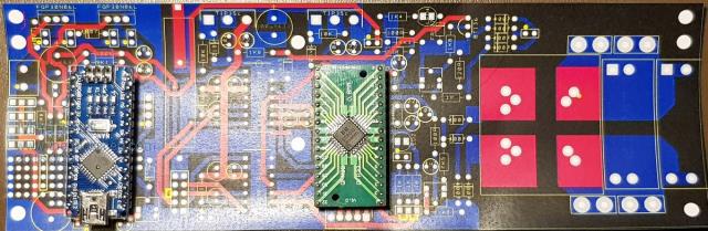

Posted: 11:22pm 28 Apr 2018
Here is a mockup of the control board printed on paper with the 2 microcontrollers.

Posted: 11:42pm 28 Apr 2018
Any chance you can attach a hi-res version of some form to a post?
Phil.
Posted: 12:51am 29 Apr 2018
I can't post hi res images due to file size limitations, which board are chasing Phil I can do a PDF. If it is the Charge regulator your after I am working on that and it ATM, once I have a decent version I will post a PDF, I am hoping that will be later today.

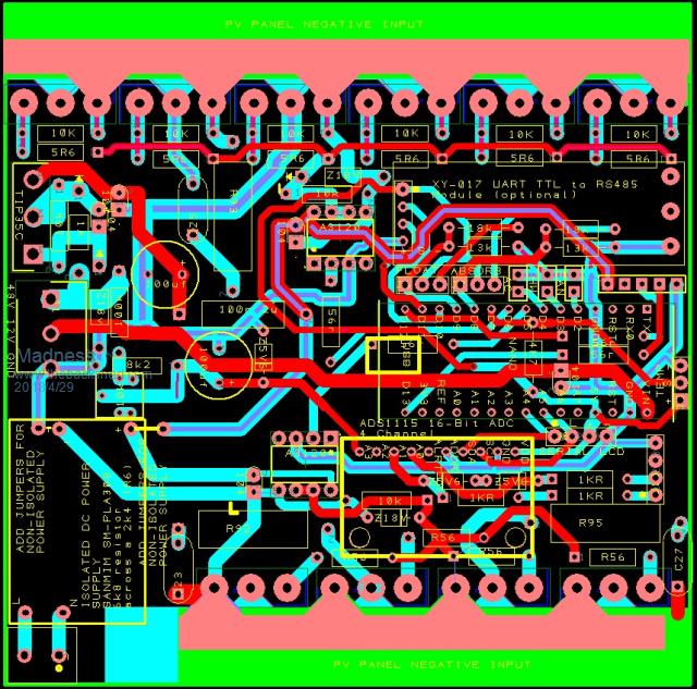

Posted: 05:16am 29 Apr 2018
To post a link you then have to host it somewhere, I can't be bothered doing that.
Been working on the GTI regulator, I will get a small sample of these made, not ready to do any more until I have actually tested it. If there are any Masochists out there that want to try the Beta version let me know, no guarantees though, it is experimental.
Posted: 10:13am 29 Apr 2018
Gary, looking at your latest control board version on the previous page I'm wondering why you have not thought to lay out the transformer, mains cap & 4 rectifier diodes section so that that end could easily be trimmed/ snapped off from the control board. A pair of 2 pin headers is all that's required to connect the 12VDC to the control board, wherever it is located.
Mechanically that makes a lot more sense to me and electrically it has the big benefit to be able to locate that mains capacitor(s) very close to the toroid secondary, where it belongs.
This is what I have and never had any regret doing it that way.
And, out of curiosity, what is that grid of PCB holes next to your nano socket used for?
Posted: 10:40am 29 Apr 2018
Klaus I am sorry you don't like that way, but then maybe I am not.
Posted: 11:35am 29 Apr 2018
  Madness said   Klaus I am sorry you don't like that way, but then maybe I am not.
That has nothing to do with "liking" at all.
You may remember that long discussion we had here, back when your and my inverter played up regularly, about the function of that mains capacitor.
Our resident engineer, warpspeed, recommended that it would be most beneficial if resonance at 75Hz between the toroid secondary and that capacitor could be established.
That resonance is very unlikely with long power leads to that capacitor....

Hey Mad, I’ve sent you a PM regarding boards.
For the GTI regulation of multiple strings does the FET for each string need to be isolated from one another?
What I’m considering is running all my solar strings to one “regulator” box then off to the respective GTI. Most likely a ex 3kw Areosharp box, I’d like to mount the FETs to the nice heat sink.
Cheers Shane.
Posted: 12:09pm 29 Apr 2018
Hi Shane,
Oztules has had no problem with the Aerosharps having all the negative sides of the panels in common at the MOSFETs. However I pulled a lot of hair out trying to stop mine from shorting FETs, the solution turned out to be keeping the Drains of each channel to the GTI isolated. The source legs are in common and that is fine but for some white mans magic reason it does not work with my Zeversolar GTI having the Drains connected. Since I fixed that it has run perfectly for the last 4-5 months.
The new version of the regulator is basically my first version with that modification and a lot of other bits added including a 16 bit ADC to get high-resolution voltage readings for the battery voltage and also for a battery current sensor.
Have a look at Oztules thread on the GTI regulators, I think he had the drains connected to ground and did not have an isolated power supply. With the HF modern GTIs you must have the DC from the PV completely isolated otherwise you will be ordering a bottle of electronic smoke to put back in.Edited by Madness 2018-04-30

Posted: 12:42am 30 Apr 2018
I'm a bit lost without a schematic Madness, are you using the SPI pins? I recon a little radio module would go down well as you could house the PV array in a seperate building and still have an accurate battery voltage reading.
Posted: 01:31am 30 Apr 2018
I am planning to use RS485 for communications and have the spot for the module on the PCB. RS 485 works up to 1200M via a twisted pair and is considered to be very reliable. My plan to have the same PCB with different code loaded to act as slave units. The master located near your batteries would send instructions to the slave units connected to other GTIs connected to your AC power to control their output as required.
For myself I will be setting up most of my solar equipment in a shed and later building a house about 200M away. I will then put more panels and a GTI on the house with a regulator as described above. This system could also send commands to turn on a HWS and other loads like water pumps as excess power is available.
Posted: 01:33am 30 Apr 2018
I am using a Ferrite ring for the choke now and have not found any problem with having the transformer and capacitors on the control board.
