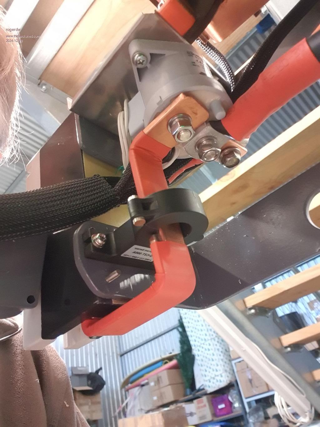

rogerdw
Joined: 22/10/2019
Posts: 957
Posted: 07:45am 28 Dec 2024
Good to see the progress Aaron.

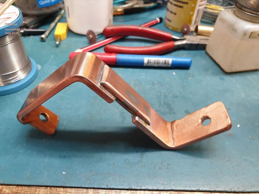

I used copper bar where I could  ...  especially for the short lengths where it would have been hard to get short cables to bend into place.
I do like Phil's idea of stacking strips together  ...  bit easier to handle and flexible.
The battery cable and Solar Charge controller leads come in via cable to the Kilovac  ...  then copper bar to the cct breaker  ...  and from the cct breaker to the main busbar
I got a bit carried away I think.  But it does tuck in nice and neat  ...  and it certainly doesn't get warm.
Edited 2024-12-28 17:54 by rogerdw
Cheers,  Roger

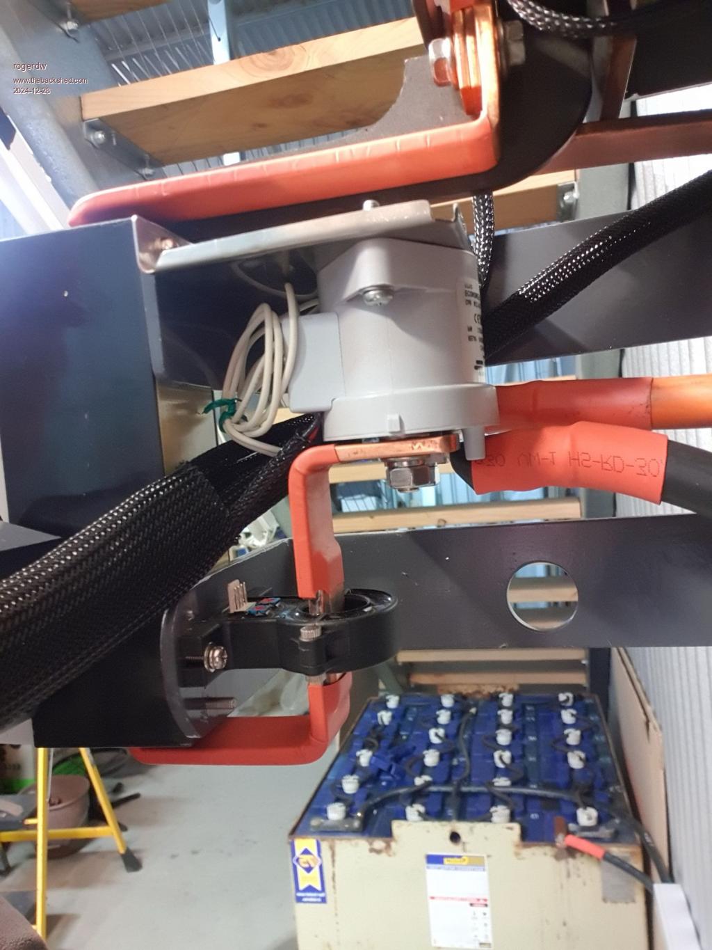

Revlac
Joined: 31/12/2016
Posts: 1310
Posted: 12:53pm 28 Dec 2024
Yeah I would also have preferred multiple layers of copper strip as its flexible, unless someone has soldered the end solid with a hole drilled through (pined) makes it hard to bend and will kink, but looks really good with shrink wrap over it.
I may have some copper sheet in an old transformer but would have to cut into strips, will have a look later.
I will be using the large flexible cable and crimped terminals going out to the chokes and transformer, but inside its such a short distance the copper bar seems to be the easy goto.
That looks Excellent, very neat Rodger,  that's about what I was thinking of, mostly trying to re purpose what I have on hand there is a few different size's of copper bar salvaged from large transformers, there is also a way of getting a 90 degree bend the other way by putting a 45 degree crease and fold over itself, I had success with thin copper like that but have yet to try some of the thicker stuff, will see what happens.
Thanks guys for the encouragement and ideas.
Cheers Aaron

The thick copper bar bends easily with a bench-vise and metal bending adapter, I bent the DC input copper bus bars in the Dual inverter and the main battery bank bus bars with one.
Bryan1
Joined: 22/02/2006
Posts: 2297
Posted: 01:48am 29 Dec 2024
Bending thick copper bar is pretty easy   now using a oxy torch just heat say 10mm each side of the intended bend red hot then let it cool which will anneal the copper making the bend nice and easy. Do it in a vice then by tapping with hammer will work harden it and just rinse and repeat for the other bends.
rogerdw
Joined: 22/10/2019
Posts: 957
Posted: 06:44am 31 Dec 2024
I'm no metal worker I'm afraid  ...  I just stuck those bits in the vice and wacked them with a big hammer. Wasn't hard to bend either, I was surprised  ...  but I'll keep that suggestion in mind for next time thanks Bryan.
Cheers,  Roger
Revlac
Joined: 31/12/2016
Posts: 1310
Posted: 07:14am 11 Jan 2025

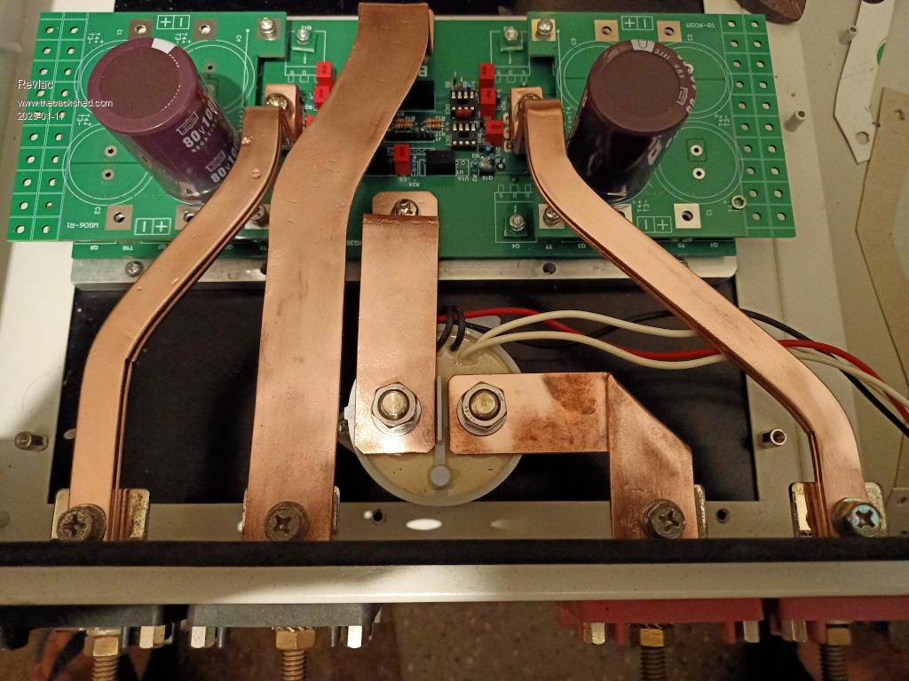

Well it was fun, I have done plenty of metal work, some shrinking and stretching on the 25mm copper bar and it can be bent, the other 2 (transformer bus bars) are 1/2 by 1/8 (really old) imperial copper bar doubled up so its quite thick, still needs a few miner adjustments but should be ok.
Now I have to find the heat shrink, its on a shelf last I saw it.
Cheers Aaron

Great job Aaron, that's coming together nicely. There's something about nicely shaped raw copper that appeals to me.
It always seems such a pity we need to insulate it, and that it goes all tarnished after a while. I'm sure there's a few different clear coatings that would protect it but a thicker heatshrink is still probably more of a protection from accidental shorting.

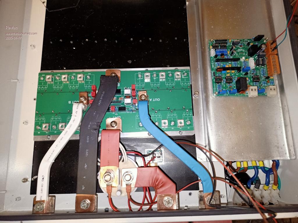

Yes its nice all polished up but doesn't stay that way,  (I have a few old engines that have brass and copper parts looks very nice) I was looking at your build photos last night (very nice) reminded me of the old 300A 3 Phase Breaker panel I have.

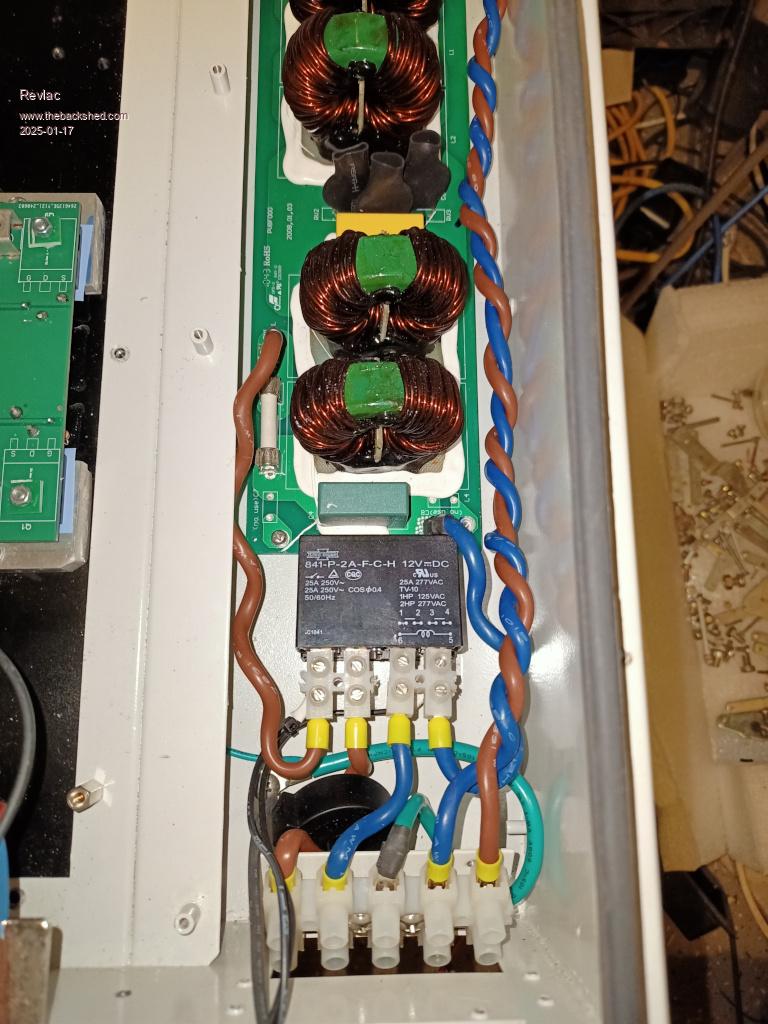

I have the bars covered in heat shrink now and build is progressing nicely when I get time, the filter board is the original GTI but it might be over kill, I could just bridge some of it under board if needed but would like to keep the MOV's in place, must remember to put a screw in there for earth.
The front panel will take a little metal work and time later.

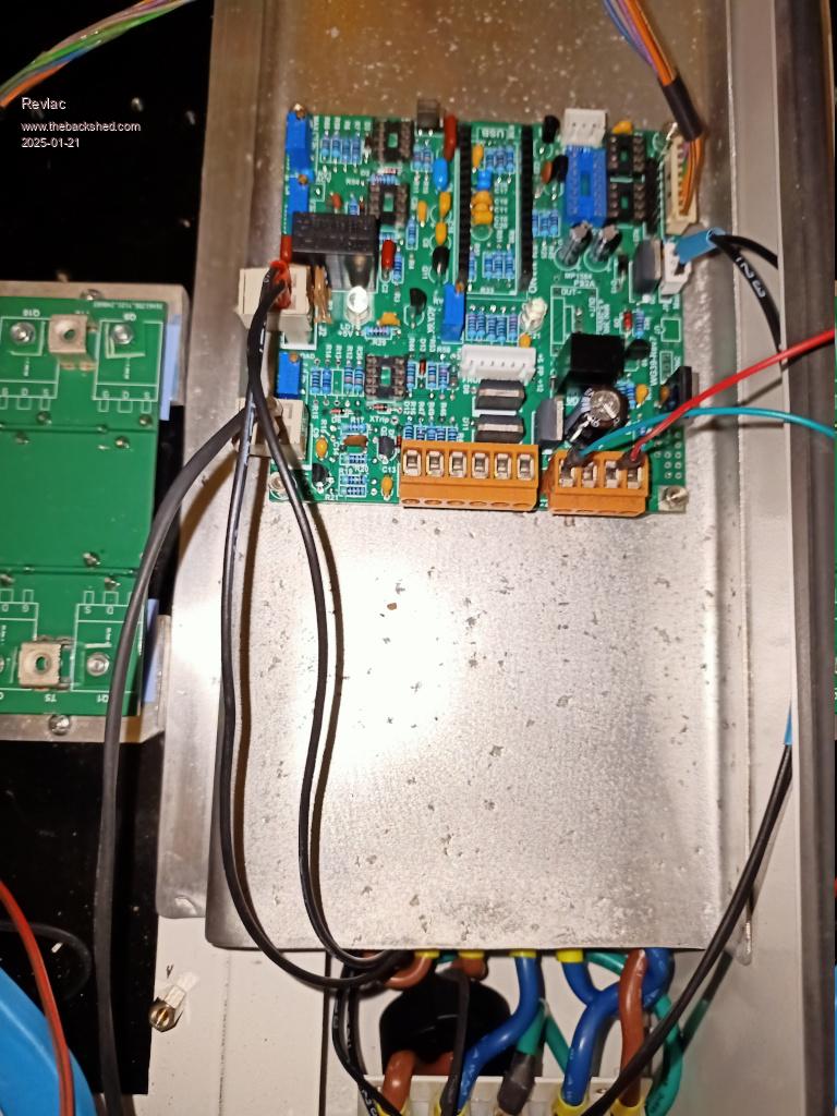

-dex-
Joined: 11/01/2024
Location: Poland
Posts: 104
Posted: 11:40am 20 Jan 2025
Hi,
your copper connections look really solid. If I were a one of final MOSFET I would be afraid
If I can make a suggestion at this stage, it is where to place the driver board.
When you place this near cables with high impulse currents flowing, expect noise and interference around that may want to disrupt the operation of your controller - that was my experience.
In my build, noise was causing interference in the AC feedback voltage measurement, which resulted in poor performance of this circuit, AC voltage was dropping too much during when inverter was operating with loads.
Place it further away, or put it in a metal box, and I'm not sure if being close to an EMI filter would also interfere.
Revlac
Joined: 31/12/2016
Posts: 1310
Posted: 02:16pm 20 Jan 2025
Hi Dex, I remember reading about the noise and interference and thats why I shifted the control board to the side, The plate the control board sits on will be grounded in hope that it works, if not I can add another level of shielding there, Thats part of the fun building this stuff......
Thanks for the reminder.
Cheers Aaron
Off The Grid
Murphy's friend
Joined: 04/10/2019
Posts: 678
Posted: 04:19am 21 Jan 2025
Yes, I agree with Dex that the location of the driver board is important for good AC voltage regulation - as I found out the hard way .
Another suggestion, rotate the driver board so that the two Op Amps are furthest from the bus bars.
Also, I assume that your enclosure is grounded to the AC mains. I grounded the control board shielding to DC ground, which is *not* connected to AC ground in my inverters.
Revlac
Joined: 31/12/2016
Posts: 1310
Posted: 11:08am 21 Jan 2025
Yes, I intended to use AC ground, same as most other things are, I still have the option to ground either way or more shielding and rotate the PCB, the 8 pin cable is plenty log enough..... Clockwise 1/4 turn.
Ok, I Rotated the pcb, and I like it better.
Those little stand off bolts on the corners of the PCB are taken from the computer PC Cards, com ports they are a good size but didn't find many nuts to suit the threads on them.
Cheers Aaron

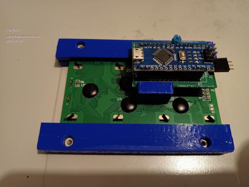

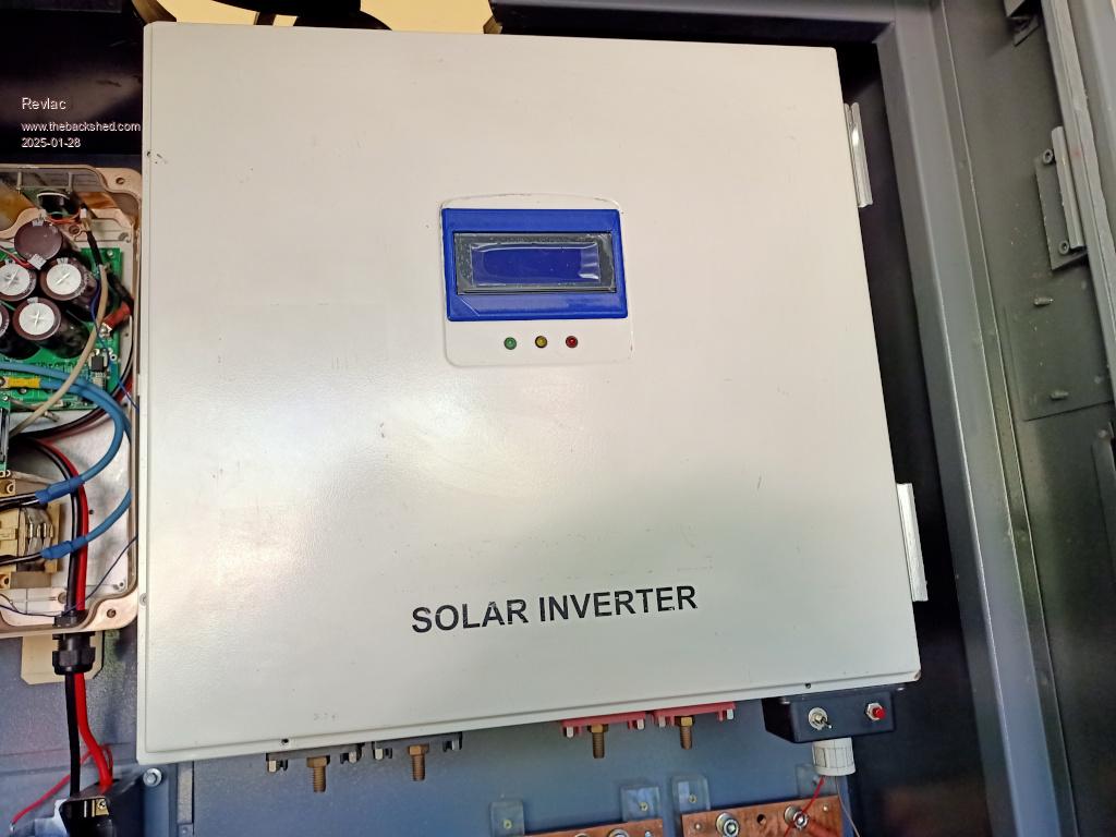

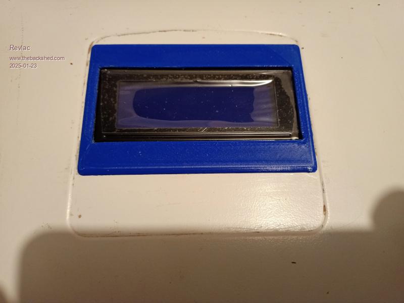

Had to have a little bit of 3D printing in this build......Because I Can........Made it easy to mount the LCD to the existing studs on the front panel, seems to be a firm fit without any screws so far.
Made a bezel around the front screen, it was just a quick rough print using a 0.8mm nozzle in draft mode, pretty rough print as it was good for a design test fit, still have to drill holes for the 3 LED's not sure weather to include them in the bezel under the screen.
I will mount the on/off and reset switch somewhere down the bottom as we shouldn't need to use them much.

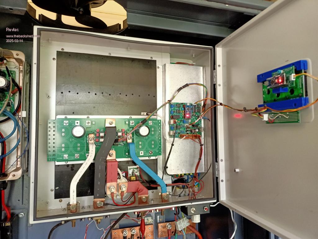

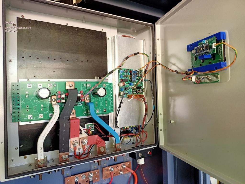

Bit more done, always find a few more things to do each time I check it over, its not far off powering it up on the bench for a check, already powered the board without the IC's in place and the voltage regulators are ok up to 48v (thats the power supply I had) and it needs a final wiring check.
Likely a few other things I haven't done yet, making a wiring harness (cable management) look neat has never been one of my strong points.
Cheers Aaron

KeepIS
Joined: 13/10/2014
Posts: 2287
Posted: 06:17am 29 Jan 2025
Looking really nice, are they your test cap boards with fiberglass washers still intact?
How many caps are you planning to use, reason I ask is I found I needed a minimum of two large high ripple current screw terminal caps on each cap board to reduce cap heating to a minimum when running above 4kW on a single power board for long periods of time.
I really should have purchased 4,700uf Caps in order to keep the total capacitance per power-board around 20,000uf to 30,000uf, mine are 10,000uf caps.

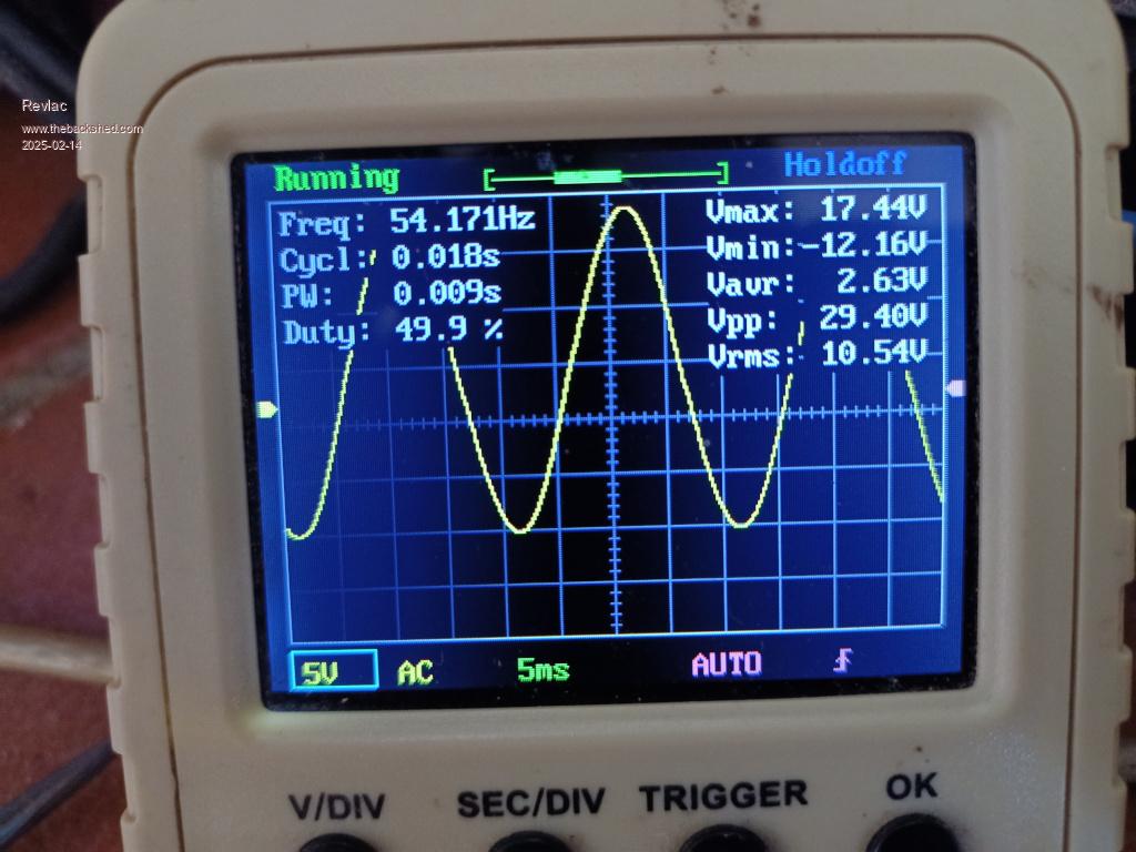

Revlac
Joined: 31/12/2016
Posts: 1310
Posted: 10:53am 14 Feb 2025

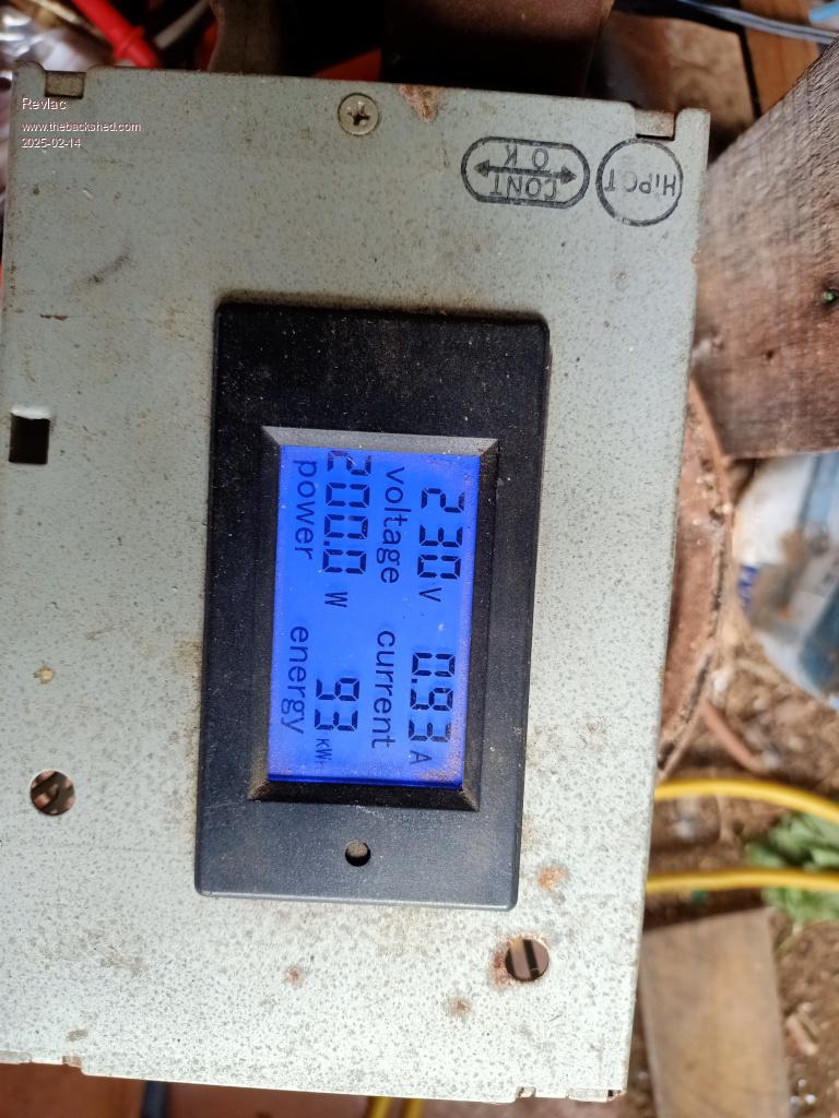

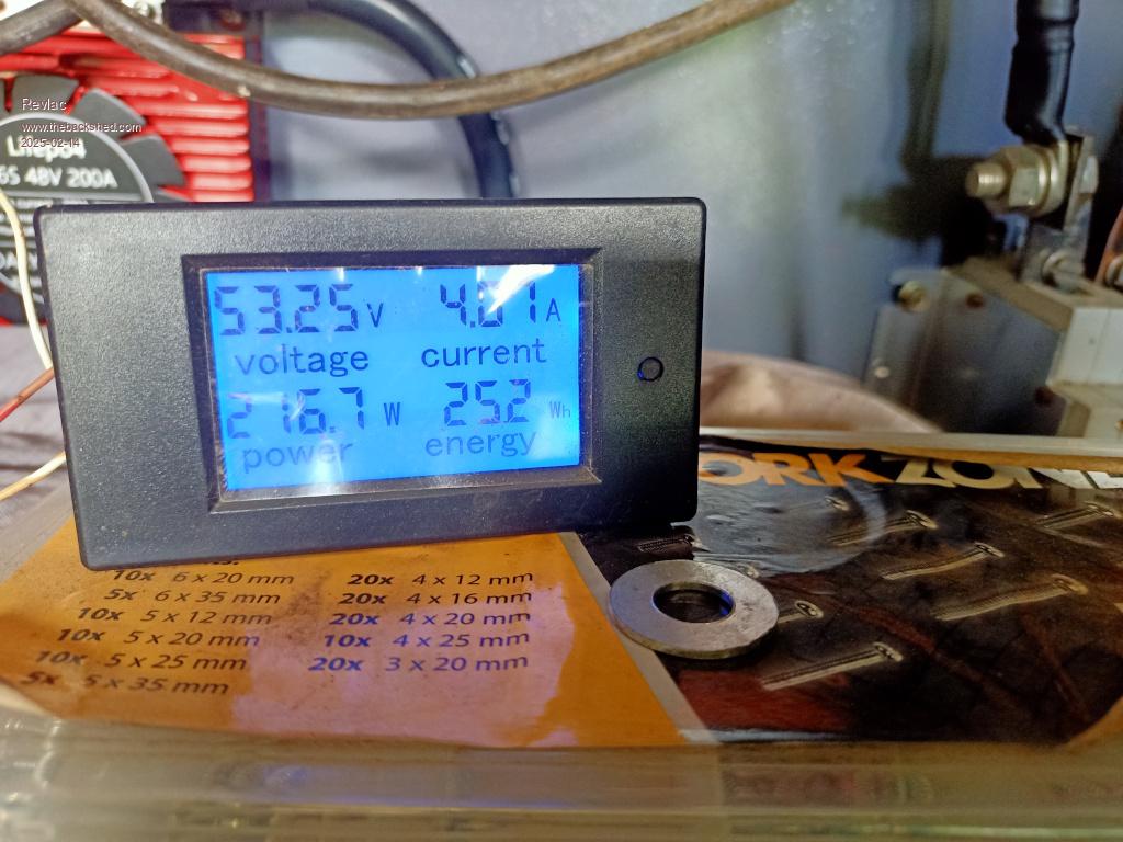

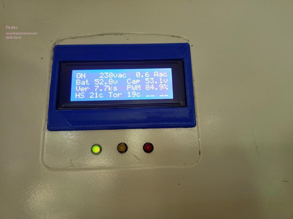

Ok, its fired up and running, I did have the 2 zener diodes (D5 and D6) in backwards......it don't work like that, nothing damaged though.
Only 1 toroid and its temporary wiring till I get the second one in and the some fans and a few other power meters etc, the sinewave is great with a light load 200w running all of today and still running the pair of test caps.
The inverter at idle is about 14w but that will increase when the other toroid is installed, still need to do some calibrations, did a little already but had a few issues with the laptop and the Arduino IDE  not getting along, will try a different terminal later.
There is still one issue to resolve, will figure that out shortly, apart from that, Very pleased with the way its designed and works.
Ignore the 54Hz frequency on the little scope, it often has its own opinion.
Footnote added 2025-02-16 23:47 by Revlac
"I did have the 2 Zener diodes (D5 and D6) in backwards"
To put it bluntly, I mistaken the K marking on the version 2 power board for the diode symbol direction.
Cheers Aaron
