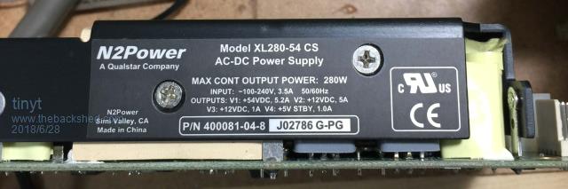

I found the 54v 5.2A DC-DCs, I did not know that I bought 20 of them and I don't remember when, it must have been cheap at that surplus store. I will test them and if all are good and if the model I have has current sharing function, I can connect them in parallel for a total of 104 amps. But this will be another project.

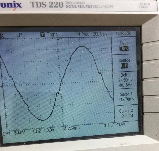

Back to testing, I increased the choke number of turns from 8 to 14 and the waveform distortion became worse. 54V current draw remains the same at 0.18 amp.
I also 'scoped the junction of the transformer and choke. Here it is, looks like an alien's heartbeat to me.
I changed back to 8 turns choke and 'scoped the junction again. Here it is, cousin alien.
I then changed to 4 turns choke and the 115vac output has less distortion than with the 8 turns choke. Here it is. But the 54V current draw increased to 0.22 amp.

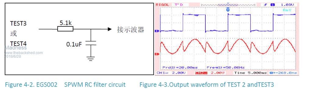

Changing the choke from 8 to 14 turns is a big jump and had a big effect. Adding or subtracting a turn or 2 to see if you are getting close to the ideal is how I would do it.
This not in the EG8010 Datasheet but is in the EGS002 Datasheet.
Posted: 09:11pm 27 Jun 2018
Yes, that is the CRO input filter circuit.
The values are not at all critical.

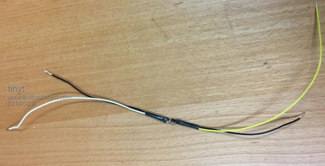

Actually here is a picture of the RC probe I sometimes use. The capacitor is 0.1 uF surface mount. I was just lazy and just wanted to know if I can see the difference between the two choke turn configurations thru that noise.
But I like the bandwidth filter of that expensive 'scope I borrowed before.

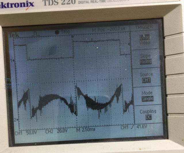

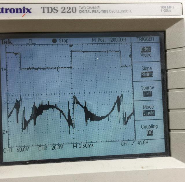

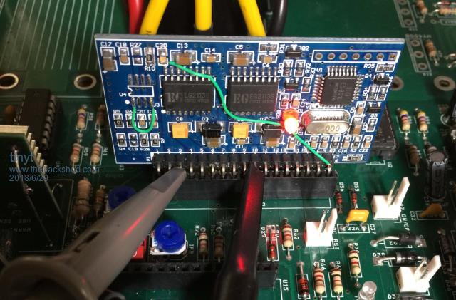

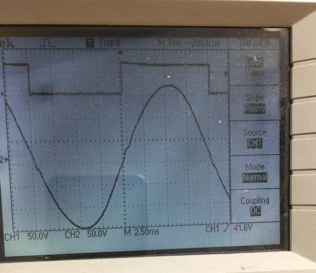

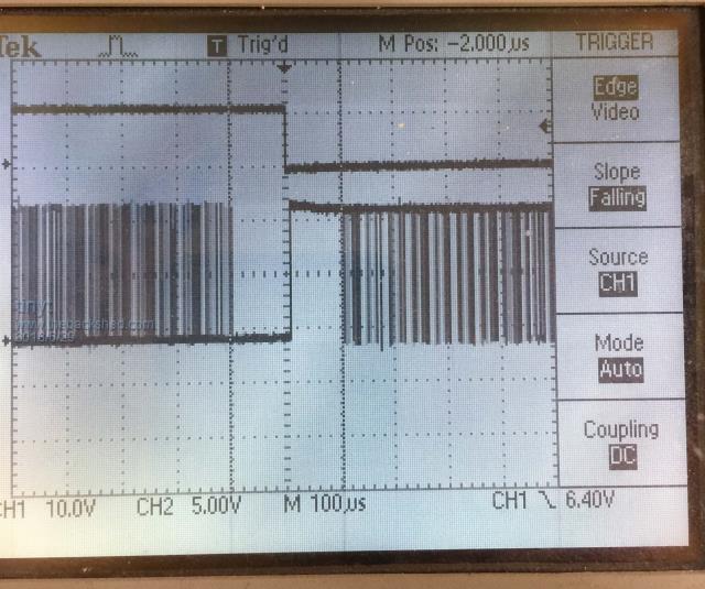

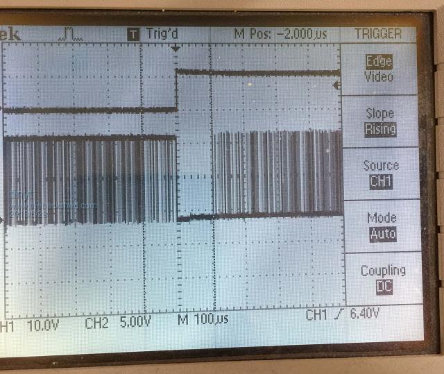

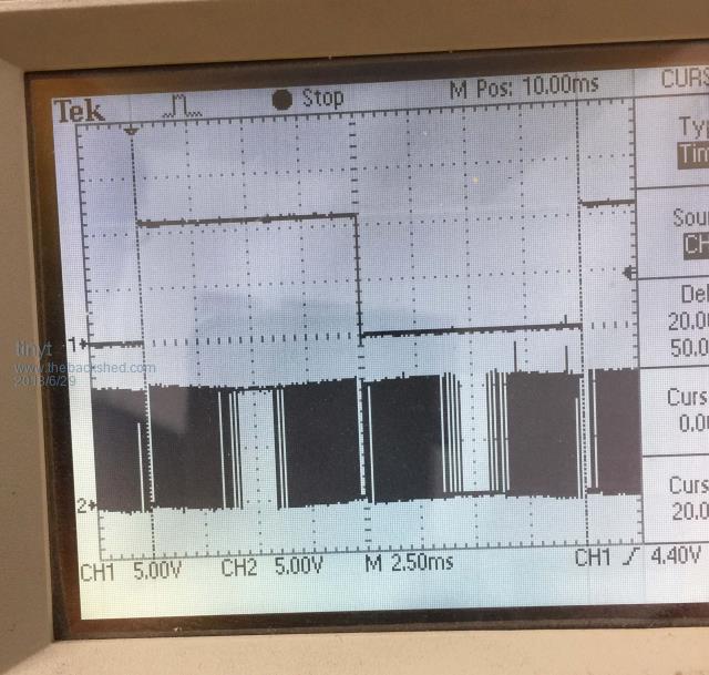

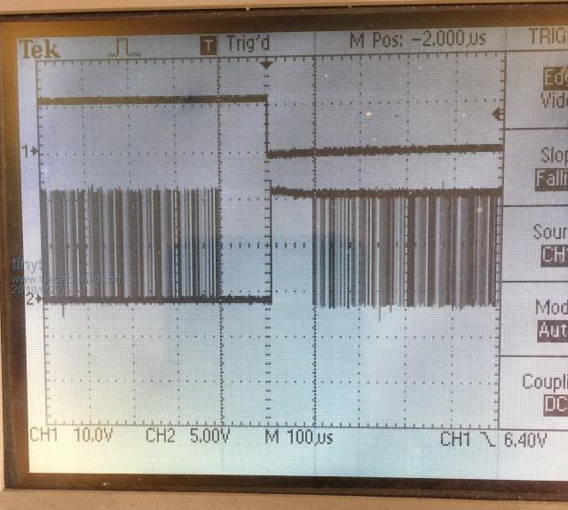

Did more 'scope captures. This time at the pins of the EGS002:
CH1 is at Test1 and CH2 is at Test4. Trigger at CH1 falling. Picture 1.
CH1 is at Test1 and CH2 is at Test4. Trigger at CH1 rising. Picture 2.
CH1 is at Test2 and CH2 is at Test3. Trigger at CH1 rising. Picture 3.
CH1 is at Test2 and CH2 is at Test3. Trigger at CH1 falling. Picture 4.
All four captures above have the scope being triggered continuously. Looks like the SPWM dead time gap at zero crossing is not symmetrical depending upon the direction of the zero crossing of a particular phase of the fundamental.

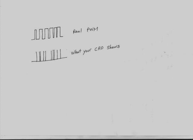

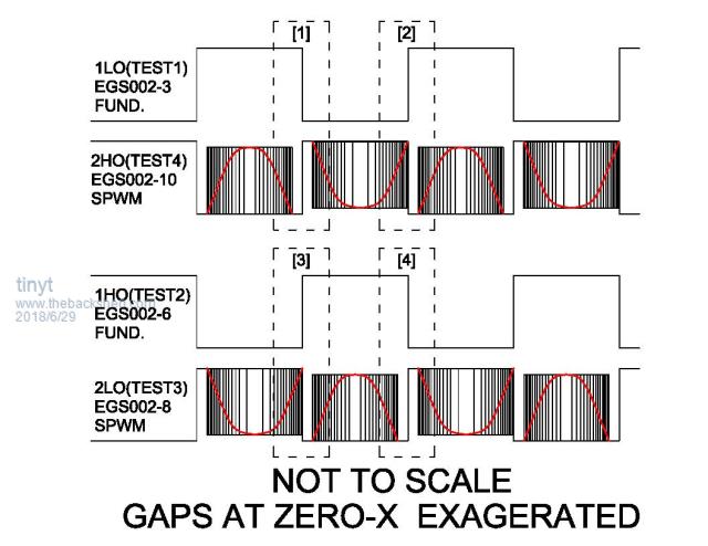

Being a visual guy, I made a sketch of the relationships of the screen captures. I hope I got this right. The bracketed numbers refer to the picture numbers above.

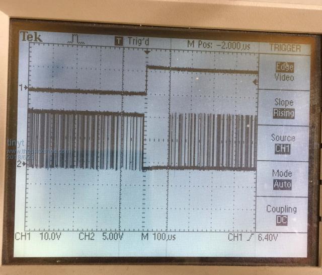

And then there are these three musketeers popping only once right after power on. CH1 at Test1 and CH2 at Test4. They don't appear at the Test2 and Test3 pair. Scope is set for single trigger mode this time.
I hope somebody else can confirm/or not what I found. Note that the EGS002 I tested as received, is jumpered for 50 Hz and 1.5 usec dead time which I confirmed between Test1 and Test2 outputs. It also has cross-conduction prevention transistors. I will see if I can check right at the EG8010 outputs.Edited by tinyt 2018-06-30
Posted: 08:25pm 28 Jun 2018
Difficult to know for sure.
But I will tell you one thing, none of those oscilloscope traces look anything like what real PWM signals should look like.
Those look more like random bar codes !
Where are the flat tops between the tops of the pulses ?
Your CRO is really struggling, and trying to join up some scattered sampling dots and coming up really short....

The pictures above are just focusing on the SPWM gaps at the zero crossing, nothing else. Here is an old capture of a 50Hz and the unfiltered SPWM.
For 50 Hz and an SPWM of 23.4 kHz, I think there will be 234 pulses for each 10 msec (half fundamental) if the pulses are equally spaced, less if generating a sinewave that will be filtered downstream. I am trying to understand the spec of my old TDS 220: It has a record length of only 2500 samples. Sample interval is 50S/s thru 1GS/s, I think this depends upon the SEC/DIV setting. The sample interval is SEC/DIV / 250. The display has a resolution of only 320 x 240 pixels. Assuming it can capture an entire 468 pulses, I don't think it can show all details on the screen. Hence, the picture above looks like that
I remember the older analog scope TEK 453 has A and B sweeps where you can magnify a very small section of a waveform and also pan left-right of the waveform. But this TDS 220 does not have it. Unfortunately the TDS 220 is the only one I have. So for the picture above, I just use my imagination and try to picture in my mind the actual pulses that are changing in duration.Edited by tinyt 2018-06-30
Posted: 10:14pm 28 Jun 2018
Its an interesting problem.
My own Tektronix 2430 digital CRO is the very first digital that Tek ever built, and one of the very first commercial digital oscilloscopes to come onto the market.
Its a real dinosaur from the early 1980's.
It has a very good and very fast high resolution CRT, the same as in their 400 Mhz analog scopes of the same era, but the sample rate of 100 mega samples/sec on each of two channels is pitifully slow by todays standards.
But it does really bring out the limitations of the sampling method of data acquisition.
Its perfect for capturing very slow one time events, and the math capability is excellent.
But for capturing fast digital signals on a data/address bus, or looking at something like PWM its absolutely hopeless.
Even the very low end digital oscilloscopes of today now have at least ten times the sampling rate of my old antique digital, but the exact same problems still remain.
What you are seeing on the screen can be very different from reality in some situations, which can sometimes lead to some very wrong conclusions.
