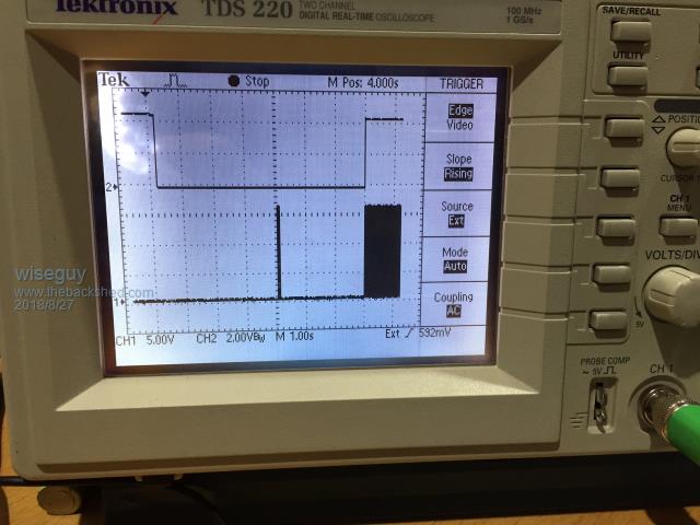

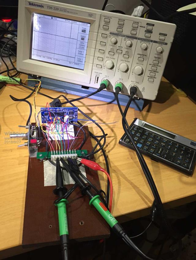

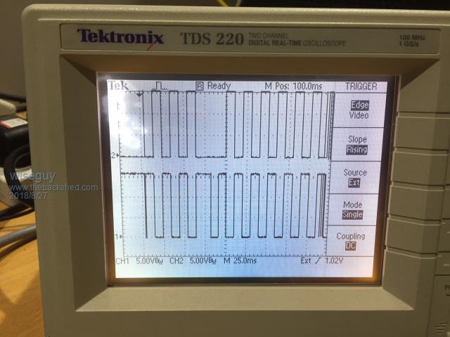

I decided to post some pictures of pin 6 behaviour.
First pic is jig setup
Next pic is overload then pin 6 top trace grounded then output pulses bottom trace (middle of screen) appear (uninvited) a few seconds later, then re-enable pin 6
Finally 2 weird streched pulses in the middle of a pwm train shortly after power up - I have not been able to duplicate again as yet.

  wiseguy said   I found grounding pin 6 of the 8010 which is supposedly the output enable immediately after the overload, a short time later 3 cycles of PWM briefly appear on the outputs and then nothing until after pin 6 is high again - you were not going crazy the 8010 is not perfectly behaved ! Outputs can appear despite pin 6 being set to low.
I would like to clarify a point here, Pin 6 is not used for overload or at least not on the boards we are using. Overload is triggered by the IFB pin and will not restart unless the overload is reset manually. This is due to the BT136 we have that holds the IFB high. Without the BT136 it will attempt to restart a number of times but after I think 3 times, the only way to get the Inverter to restart is by completely resetting the EG8010 by powering it down and restarting.
Thanks for adding that clarification. What I wrote was not intended to relate to the inverter circuit directly. I just wanted to highlight that the spikes John noticed were real. I think TinyT noticed them & referred to them as the 3 musketeers. They may also appear after an over or under voltage event or genuine power down restart - current overload was just my way of triggering a shutdown event. The pulses that followed after the timeout period, triggered my CRO alerting me to something occurring even after I had disabled the output enable (with a switch) - quite unexpected and should not not occur. PS - I have not modified the EGS002 board in any way as yet - still a work in progress.....Edited by wiseguy 2018-08-29
