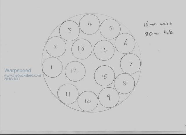

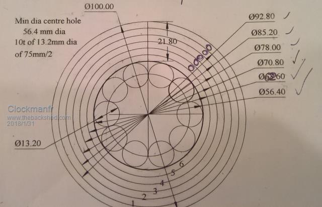

According to this, 15 or 16 wires bundled together will fit through a hole that is 4.7 times the wire diameter.
http://www.isgroup-international.com/pdfs/Wire_and_Cable_PDFs/wire_and_cable_technical_data.pdf
Australian manufactured Tycab cable comes on a 70mm squared size that would be ideal.
Two versions of the same cable.
Double insulated welding cable (orange) that is a huge 17mm diameter.
Tycab ZDU1221202.
Single insulated (red or black) that is a much more reasonable 14mm diameter
Tycab ZBD1221202 Its actually 10mm of copper with a 2mm plastic skin.
This is obviously the same 70mm squared very fine stranded cable. Unfortunately the single insulated cable is only available on a 100 metre roll, so forget that.
The welding cable is much more readily available cut by the metre, and you can slice off the outer orange skin leaving a white inner insulating layer that is very likely to be the same 14mm outside diameter as the single insulated cable.
So with a bit of luck you might be just able to fit 15 or sixteen turns through a hole that is 4.7 x 14mm diameter (65.8mmm)
Does that sound possible ?

  renewableMark said   It looks like I have 83mm ID so far but need to do the final winding, (mylar is on already, so that should be fine.
If you are using 14mm wire you need to reduce that diameter by half the cable thickness on each side as that is the point that they touch each other. But yes it will fit with 1.5mm between each wire.

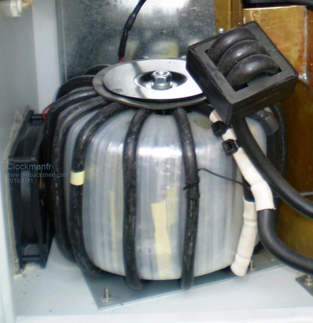

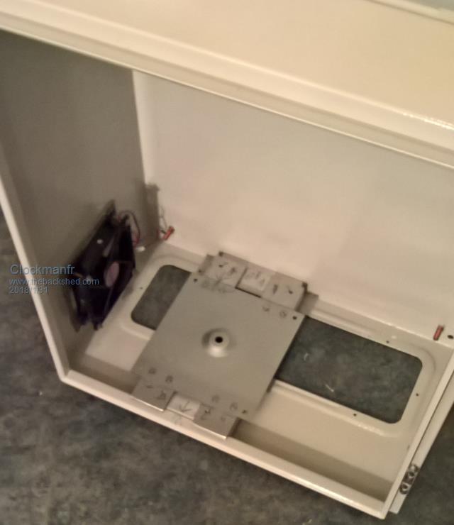

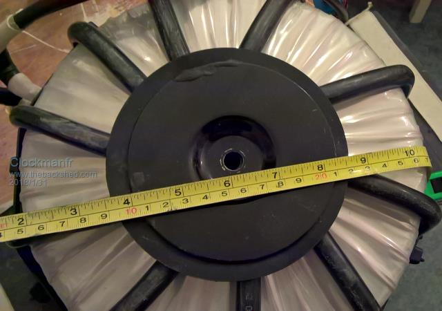

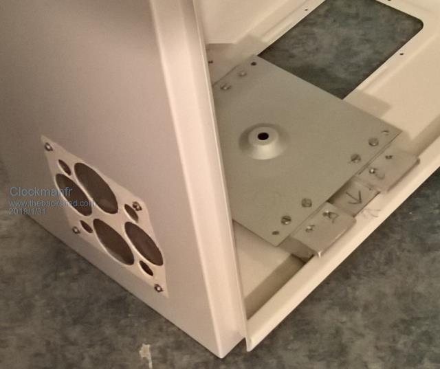

Mark just make it tidy in the centre of the toroid, and do ensure you can get s decent holding bolt through the centre that clamps the toroid down.
Do not clamp the top of the holding bolt to the box/case, just use a nut and big washer with rubber insulator top and bottom to protect the Primary cable.
The below is a 6kW OzInverter toroid all fastened down
Here is some recent photos of a big OzInverter toroid base plate, bolt is 12mm diameter, for the 6kW OzInverter I normally use a 10mm diameter bolt. That's a blowing in 120mm fan.
I use fine stainless steel insect mesh, silicone glued to the inside, then the fan is bolted up.

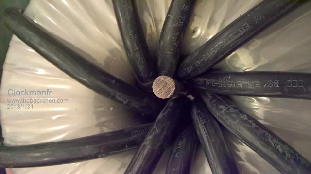

As my Big OzInverters uses a single 75mm/2 primary cable of 10 turns, then there is a good cable gap for air to blow through and up the centre of the toroid.
On paper it fits, but as you can see in the earlier photo, in reality things get messy.
Edited by Clockmanfr 2018-02-01

Posted: 09:34pm 30 Jan 2018
I tried drawing it up twice normal size.
Hole is drawn 160mm, and wires drawn around the outside of a 30mm washer.
Fifteen turns are going to fit in there quite easily.

Posted: 09:41pm 30 Jan 2018
Thanks Warp, if the 4th wind goes on neatly it should be fine. If it has to overlap then I'm screwed.
