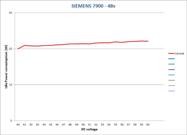

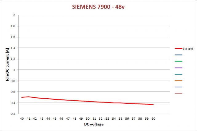

Idle power with this large trany (only 4 FETs on power board) goes from 21.30 W @ 48v and slowly rising up to 22.04 W @ 58v DC. But, I have not played with inductivity of choke yet. On the modified PJ with all mods I got up to 4 w less, but transformers there are much smaller and it take me days of experimenting with various chokes...
I'm happy for now.

Posted: 06:37pm 08 Oct 2017
Idle power of Siemens 7k9 trany
OffGrid 24/7: 250w black mono solar panels 6.4kWp, 1x Midnite Classic 150, 1x MorningStar MPPT 60, battery bank 840 Ah @ 48v, modified LF-8K inverter, DC/DC, hot water harvesting, etc.
Posted: 06:41pm 08 Oct 2017
That is outstanding considering the potential power output capability.

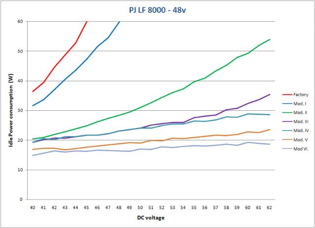

Its always difficult for me when folk say, "I have this ready wound toroid of 7.6kva rating".
After seeing what the PJ claim there toroid's will do against there real claims, and what some manufacturers rating claims, and what 'Warpspeed' mentioned about manufacturers of toroid's cutting everything to the bone/minimal, I am therefore very sceptical of any so called prewound toroid ratings.
'oztules' took the time to coat each secondary winding with epoxy before putting the next mylar/insulation wrapping on.
Like 'oztules' I also want a long life Inverter, and seeing and hearing about old toroid's that have shorted out on there windings, makes me realise that the thin epoxy coating locks those secondary windings, and stops that buzzing/vibrations and ultimately stops that interior toroid fail.

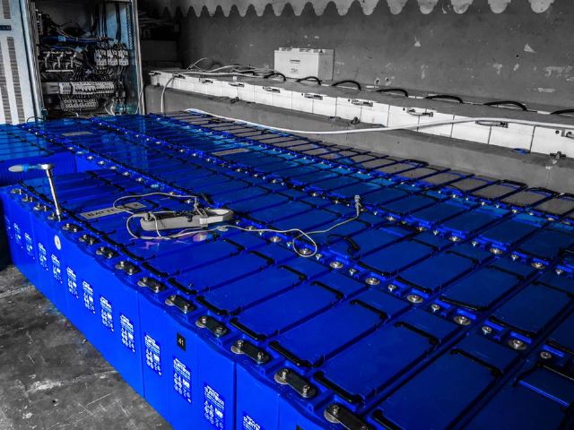

Two friends of mine, one in Slovenia, another in neighboring Austria have got huge factory made 35kW 3f inverters, 2nd hand. But both suffers of (too) high idle current. So they are looking now for 10-15kW ones.
Here is one in Austria - rack in upper left corner

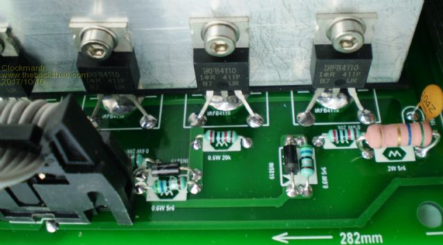

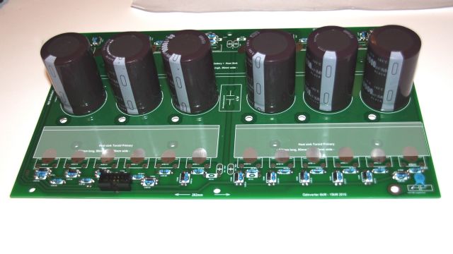

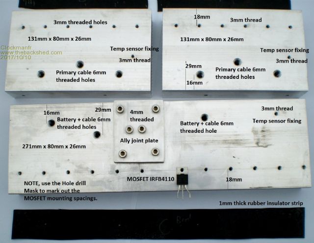

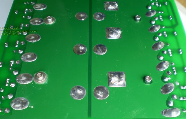

Oztules and I discussed the Power board connections back in 2015. In conclusion it would help, but the present board design is very capable.
I still ask that you insulate the heatsinks from the top tracks as just a slither of copper being pushed through the varnish coating and shorting out on the top tracks could mean disaster!.
I think you have 2 of my early Power boards, the ones that Oztules tested to the ultimate, and a more recent design.
Both designs of the Power board are fundamentally the same except for re-positioning of text/silk screen and the modification to the Battery + 48vdc long heatsink mounting connection.
This +48vdc heatsink, the long one, now has its holding bolts/screws directly connecting with the PCB bottom copper track. see photo of a early Power Board modified.

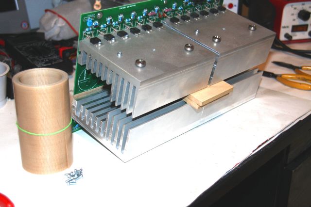

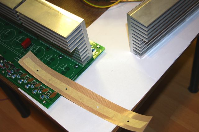

Yes, I saw the differences below all 3 power PCBs, and it is (in my view) all right to have good - best possible contact from large heat sink and the bottom layer of PCB - because of currents at high loads. I would even put there more screws, or at least M4 instead of tiny M3, counting on currents that will flow trough them!
Equal situation is on smaller heat sinks, there are same high currents. If we isolate them from upper layers of PCB all the current will flow only trough tiny pins of each FET. I do not like that at all, so will try to remove all the silk paint (stop mask) from the top layer of PCB below them. Don't know yet how quality paint these chinese boards have ... ?
For the isolation below the largest heat sink I use professional stuff - single layer of thin Teflon laminated tape. Non conductive, high voltage, preasure and temperature resistant, made just for such applications.
