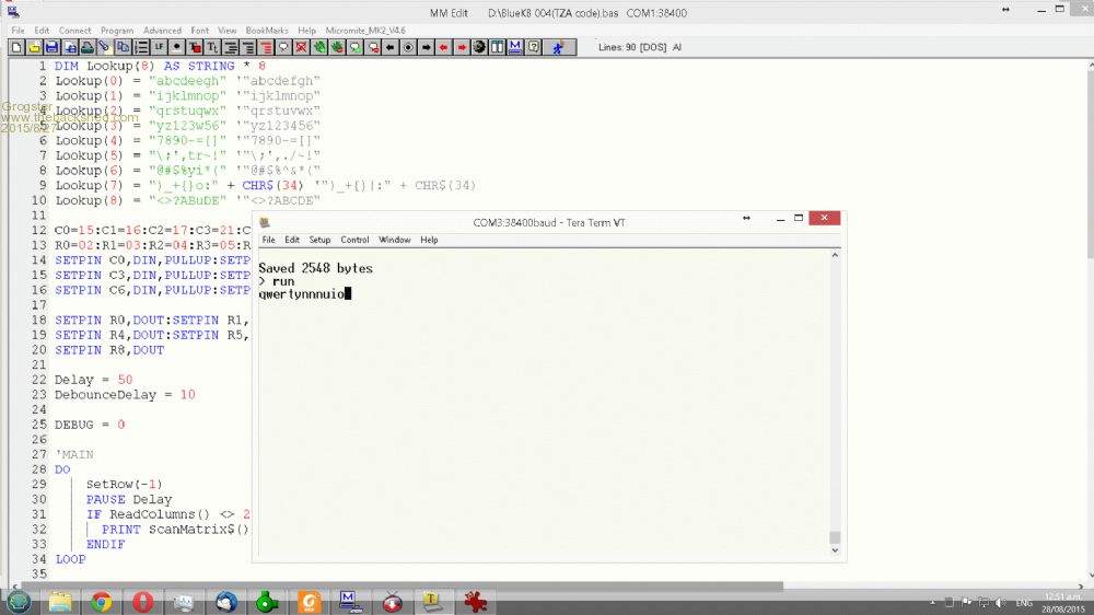

RESULT:
This result is from typing QWERTYUIOP
CURRENT CODE:

Posted: 02:45am 27 Aug 2015
This should make qwertyuio work. The location of the P i can not deduct because it is displayed differently. (Probably teraterm character set)

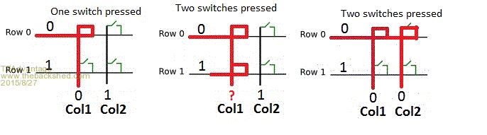

Posted: 02:59am 27 Aug 2015
When you press a key you can connect two rows together. If one of them is 1 and the other is 0 then you have a short.
Only way to prevent that is to have all pins except the current row as input.
That should work without diodes.
Your code and mine does not do that so you need to add diodes.
It needs a change in code to prevent the shorts if no diodes are used.

Posted: 04:16am 27 Aug 2015
Pardon my skills with paint but here is what happens:
As you can see one key is no problem, two keys on different rows is.
Last picture two keys on the same row is also not a problem.
The only way in hardware for Row1 to not short with Row2 is to add a diode.
In software you can however switch all rows except the one you are scanning to an input. Then there is only one output on the whole matrix and everything else is an input (rows and columns). You read only the column so having the rows as an input does not really matter for decoding.
You don't want the smoke to get out. Edited by TZAdvantage 2015-08-28

If we can make this work then it is time to add Shift,Ctrl, Fn, etc combinations.
Ctrl+Alt+Del anyone?
edit: worked on the code a bit more and setup a structure that allows adding the key modifiers. Also added a RAWMODE so that unmodified character codes are send. This will allow programs to use for instance the left and right shift keys (good for a pinball game ).
Once the lookup string has all the right characters it will not have any capital letters. We can then use A-Z for the modifiers and special keys.
The way the scan works is that when for example the left shift key is pressed it will return a "L". When the next key is pressed. Maybe a "a" then the values$ will have "aL" or "La". So you do not need to remember the modifiers. They are available each call. CAPS LOCK is special, because when it is released it still needs to be remembered. Not figured out the best way to do that yet.
If we want to use this keyboard to be able to edit a program, then we need to know what has to be send when function keys, arrows, etc are used.
Does somebody have a table with those values?

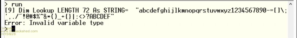

Posted: 11:27am 28 Aug 2015
I think there is a bug in MM Basic.
Try a space between STRING and =
DIM Lookup LENGTH 72 AS STRING = "abcdefghijlkmnopqrstuvwxyz1234567890-=[]\;',./~!@#$%^&*()_+{}|:<>?ABCDEF"
Posts: 10109
Posted: 04:36pm 28 Aug 2015
Yes, when I try that, the code does progress much further to this point:

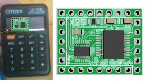

Posted: 04:42pm 28 Aug 2015
The reason i went with the PIC16F1459is that i want to make an as small as possible generic Matrix to Serial module you can see in the picture.
I have overlayed it on the picture to get a feel for the size.

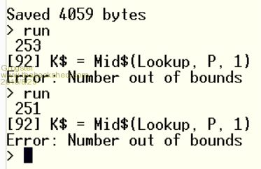

By being this small it should fit in most keypads and it will use only one of the precious mcu pins. With a micromite it can then even be used as a noraml keyboard so that programming will be very easy using normal inkey$ and inputstatements. Allowing you to fully test the program with Teraterm first.
This module is one of the hopefully many i have planned for my long overdue 'MicroBlocks'. I had to think about a whole new concept to use these modules as the market is floodedwith 'modules' and i think i have found a nice niche. More on that later. Goes by the "BBM Series" codename. (Each product should have a codename )
Posted: 04:44pm 28 Aug 2015
G, I will check the code for that error.
Ok. Found it.
Change
[code]
'Decode the ScanCode
if ScanCode <> 255 then
[/code]
to
[code]
if DEBUG = 1 then PRINT RowNumber;
if RowNumber >= 0 and ScanCode <> 255 then
[/code]
Edited by TZAdvantage 2015-08-30
Posted: 04:54pm 28 Aug 2015
  Grogster said   Yes, when I try that, the code does progress much further to this point:
That error suggests that 'P" is negative or zero.
FOR P = 1 TO 74
k$= MID$(Lookup, P, 1)
PRINT P," *",k$,"*"
NEXT P
P=0
PRINT P," *",k$,"*"
I don't have a keyboard to play with.
paceman
Joined: 07/10/2011
Posts: 1329
Posted: 06:12pm 28 Aug 2015
  TZAdvantage said   The reason i went with the PIC16F1459is that i want to make an as small as possible generic Matrix to Serial module you can see in the picture.
Wow, that is small TZ, less than an inch across, (oops, < 2.54mm). If you can get this flying there should be plenty of takers - the biggest problem will be fitting a socket for it - the cable that is.
GregEdited by paceman 2015-08-30
