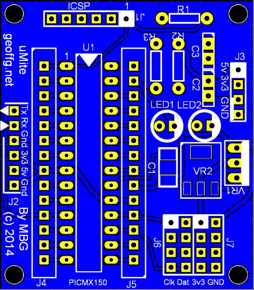

Gday Lads,
After biting the bullet and buying AUTOTRAX DEX I decided to have a go at a small uMite board..
OK why reinvent the wheel? Actually I am not re-inventing it, It is no way as good as White Wizards or Zonkers offerings and it isnt designed to be..
It is designed to be used (for my purposes at least) a final board after development is done and dusted (using one of WW or Z's boards).
I envision that the board is to supplied with 5Vdc, only, via a standard USB `wall wart' adapter and it generates the 3v3 onboard.. it has connectors for the TTL console but generally I wont be using the console hence no need for USB onboard.. It has two 14 pin headers alongside the chip so any pin can be picked up.. and a strip of I2C and 3v3 headers for upto 4 I2C devices..
It is designed to fit the 50mm square cheap chinese proto boards (actual size about 49.5 x 43mm) so it will be cheap.
I intend to get the minimum proto run for myself of 10 but if there is any interest I will order a few more.
Anyway submitted the design (for what its worth) for comments.
Note VR1 and VR2 are one or the other, I have catered for SMD or TO-220 device for the 3v3 regulator.
I have not fully checked the circuit as of yet as I am on holidays and its hard juggling beers and hamburgers and laptops.
OVERLAY
SCHEMATIC
