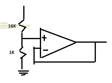

Not done any complex electronics in over 40years.
I am asking: if anybody wants to help with component choice and circuit design.
We start by connecting a simple 2 resister "voltage divider" across the bank.
The voltage between resistors = bank voltage divided by cells as below.
Shown are (16KΩ + 1KΩ) resistor values for a 17 cell Bank.
You see here the voltage divider is connected to a (Opp Amp) voltage follower.
A Voltage Follower replicates the voltage on its input to its output.
I need a voltage follower capable of at least 1 amp.
I have been looking for a power supply that can replicate a reference voltage.
Hope there is someone in forum who can offer suggestions.
Cheers.
Add: I have options for commercial solutions, but there is always room for a better mouse trap.
Just depends on the interest.
Edited by Gazz 2017-03-25
