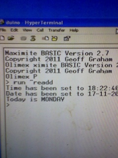

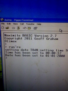

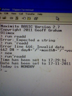

ok i have the time clock connected but i am getting an error on the read the write is fine it may be the program i am using as i have many ...but it is seeing it on pins 5 and 6 of the U=ext on the rear hedder...///...///but i am having trouble with the read program "matt what was error on line 446 ..invalid date " what was the fix for that i cant rember and i will have to go digging i think i need a different read code....here`s a pic...///

When I was getting this error it was because the jumper was NOT set to BAT, so each time you rebooted the RTC went back to not knowing the date/time string. As soon as I changed the jumper to BAT, booted, set the Date$ & Time$ and then ran the clock set program, from then on it worked just fine.

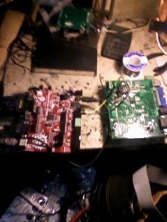

thanks for that info but i am if you look at the hardware pic two boaeds one you prolly have not seen and the other is a blown up SM1 board but i have isolated the "rtc" part of the cct and i am running the two rtc signal wires to my dynamite mega have a close look at the picture ...///...///

i am still to master the "rtc" but i think it might be down too component level ..now i will have to get the meter on it it seems that i may have an open diode or maybe a short some where...back to the drawing board although it does return a value of "zero" meaning only one thing ..the wires to "U-ext " must be correct......

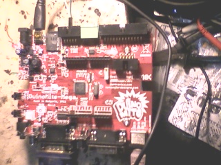

thanks don cheers check this out ....got the "RTC" happening i mean its just a add on its just getting it correct ...any way heres a pic for ya funny what this board sometimes throws out at start up.....have a close look .....

  sparkey said   thanks don cheers check this out ....got the "RTC" happening i mean its just a add on its just getting it correct ...any way heres a pic for ya funny what this board sometimes throws out at start up.....have a close look .....
Yes, it only happens on the terminal, not VGA, but Ken is aware, and is fixing it in the next update.
