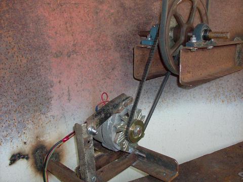

About the alternator, electrically speaking, it won't matter which way it's spinning. Only thing, that might make a difference are the brushes, if they're ok mechanically with the reversed direction. The alternators I've had open would have not minded spinning backwards. So it might not be necessary to swap the direction.
The tach output on the alternator is just a lead attached to one of the internal AC phases, so if you need it you can solder a wire inside to get the tach signal.
When it comes to wind power, the usual comment is that auto alternators are trash with their bad efficiency, need for high gearing, and the field current requirements. But they do offer one significant advantage over synchronous generators. If you can replace the stock charging regulator with your own version, where you can control the field current externally, you've solved all the aches of load matching. With the field current control, you can pretty easily put together a controller with whatever load curve you want. If you live in a windy site, the good load matching will more than compensate for the poor alternator efficiency.

God point on the alternator rotation but the thing to watch is the cooling fan as some do not work well when reversed and could result in overheating.
Another advantage with an external regulator is that they are quite happy to be used on 24 volts as well wit only a upgrade on the voltage of the diodes, while some will work same will burn out if over volt-aged.

The (GM 10SI alternator), is argueably the most for the buck around here anyway. This paticular one has an internal regulator. I did go ahead and turn it around this morning, I was concerned about overheating.

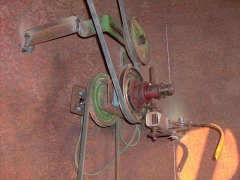

I also installed the clutch linkage and overcenter arm.
You can also see that I have installed an idle pulley. I have'nt installed the air compressor yet, I intend to wait until I determine just how much power and speed this mill will produce. I was only able to work for part of today, the company came and I had to give a tour of the project, I never fret about visitors, and curious folk, always have time to show them around the project.

I fabricated and installed the rest of the brackets for the right angle gear box, also spent the rest of the morning welding inside the belly of the mill. Its to bloody hot to stay in there all day. "I'm always complaining about the weather".

What is the ratio to the alternator as the mill will be around 120 to 150 rpm and the alternator needs to be around 5000 rpm to get any usable output.
Looks like there was a John Deere doner somewhere along the way.

As of right now the ratio is set at 7.2 to 1, that is if the mill's turning 100rpm ,then the alternator will be turning 720 rpm. // 150 rpm at the mill then 1080 rpm at the alternator. I know what you'r thinking..."well thats no good," ...
This is the ratio I've come up with only as a starting point. This should be just enough to achive cut in for the alternator, and generate perhaps 10 to 15 amps @ 13.5 volts. The main goal I'm trying to achive right now is to enable testing of the wing profile. I will need to establish the incidence angle of the wings for best start up torque vs speed under load.
I have several pulleys on the bench I could use to switch out and increase the alternator rpm. Also I hope to set this up for my average winds of around 10 mph. There is'nt alot of power available in a 10 mph wind, as I'm sure you know.
The donner machine is in fact a Deere, 1964 vintage.
