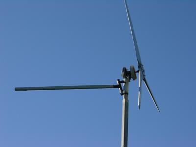

Hi guys not sure if i should have started a new thread for this but it is food for thought.
I had a big blow last night (100k plus)gusts and woke up during got up to check things and noticed my poor out put on my mill could see gauges 10 amps 24v gusting to 20amps should have been 25 amps gusting to 40 amps could here mill just but to dark to see so went back to bed and woke up to this.
not a bad output for this broken tail couldent have been much swept area for the blades, my fault i used a piece of tin for the end it has been tired for a while just been lasy all fixed up today though and goin great again.

Great survival story, it lives to make amps again, no other apparent damage so thats good. Would have been interesting to watch if only you could see it.

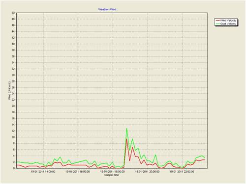

Hi All
We had another storm front come through this afternoon and this silly black duck was able to stand out in the rain to observe the furling action, the following graph shows the wind during the event, and the good news is that the mill was making an effort to furl on the gusts, not a complete furl as the gusts where a bit short in duration but it nevertheless did furl to about 50% and did so in a controlled and non violent manner, that was a big concern of mine but no worries, Thanks Phill, the mill was producing over 1200 watt above 10 ms with no smoke escaping out of my hay wire contraption, so it looks like I will have to tidy it up and put it in a box.
It looks like the mill will be furled by 15 ms, a bit higher than I thought but still in the safe range for structure and electrical output.
The new boost converter arrived today so will fit that and see if it can work OK without the doublers to simplify things a bit. The new boost module is rated at 10 amps instead of 3 amps for the one on there now.
The green trace is the gust speed and the red is the average wind speed.
As you can see the whole thing didn't last long but I was happy with the result.

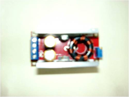

Hi All
I have fitted a different boost device to the mill as the first one was getting a bit to hot, as it was rated for 3 amps only, the new one is max rated at 15 amps input for boost, it also cuts in at a higher voltage 10 volts and with a 27.5 volt output, this is adjustable, so I set it up on my adjustable power supply.
Sorry the photo is a bit fuzzy as my camera doesn't like to focus to short.
The device has a little SMD controller running two FET switches and the blue blob is the adjusting pot I got it off fleabay at $15.

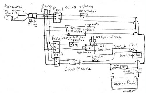

Same hay wire circuit as before, just changed to the bigger unit.
How did it go, I was pleased with the results all around, it cuts in at 10 volts as designed against the smaller unit cutting in at three volts, this has had the effect of letting the blades come up a bit faster without load and allowed for a better power capture, the smaller module used to cut in a 100 ma and go th 3 amps, whereas this one cuts in at 1.5 amps and goes to 5.5 amps before the voltage doubler cuts in on the main battery charge circuit. The GTI cuts in at 15 volts and increases to 10 amps at 28 volts.
The result of this is a recovery of 130 watts before the doubler cuts in. The doubler contributes another 1.5 amps, before cut in on the GTI.
Once the mill comes up to working speed the voltage across the boost module equalizes so the power is the going through the main rectifier so no amps through the boost module.
The result is 7 amps through the boost module and the cap doubler in combination a result of 180 watts that wasn't there before.
Does it suit all? It's a case of suck it and see, My friend tried it on his low cut in AXFX and it overloaded the mill, he will be trying it on the higher cut in mill in the future so I will let you know how that goes.
On my little mill its great as it allows me to leave it in Delta for the best efficiency but grab the watts low down as it would in star.
Next job is to neaten it up and fit in a suitable box and fit a larger heat sink to the boost module as it gets a bit warm.

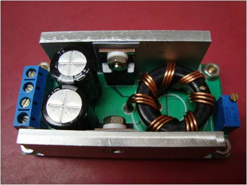

Hi Klaus
Info on the booster\
DC IN 10-32 OUT 12-35V adjustable converter Module Z
