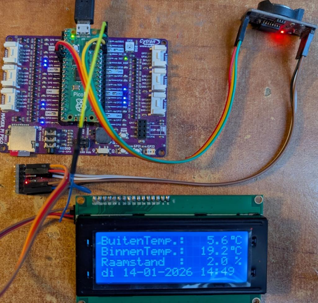

Peter and Harm,
I've done some more research since my last post.
The RP2350A is a model with 16MB flash. I did a fash_nuke yesterday, and the firmware ran for 1.5 hours without any problems.
This morning I set the autorun option to on, after which I had some startup problems, such as the backlight going off. Then I set the pause time from 500ms -> 5000ms, and it's been running for 1.5 hours without any problems so far.
I just downloaded the latest RP2350 update (picomite.zip) and it's now up and running. I do indeed see an "r" appear on my TeraTerm console screen every minute. It's also working fine on the LCD2004 screen.
I'm using a MAKER PI PICO with the RP2350A module. On the right side, I've mounted a 4x20 LCD2004 screen on nylon bushings, and on the bottom of the LCD, I've installed a standard I2C to parallel module for these screens.
I solved the 5V bus problem by using 2x4k7 pullups from 5V to 3V3.
Underneath the MAKER PI PICO is a DS3231 module with EEPROM, all on the same bus. Because the 4k7 resistors are in parallel, the resistance is already lower.
Ten years ago, I created a greenhouse controller for a hobby greenhouse with various sensors using an Arduino nano and BascomAVR, which has always worked without any problems.
Last year, I had some problems with the 24V power supply, and now I've made everything 5V, and the rain sensor is showing signs of wear on the sensor surface.
I'm trying to get this controller, using the same sensors, to work with the PicoMite as well. The controls are operated using three keys: UP, DOWN, and ENT, and sensors include two DS18b20 sensors, a 10K window potentiometer, and a rain sensor. All 22 settings were then written to the EEPROM in the nano.
Now that I'm typing this, I get a message on the terminal.
> run
rrrrrrrrrrrrrrrrrrrrrrrrError: Invalid address - resetting
> rrrr
The program is still running because the r's are being filled in, but the time on my LCD2004 has stopped. (18 r's already added)
So the problem is with the I2C connection/software?
Kind regards,
Jan.

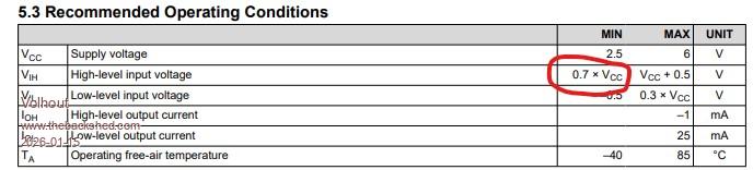

Posts: 6253
Posted: 03:41pm 14 Jan 2026
@Jan,
PCF8574(A) is 5V I2C (Vh minimum is 3.5V)
PCA8574 can work with both 5V and 3.3V levels at I2C
DS3231 is 3.3V I2C
Pico 2 in essence is 3.3V I2C, but can survive 5V under certain conditions.
I hope you are driving the chips at correct levels. I see in Peter's photo he uses a level shifter between pico and PCF8574. That is correct.
Edited 2026-01-15 01:46 by Volhout

Posted: 04:36pm 14 Jan 2026
Thanks for all your attention. I first measured the pullup resistor of the SDA and SCL on the connection pins, and it's 4K7.
Then I added a 4K7 pullup to the free SDA and SCL pins of the DS3231. (The value is now 2K4.)
The program started and now works flawlessly on the terminal with rrrrrrrrrr and on the LCD2004.
I still have a few 2-channel I2C level shifters (they have 8 pins), so that's the next step if this test fails.
It's been working flawlessly for over 2.5 hours now.
What is noticeable during autorun is that the program doesn't start automatically the first time, the RTC auto-enable option has disappeared from the list, and the backlight turns off on startup.
Once it's started with the RTC auto-enable option, the backlight works correctly. And regarding the power supply on the PCA8574(A) type, it's 5V. The A type has an extra set of addresses, both of which I have. Only the SDA and SCL are connected externally to a 3V3 pullup.
I'll wait and see about this test.

Here I'm using a 4x20 screen.
See the program list.
I'm using a level shifter between the RP2040 and LCD2004.
With I2CLCD: y, x 'y = Line number, x = Character number, C = Center.
PicoMite MMBasic RP2040 V6.02.00RC6
Copyright 2011-2025 Geoff Graham
Copyright 2016-2025 Peter Mather
> option list
OPTION SYSTEM SPI GP10,GP11,GP12
OPTION SYSTEM I2C GP20,GP21
OPTION COLOR CODE ON
OPTION HEARTBEAT OFF
OPTION PICO OFF
OPTION CPU SPEED (KHz) 200000
OPTION DISPLAY 50, 100
OPTION SDCARD GP19
OPTION F1 FLASH RUN 1
OPTION PLATFORM PicoMite RP2040-SD:32G
> list
I2CLCD INIT &H20
I2CLCD 1, C20, "Hello world!"
I2CLCD 4, C20, "Love"
> run
Kind regards,
Jan.
Edited 2026-01-15 10:58 by JanVolk
