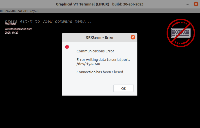

GFXterm64 (2023 build) gives some feedback when trying to use the console.

Try the one just posted - looks like crap Linux issue not handling increased USB buffer size
Edited 2025-10-27 01:54 by matherp

No change on both Putty and GFXterm64.
P.S. Don't put the blame on Linux, up to RC7 worked fine. You changed something that broke compatibility I guess. I checked RTS/CTS handshake is off, XON/XOFF handshake is off.
