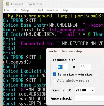

Terminal bug:
Using  the latest available ‘PicoMite RP2040 v6.00.03’ on a genuine RPi 2040 Pico.
Accessing it via USB in TeraTerm.
TeraTerm terminal set to 80x30.
OPTION DISPLAY 30,80 is set.
All works as expected until I enter the EDITor. TeraTerm then switches to 81x30.
This then leads to the issue I am seeing. If I edit the program code in any way, and then press ESC, the whole screen jumps one character to the left (I.e, I effectively loose the first column from the screen -but it is not lost forever from the code). If I acknowledge the ‘Exit and discard all changes (Y/N):’ with  N, then the screen redraws correctly (ie the first column reappears).
I believe the two issues above are linked.
Not tried on any other versions.
I have three other OPTIONs also set, possibly the first one ‘interfering’:
SERIAL CONSOLE COM1, GP0,GP1,BOTH
COLOURCODE ON
CPUSPEED 150000
Be interested if anyone else can replicate this….

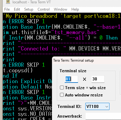

@WhiteWizzard
It appears only to happen if the Term size=Win size option in Teraterm is not checked. I only unchecked this trying to replicate the issue so normally checked for me.
Unchecked.
Checked.

MMbasic always tells the terminal to be 1 character wider than the setting of OPTION DISPLAY. It does this so that auto linewrap in the terminal can't cause problems. Every version of MMbasic I've done does this.
