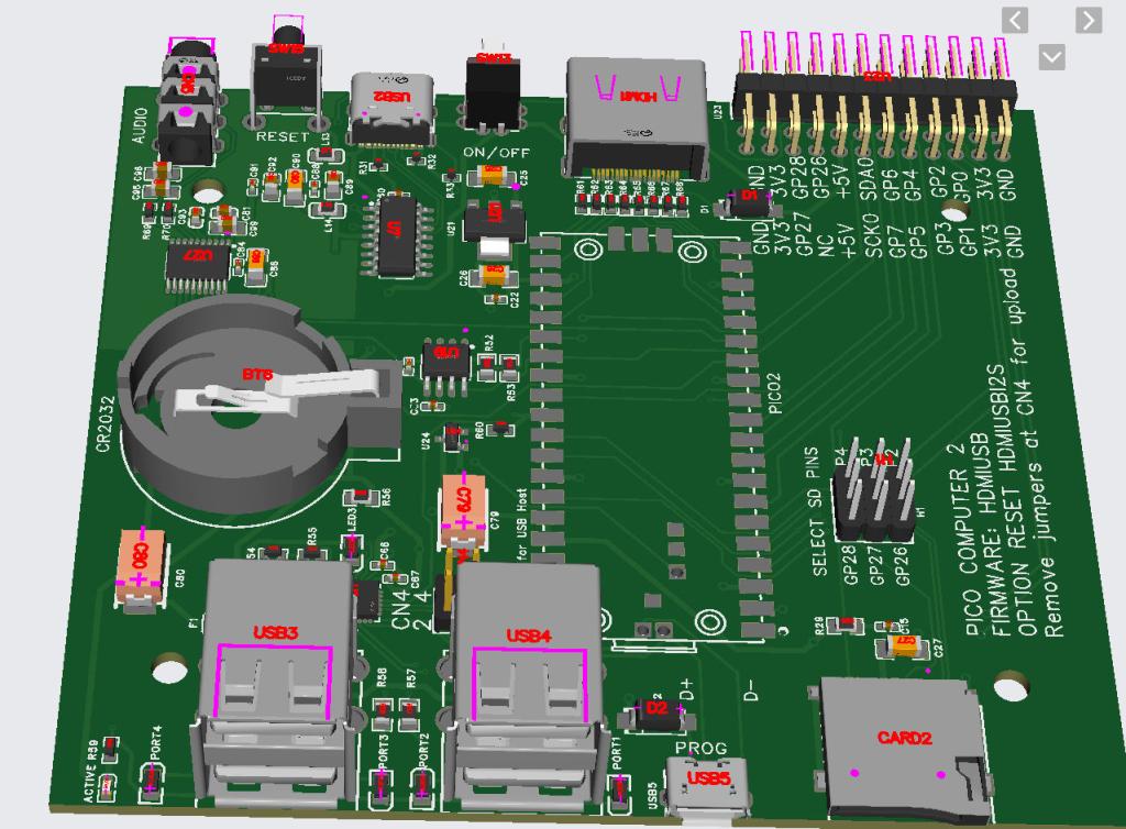

Just got my new boards in and soldered the first one up.  Everything is working except SD card. The board is jumpered for GP26 -27 -28. I've tried multiple known good cards.
I've swapped the jumpers themselves in case one of them is bad. Solder joint to GP22 looks good.

Some modern SD cards do not work in SPI mode. Try with another card, preferably older and smaller.
Also, during soldering, the SD card socket may be damaged or shorted.

I would suspect a short or dry joint on the soldering of the Pico2 to the board

I rang GP22-28 out with the meter all the way from the Pico pads to the SD card socket where it is soldered, and all were connected.  I soldered up another board, and the SD card works perfectly.  I'm chalking it up to a dicey SD socket in the first one.
I re-flowed all the pertinent solder joints, including the SD card socket, and now all is well.
Thanks!

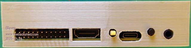

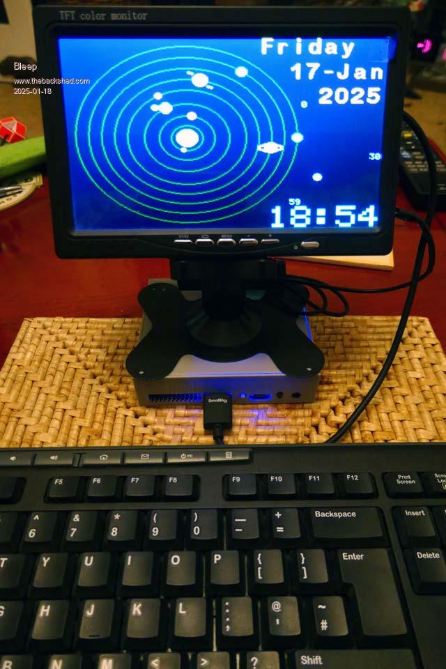

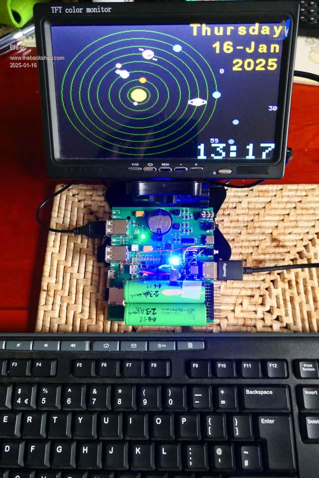

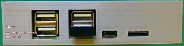

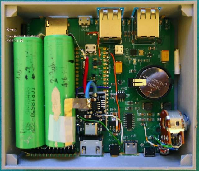

Peters Ref. design, now fully self powerd and portable, I'm working on a case now. I repurposed the 'reset' button to be a battery power on/off button, I removed the 3 jumpers which select signals to the SD card, now wire links on the back, the keyboard is wireless USB, the HDMI cable is nice and thin 30cm, I should be able to fit the box, once designed, to the bottom or back of the display.
Powering only itself, it'll run for about 16hrs, or powering the mini LCD as well, as shown here, about 3hrs.
Edited 2025-01-16 23:36 by Bleep

@Bleep
What is the name of the astronomy program running in the picture? I don't know it.

solar_clock.zip
twofingers
Joined: 02/06/2014
Posts: 1785
Posted: 04:43pm 16 Jan 2025
https://www.thebackshed.com/forum/ViewTopic.php?FID=16&TID=14464

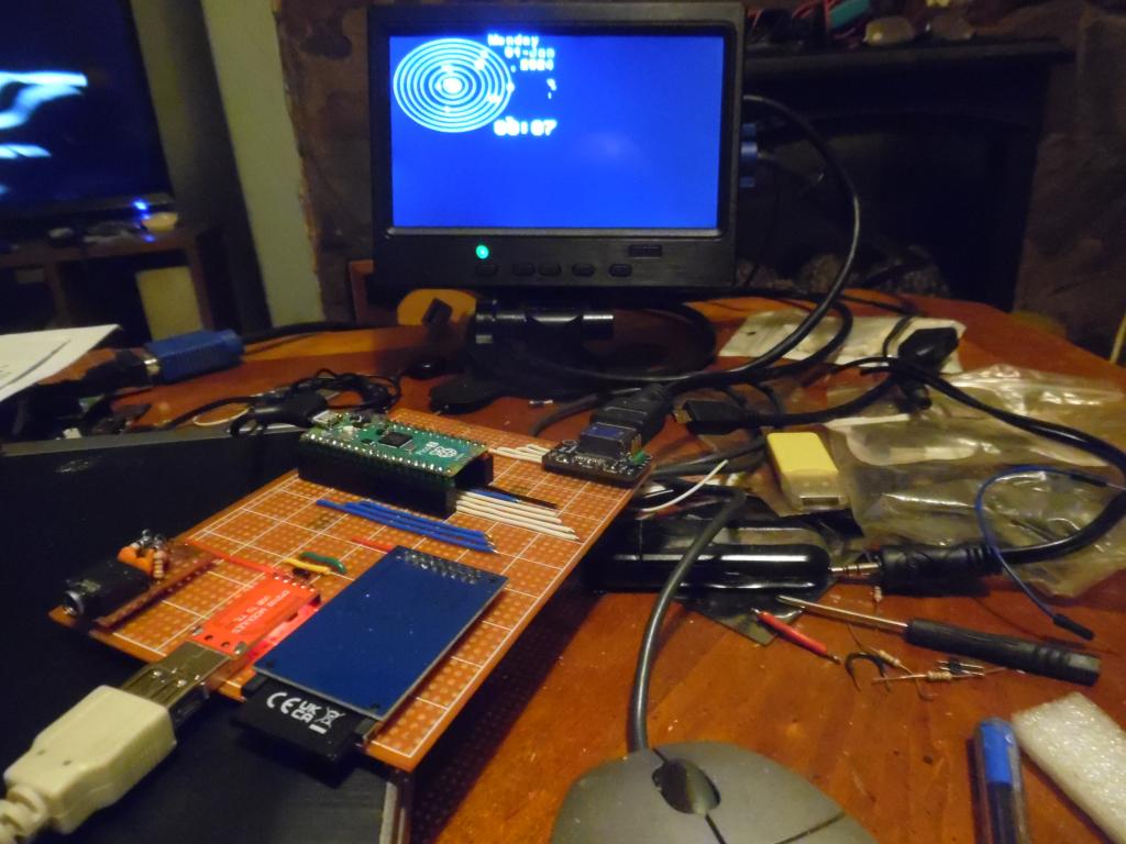

solar clock
pico 2. 8" monitor , what's the bouncing thing?
works though
Posts: 3429
Posted: 08:42pm 16 Jan 2025
  Quote   what's the bouncing thing?
Pluto.
Edit. here is a version with modified planets that adjusts to screen size. Looks best on MMB4W

Bleep
Joined: 09/01/2022
Posts: 875
Posted: 07:58pm 17 Jan 2025

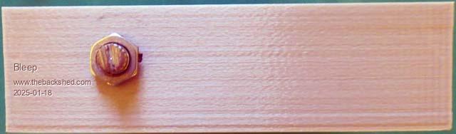

Here is the finished box, for Peters reference design, complete with battery power, also now a volume control.

I'm really pleased with the I2S audio now supported on the RP2350. Full 16-bit audio (or greater, tested with 96KHz 24-bit flac) from a proper DAC AND the load on the CPU is actually less than PWM, SPI, or VS1053
Accordingly I've created a variant of the reference design with the PCM5102A DAC integrated on the board. The footprint etc is identical.
Schematic

If you move the USB connectors and the SD card slot a little, you can move the Pico2 to the front edge of the board, which eliminates the need for an additional connector for programming.
stanleyella
Joined: 25/06/2022
Posts: 2807
Posted: 08:18pm 22 Jan 2025
Bleep, I use a similar car reversing monitor, same base, buttons, hdmi, vga, avi , no sound.
it's cool and works with hires modes no prob. it was cheap a year ago
Posts: 12174
Posted: 10:54pm 22 Jan 2025
  Quote  If you move the USB connectors and the SD card slot a little, you can move the Pico2 to the front edge of the board, which eliminates the need for an additional connector for programming.
There isn't room because of the mounting holes and in any case it would increase the length of the HDMI lines. I do think about these things......
