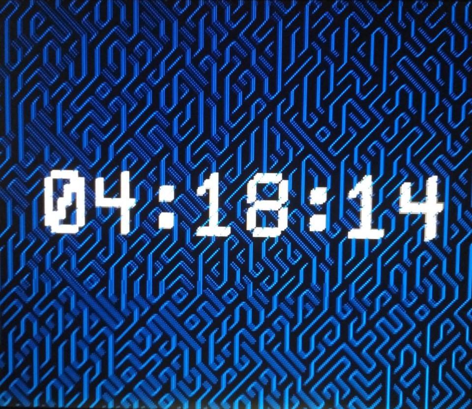

Diagonal Scrolling Clock
Const Mode.N=2
Const Font.N=1
Const T.Scale=4
Const T.Size=Len(Time$)
MODE  Mode.N
Const X.Res=MM.HRES,Y.Res=MM.VRES
Font  Font.N
Const X.FSize=MM.Info(FONTWIDTH)
Const Y.FSize=MM.Info(FONTHEIGHT)
Const X.Offset=X.FSize*T.Scale*T.Size\2
Const Y.Offset=Y.FSize*T.Scale\2
Dim integer X.Dir=1,Y.Dir=1
Dim integer X.Pos=MM.HRES\2,Y.Pos=MM.VRES\2
Dim integer FC,BC
Dim Clr(15)=(0,1,2,3,4,5,6,7,8,9,10,11,12,13,14,15)
Colour Map Clr(),Clr()
FRAMEBUFFER LAYER 0
FRAMEBUFFER WRITE L
Font 9
If BC=0 Then
 BC=Int(Rnd*15)+1
 Colour Clr(BC)
 Print @(0,0);
 For n=1 To (X.Res\8)*(Y.Res\8)
   Print Chr$(32+Int(Rnd*3));
 Next
EndIf
If X.Dir=1 Then
 Blit READ  1, 0,0,1,MM.VRES
 Blit 1,0,0,0,MM.HRES-1,MM.VRES
 Blit Write 1, MM.HRES-1,0
Else
 Blit READ  1, MM.HRES-1,0,1,MM.VRES
 Blit 0,0,1,0,MM.HRES-1,MM.VRES
 Blit Write 1, 0,0
EndIf
Blit Close 1
If Y.Dir=1 Then
 Blit READ  1, 0,0,MM.HRES,1
 Blit 0,1,0,0,MM.HRES,MM.VRES-1
 Blit Write 1, 0,MM.VRES-1
Else
 Blit READ  1, 0,MM.VRES-1,MM.HRES,1
 Blit 0,0,0,1,MM.HRES,MM.VRES-1
 Blit Write 1, 0,0
EndIf
Blit Close 1
Pause 20
FRAMEBUFFER WRITE N
If FC=0 Then FC=Int(Rnd*15)+1
Text X.Pos,Y.Pos,Time$,"CM",Font.N,T.Scale,Clr(FC)
Inc X.Pos,X.Dir:Inc Y.Pos,Y.Dir
If X.Pos-X.Offset<0 Then X.Dir=1:FC=0
If X.Pos+X.Offset>MM.HRES Then X.Dir=-1:FC=0
If Y.Pos-Y.Offset<0 Then Y.Dir=1:BC=0
If Y.Pos+Y.Offset>MM.VRES Then Y.Dir=-1:BC=0
FRAMEBUFFER WRITE L
Loop While Inkey$=""
DefineFont 9
04200808
80402010 08040201
01020408 10204080
08080808 08080808
End DefineFont

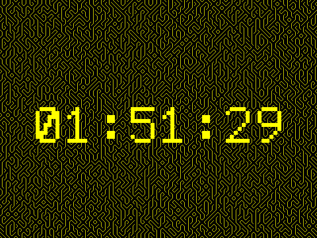

Maze-Clock
MODE  1
Const Font.Addr=MM.Info(FONT ADDRESS 1)+4
Dim string  CH$ LENGTH 1
Dim string  ST$ LENGTH 8
Dim integer X.Pos=5,Y.Pos=15
Dim integer n,FC,BC
Dim CM(15)=(0,1,2,3,4,5,6,7,8,9,10,11,12,13,14,15)
Colour Map CM(),CM()
Font 9
Print @(0,0);
 Print Chr$(50+Int(Rnd*3));
Next
If FC=0 Then
  FC=Int(Rnd*15)+1
  TILE 0,0,CM(FC),0,80,40
  If Cint(Rnd) Then CH$="1" Else CH$="0"
EndIf
ST$=Time$
PrintTime X.Pos,Y.Pos,ST$,CH$
Pause 250
PrintTime X.Pos,Y.Pos,ST$,"C"
Inc X.Pos,X.Dir
Inc Y.Pos,Y.Dir
If X.Pos<0 Then X.Dir=1:FC=0
If X.Pos+64>80 Then X.Dir=-1:FC=0
If Y.Pos<0 Then Y.Dir=1:FC=0
If Y.Pos+11>60 Then Y.Dir=-1:FC=0
End

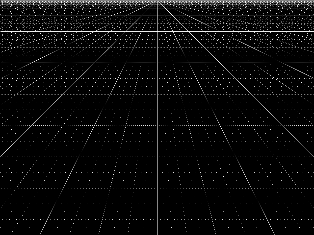

Perspective, Prospettiva, Perspicere
MODE 1
For Y=1 To 480
 For X=1 To 640
   Z=X-320
   If (Z*64)Mod Y=0 Then Pixel X,Y
 Next
Next
javavi
Joined: 01/10/2023
Location: Ukraine
Posts: 636
Posted: 06:40pm 20 Apr 2025
MODE 1
XR=MM.HRES-1:YR=MM.VRES-1
For Y=1 To YR
 For X=1 To XR
   Z=X-320
   If (Z*64)Mod Y=0 Then Pixel X,YR
 Next
 Sprite scroll 0,1
Next

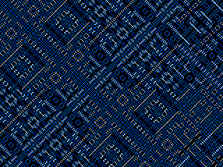

XOR Patterns
MODE 2
R1=Int(Rnd*10)+1
R2=Int(Rnd*10)+10
R3=Int(Rnd*10)+20
C1=Map(Int(Rnd*15)+1)
C2=Map(Int(Rnd*15)+1)
C3=Map(Int(Rnd*15)+1)
For Y=0 To 240
For X=0 To 320
Color 0: Pixel X,Y
K=X Xor Y
If K Mod R1=0 Then Color C1: Pixel X,Y
If K Mod R2=0 Then Color C2: Pixel X,Y
If K Mod R3=0 Then Color C3: Pixel X,Y
Next
Next
Loop

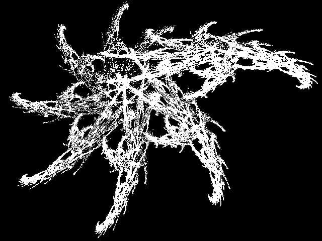

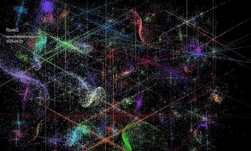

Evil Fractal
CLS
 If Cint(Rnd) Then
   T=(X+Y)/2
   Y=(Y-X)/1.333
   X=T
 Else
   T=(X+Y+1)/2
   Y=(Y-X+1)/4
   X=T
 EndIf
 Pixel 240+X*350,170-Y*290

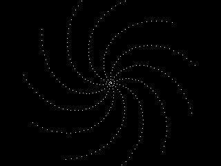

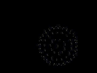

Whirlwind
X0=MM.HRES\2: Y0=MM.VRES\2
 X=MM.HRES/800:Y=0
 Inc I,.1: If i=360 Then i=1
 C=Cos(i): S=Sin(i)
 CLS
 For R=1 To 320
   Pixel X0+R*X,Y0+R*Y
   T=X*C-Y*S
   Y=X*S+Y*C
   X=T
 Next
 Pause 50
Inc I,.001: If i=360 Then i=.001
C=Cos(i): S=Sin(i)
X=MM.HRES/800: Y=0
CLS
For R=1 To 320
  Pixel X0+R*X,Y0+R*Y
  T=X*C-Y*S
  Y=X*S+Y*C
  X=T
Next
Pause 30

RotaSphere
MODE 2
Dim Xa(255), Ya(255)
x0=MM.HRES\2:y0=MM.VRES\2
Xdir=1:Ydir=1:C=Map(14)
n=4
r=n*16
 i=0
 t=Timer
 tr=t-n*50
 ra=tr/1234
 rb=tr/2345
 For a=0 To Pi Step .39268
   For b=0 To Pi*2 Step .8-.6*Sin(a)
     o=Sin(a)*Cos(b)
     k=Sin(a)*Sin(b)
     e=Cos(a)*Cos(ra)+k*Sin(ra)
     Pixel Xa(i),Ya(i),0
     Xa(i)=(o*Cos(rb)+e*Sin(rb))*r+x0
     Ya(i)=(e*Cos(rb)-o*Sin(rb))*r+y0
     Pixel Xa(i),Ya(i),C
     Inc i
   Next b
 Next a
 If x0<r Then Xdir=1:C=Map(Int(Rnd*16))
 If y0<r Then Ydir=1:C=Map(Int(Rnd*16))
 If x0>MM.HRES-r Then Xdir=-1:C=Map(Int(Rnd*16))
 If y0>MM.VRES-r Then Ydir=-1:C=Map(Int(Rnd*16))
 Inc x0,Xdir:Inc y0,Ydir
Amnesie

RonnS
Joined: 16/07/2015
Posts: 123
Posted: 04:37am 23 Jun 2025
  javavi said
  lizby said  Beautiful. Amazing what 30 lines of code can do. Thanks for working these out, and hope more is to come.
To run with ILI9341 LCD, I commented out the TILEs line, changed the sizing
On such screens, "The Mystery of Deep Space" can be viewed in color ;))
MODE 2
CLS
For G=-Rnd*42 To 400
tt=Rnd*99:  qq=Rnd*99
uu=Rnd*320: vv=Rnd*240
A=Rnd*3
R=90/(1+Rnd*100)
Q=1+3*(.5+Rnd/2)
aa=1+3*Rnd^2: M=1
If Rnd*9<4 Then Q=R:T=0:qq=0:A=0:M=Pi/3:aa=1
C=(1+3*Rnd^2)*R*R
Color Rnd*&hFFFFFF
For i=0 To C
  S=-Log(Rnd):  T=i*M
  U=S*R*Sin(T): V=S*Q*Cos(T)
  T=S*A
  X=U*Cos(T)+V*Sin(T)
  Y=V*Cos(T)-U*Sin(T)
  D=(X*X+Y*Y)/(R*R+Q*Q)
  Z=99*((2.7^-D)+.1)
  Z=Z*(Rnd-.5)^3
  y0=Y*Cos(tt)+Z*Sin(tt)
  Z=Z*Cos(tt)-Y*Sin(tt)
  x0=uu+X*Cos(qq)+y0*Sin(qq)
  y0=vv-X*Sin(qq)+y0*Cos(qq)
  Pixel x0,y0
Next
Next
Loop
Hello Javavi, I find your code so beautiful and have translated it into another basic language - do I have your permission to also publish the result on another site (with acknowledgment of the author)?
see pic
run  at  a  800x600 display
