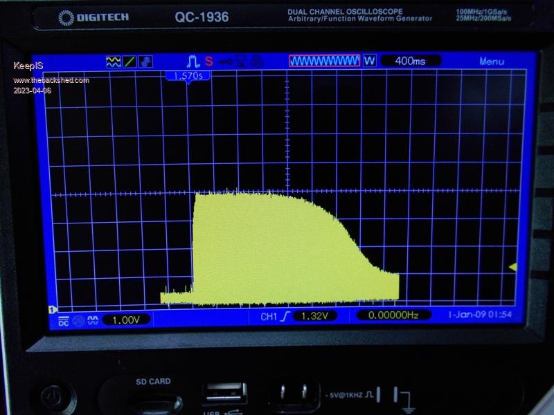

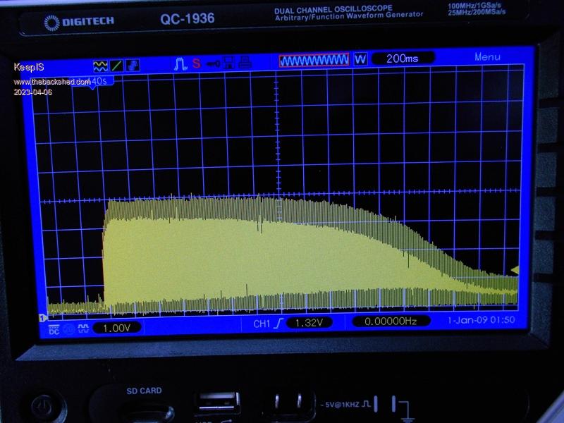

These are the DSO captures from Powering up the 3HP Dust Extractor:
DSO 1V per division = 125A per division from the DC Current Clamp.
Below: The current at almost 500A and the startup duration of 2.2 seconds before the current drops below 375A. That's around 500A * 47V = 23.5kW which cannot be correct, 12kW I can believe.
Below: Compressed startup waveform to give a idea of the surge current duration and shape.

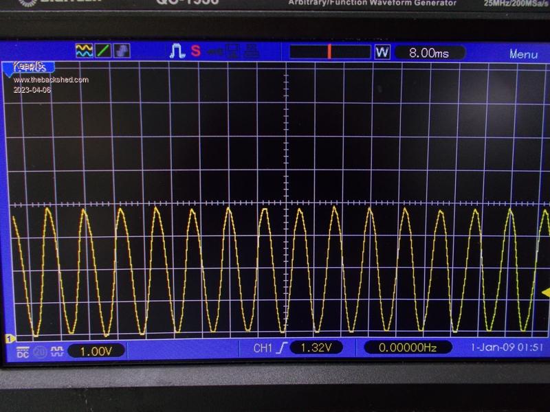

Below: The AC current flowing through the 0 gauge cable.

You know, thinking about only the peak current, the Current Clamp is showing a transition from around 7A load to 500A peaks through the cable.
If I were calculating average power and current input then I would be using standard AC calculations.
But to me it really does look like the peak current is reaching 500A DC from the batteries, considering the Voltage at the inverter input has dropped from 56V to 46.7V on those peaks. I capture the highest instantaneous current and lowest voltage for Transient peak readings. Even true short term 200A current draw only drops the voltage to 51V.
That's from 25kW of LiFePO4 batteries with a constant discharge current rating of over 300A and a short peak capacity of around 700A through 1M 0 Gauge + - cable.

The last photo is worded incorrectly. It should read: Shows the Current waveform flowing through the 0 Gauge cable.

Mike, I have not really been following what you are doing and I might be confused but maybe I can try to add some clarity ? (or confusion)
The last picture shows a peak about every division and a bit. The time scale indicates 8mS per division (a strange number what happened to 5 or 10.....). So it appears that there is a positive peak ~ every 10mS. This is what I would expect as the current ramps from close to zero to maximum every 10mS. It starts from zero, drives to a positive peak over 10mS & returns to zero and then drives to a negative peak over the next 10mSecs and returns to zero.
The current ripple should be at a 100Hz or 10mS rate.  Now to work out the true power, if you draw a line at approximately half the peak amplitude and fold it down then we have filled in the power envelope considerably so it now looks like inverted 100Hz ripple, Now if you multiply that result by 0.7071 that is how to convert the ripple peak to RMS.
So if we are seeing 500A peaks I would average that at 250A and then multiply it by 0.7071 resulting in 176 amps RMS, lets multiply that by 48V and the result is ~ 8,500W.
What I dont get is that surely you know this and I'm missing something as you would need to know all this to calculate the inverter efficiency at ~ 92% ? I assume you have an RMS AC amp clamp meter that will confirm the secondary power and > 90% sounds like the right ball park figure else there would be a lot of heat generated somewhere.  I do agree that the power peaks are ~ 24kW but the RMS is still around the 8.5kW mark?
I dont know if this helps or maybe you can confirm what you are trying to work out ?

Hi Mike, thanks for popping in, yes I mentioned calculating the power a few posts back.
The thing I'm trying to confirm is only the instantaneous peak current that would flow into the Inverter.
To me the current peak during startup of some of these big induction motors appears to be very high at 500 to 563A, higher than I had originally thought, due to averaging and my early Current Clamp limitations.
I needed to put this in a post as it gives me some clarity of sorts to think it through.
If the brief instantaneous Peak current really is 563A, and I confirmed that the Current clamp is accurate, then it's truly mind boggling to me that the FETS can take that abuse. Especially as at a slightly lower current those peaks continue for 2.2 seconds before dropping down to the Machine running current.
Edited 2023-04-06 20:14 by KeepIS

KeepIS
Joined: 13/10/2014
Posts: 2287
Posted: 11:51pm 06 Apr 2023
Are you sure the peak discharge current of over 1270A is correct?
If it is, then at 48v that's over 60kW peak discharge.
pd--
Joined: 11/12/2020
Posts: 122
Posted: 02:54am 07 Apr 2023
Im not shore I did not build it . its a commercial current shunt with inbuilt electronics .
i have a multimeter with a recording function , i could connect it across a shunt and i may get lucky but its shortest record interval is one second
Other than that i would need to build sumthing or get a DSO witch would be handy for other projects my analog scope is getting on a bit.
KeepIS
Joined: 13/10/2014
Posts: 2287
Posted: 03:47am 07 Apr 2023
The problem with high power resistive current shunts is the very low voltage produced for the Current through them, commonly anywhere from 10mv to 75mv per 200A, so trying to read that with a multimeter is virtually impossible due to the massive transient currents and inverter noise on the shunt and power cable, 100mv to 500mv or more will swamp anything you try to read. They can work with balanced filtering but take more effort then it's worth IMHO, especially since a good isolated Current clamp is under $30 and can read to over 700A depending on which one you choose.
A DSO of some type will still be needed with an isolated Current Clamp if you want to to catch peak transients, but a multimeter is fine for everything else, a unit like the one I posted a link to earlier, it's low cost and very low noise.
