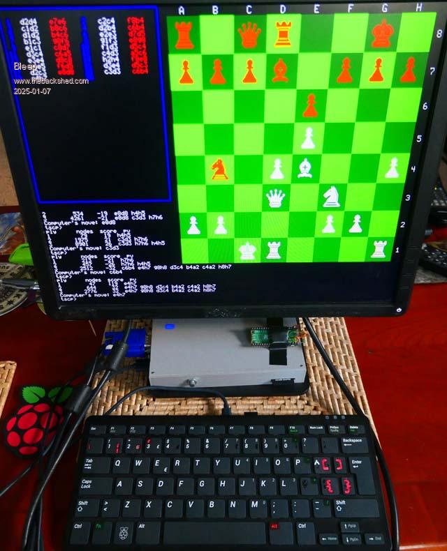

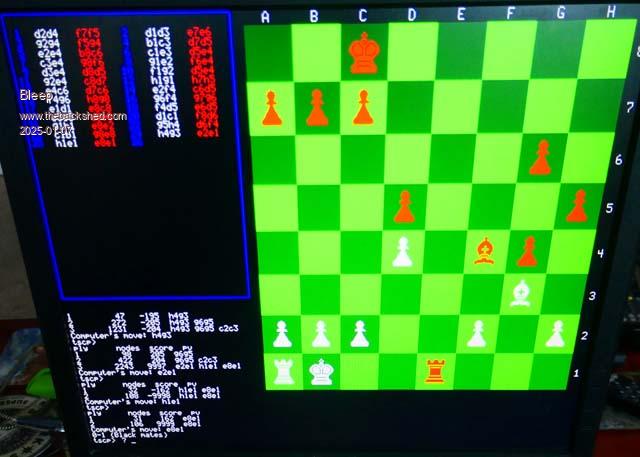

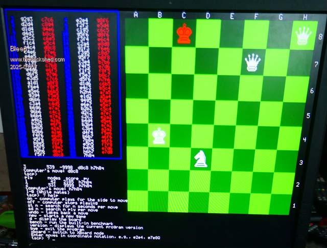

Hi Harm,

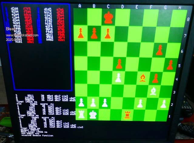

Attached are my efforts, I think it is all working, there is a problem with the 'bench' tscp chashes with "*** PANIC ***" "missing double function" so I have disabled that command.
Otherwise I have tried to keep is roughly the same as yours, in look and layout.
my file is called "chesskm.bas" and should be a drop in replacement for your V09, except for the Com port pins, which I'm sure you can work out. ;-)
2024-11-14_222213_chess2pico_v09.zip
Regards, Kevin.

I've tested bench on both rp2040 and rp2350 (genuine PICOs) and it works fine. The error you see will only arise on RP2040 with the very oldest b0 stepping. These chips are superseded so any boards that exhibit this are probably best for the bin
#if !(PICO_DOUBLE_SUPPORT_ROM_V1 && PICO_RP2040_B0_SUPPORTED)
static __attribute__((noreturn)) void missing_double_func_shim(void) {
   panic("missing double function");
#endif
I attach the latest binaries in case you are using an old version
Chess.zip

Yes I suspect that my Pico is positively Neolithic, I'm a bit of a Ludite, I don't like throwing away perfecly functional stuff, though if I was a Ludite, I'd still be using an Abacus and typewriter! I did't realise there were any hardware changes to the 2040, which would produce such an error?
Thanks for the updated binaries, I was using the latest already, I'll just refrain from using the bench command, which I have re-instated in the client, below.
