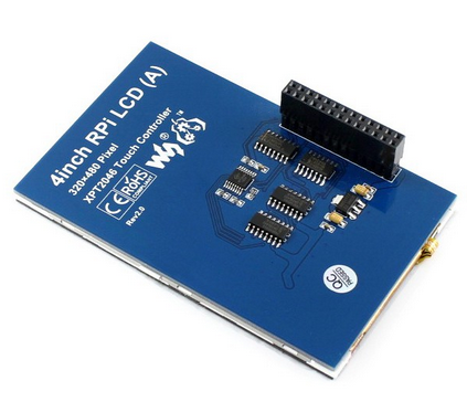

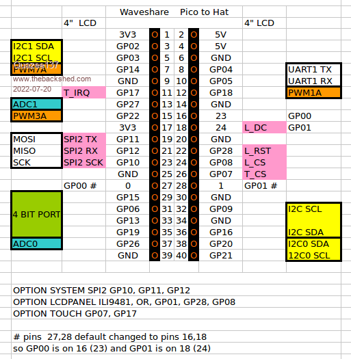

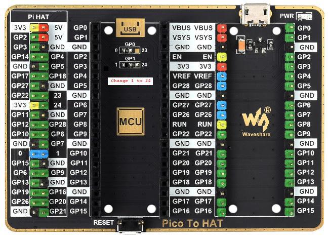

I have been using the ILI9481 Raspberry Pi display on my MM170 hatstands and now
switching over to pico.
Here is a few pic's
I have Peters Clock program running on it.
