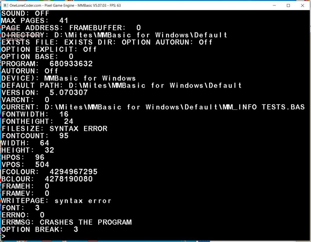

Tested a7 for MM.INFO.
-MM.INFO(FILESIZE) gives syntax error
-MM.INFO(WRITEPAGE) gives syntax error
-MM.INFO(ERRMSG) crashes the program. Initially it was Ok, but now several restarts and crashes. In fact crashes every time now.
Simple testprogram. I had to comment out the lines that gave errors in order to complete the tests.

Sorry forgot the outputs:

Posted: 10:32pm 22 Feb 2022
Perhaps try specifying a filename or directory name in the function?
  Quote  MM.INFO(ERRMSG)
Shouldn't crash of course but calling it before there is an error makes no sense

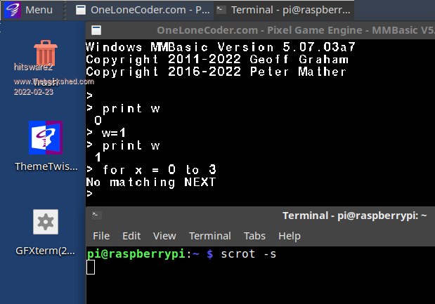

Posted: 01:45am 23 Feb 2022
*********** W O R K S  O N  R A S P B E R R Y  P I **************
Box86 / Wine  ( FOR without NEXT problem though )
my site

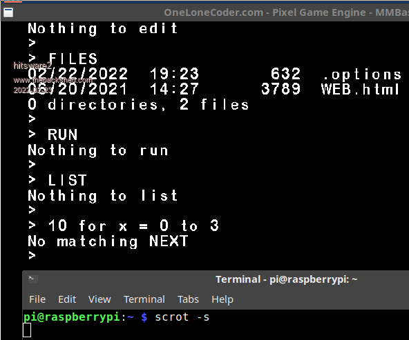

Posted: 01:50am 23 Feb 2022
  hitsware2 said  FOR without NEXT problem though
for x = 1 to 3: ?x: next

Posted: 02:30am 23 Feb 2022
  hitsware2 said  A new paradigm  ?
Not sure what you're saying. The error you get with FOR on the command line and no NEXT is the same for MMBasic on any device.

Posted: 03:27am 23 Feb 2022
Edit now requires a file name.
Because numbered and un-numbered lines are both allowed, reliably positioning any new line requires either the editor or perfectly sequential entry of the whole shebang while some option to autosave is turned on, I forget exactly how.
Your line 10 was immediately executed and not saved. Which is why you never got the chance to follow up with a line 20 and maybe NEXT x.
