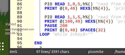

In MMEDIT V5 (the latest version downloaded this morning) Linux version, running Ubuntu 20.04, just updated Ubuntu, I can scroll down the the text in the editor screen, but I cannot scroll up again (using the mouse scroll wheel).
You see that the editor tries to scroll up (1 or 2 lines) and then scrolls down 1 or 2 lines again, resulting in not scrolling at all.
Tried this with maximized window, and with windowed window.
Maybe related, the scroll bar at the right hand side of the window does not seem to be matching the length of the text in relations to the lenth of the visible window. A 300 lines program could have a scroll bar the is 2/3 the height of the text window (that should be 20% or so).
2/
Another observation is that the last line of text is partially invisible (outside the bottom window edge)

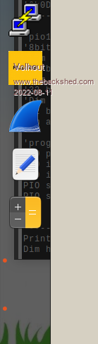

The icons do not default show up in ubuntu 20.04 when opening the program (both MMEDIT and MMCC). Just empty fields (the red dot represents the fact that the program is opened). Maybe that is something I have to manually add (the link between icon and executable?).
Not sure if this makes any sense to you,
